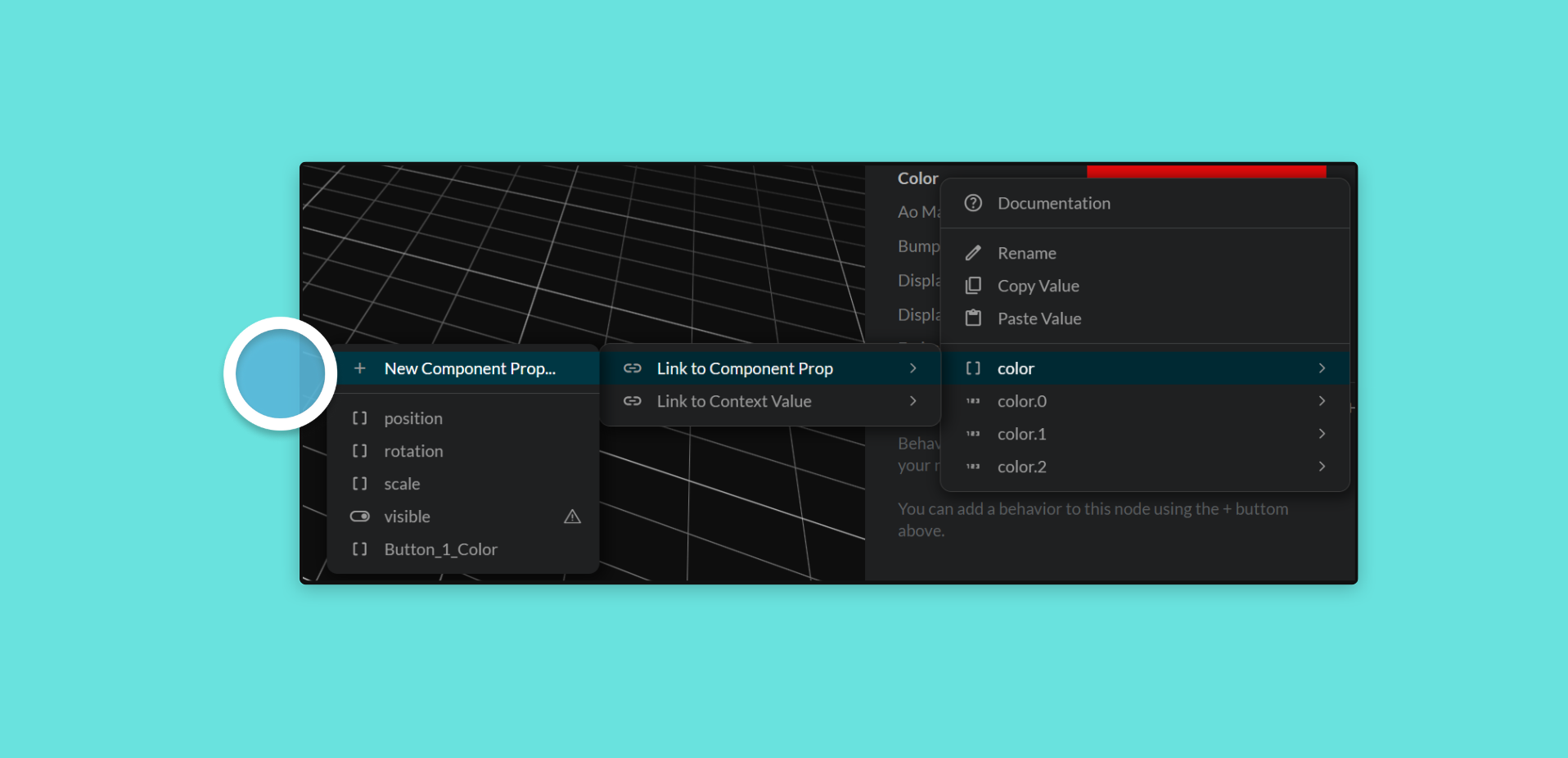

Section titled “Linking Component Props”To link a property available in the node properties panel:
- Click on a node in your zcomponent
- Navigate to the property you want to link (e.g., the color of the material)
- Right-click on the property you want to link
- Click on Link to Component Prop and then New Component Prop…

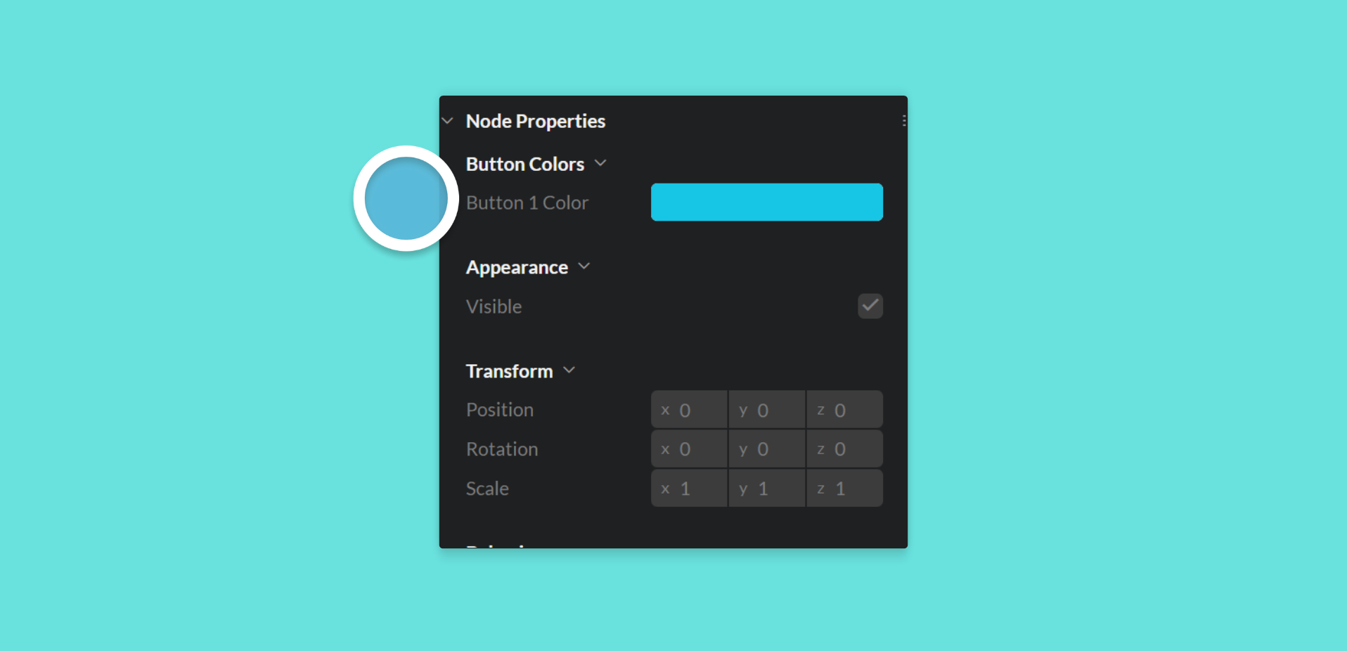

Using Linked Properties
Section titled “Using Linked Properties”Linked component properties will appear in the node properties of your zcomponent when added to the Hierarchy of another zcomponent or Scene.
Updating these values will update the instance of the zcomponent, not the actual zcomponent itself.

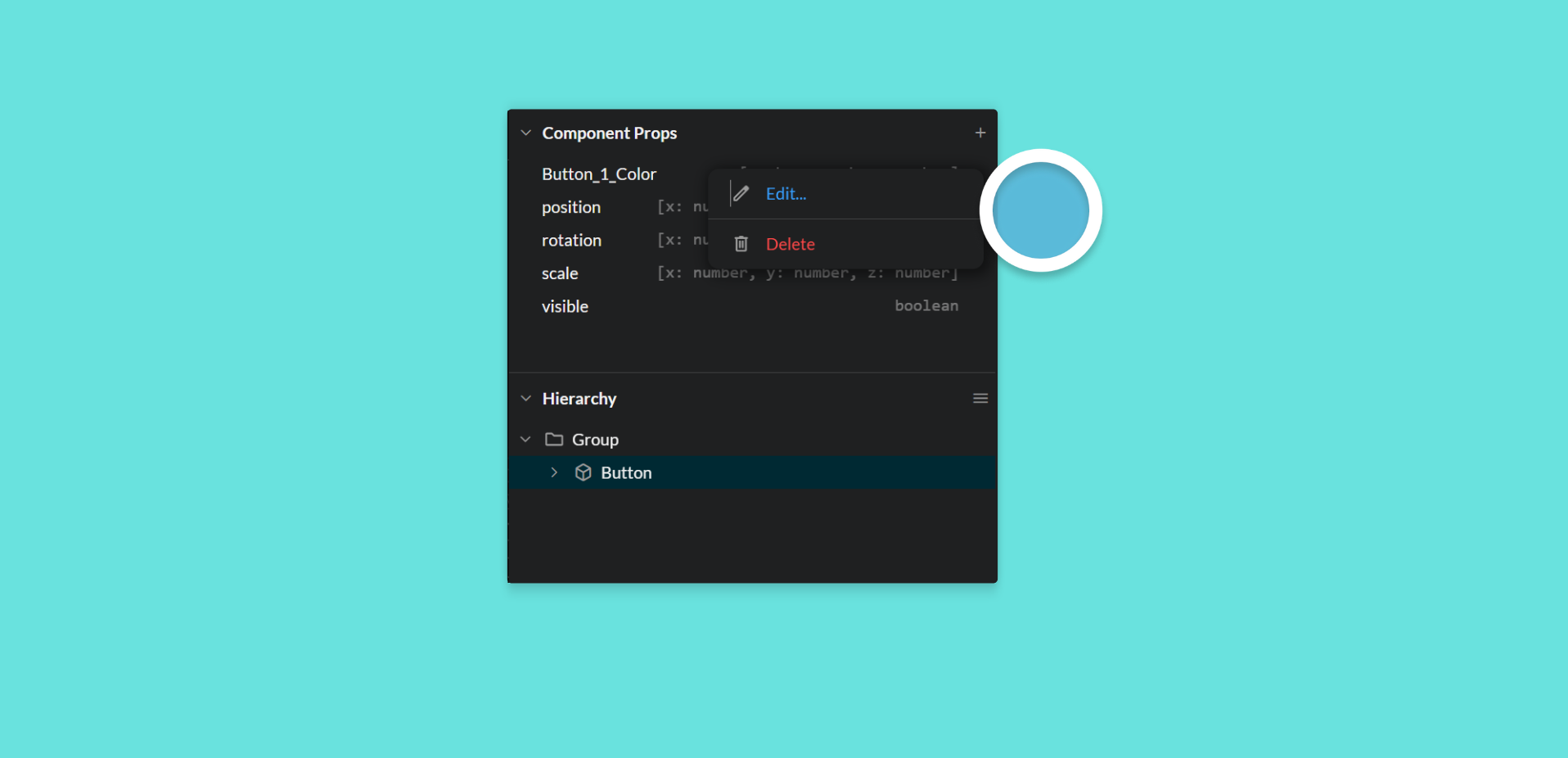

Managing Component Props
Section titled “Managing Component Props”Linked component props can be managed (deleted or edited) from the “Component Props” panel above the Hierarchy.
