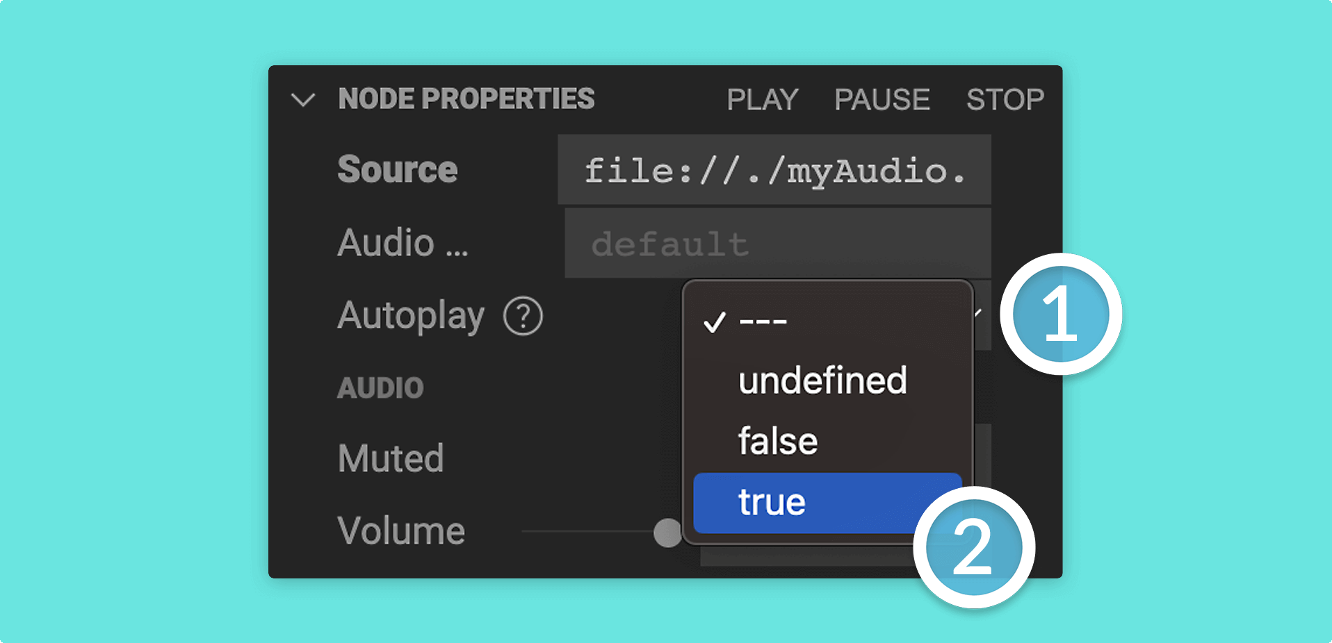

Autoplay
Enable the Autoplay option in the properties to automatically start the audio when your zcomp is loaded:

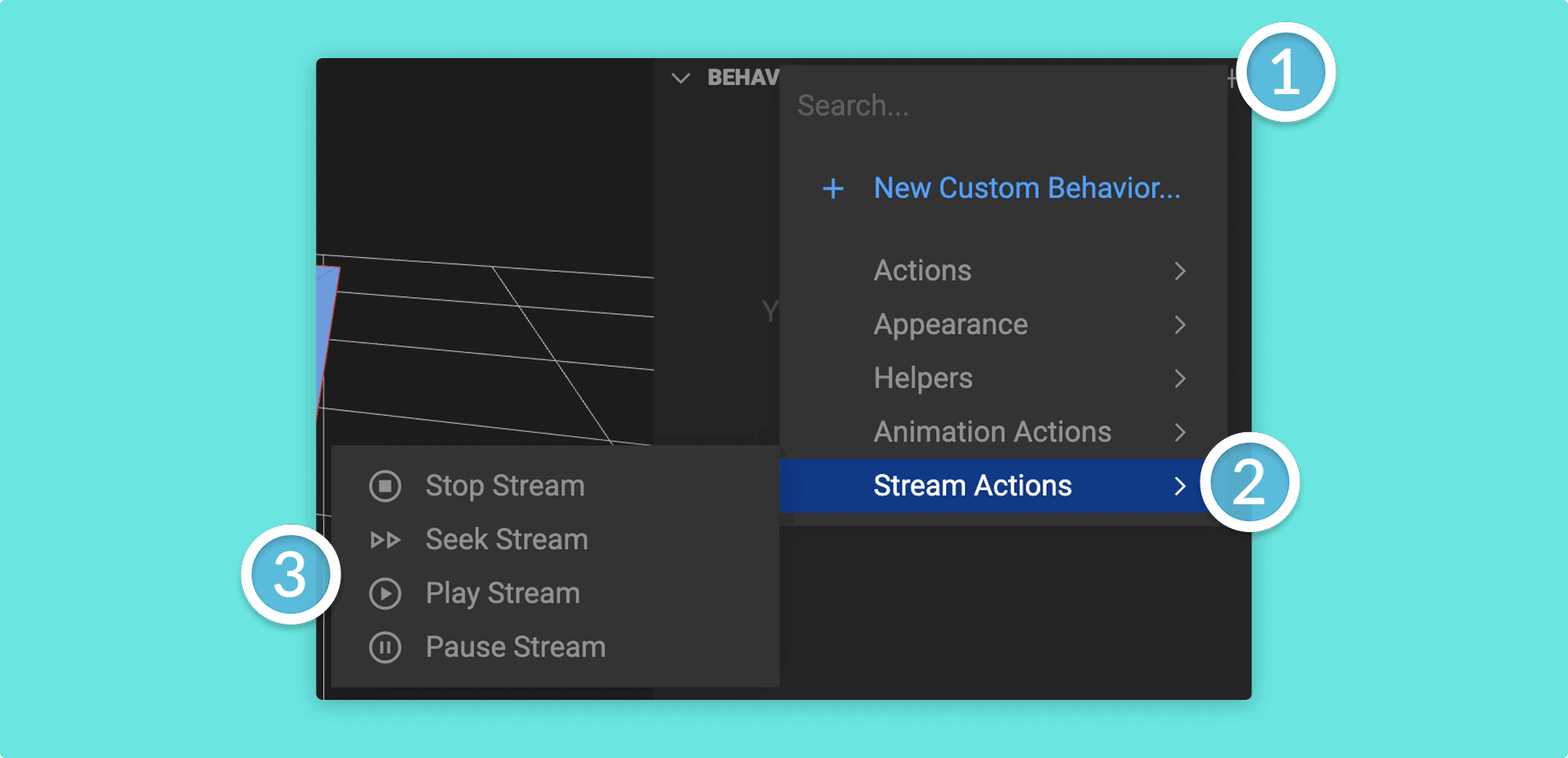

Stream Action
Use a stream track action to trigger audio playback via an event:
Select the node in the Hierarchy that you want the event to fire on, choose Stream Actions, and use the desired action (e.g., Play Stream).
