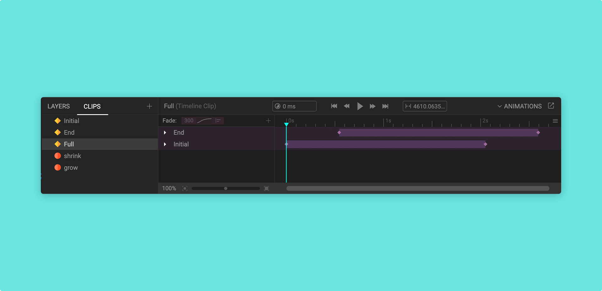

Clips are States or Timelines, used for creating transition animations.
Adding clips
Section titled “Adding clips”There are two main types of clips, they are called States and Timelines:
| Clip type | Description |
| States | A stored set of properties that can be activated and transitioned to. |
| Timelines | Allows for the creation of more complex, custom transition animations. |
To learn how to create state and timeline clips, click on the relevant articles in the above table.

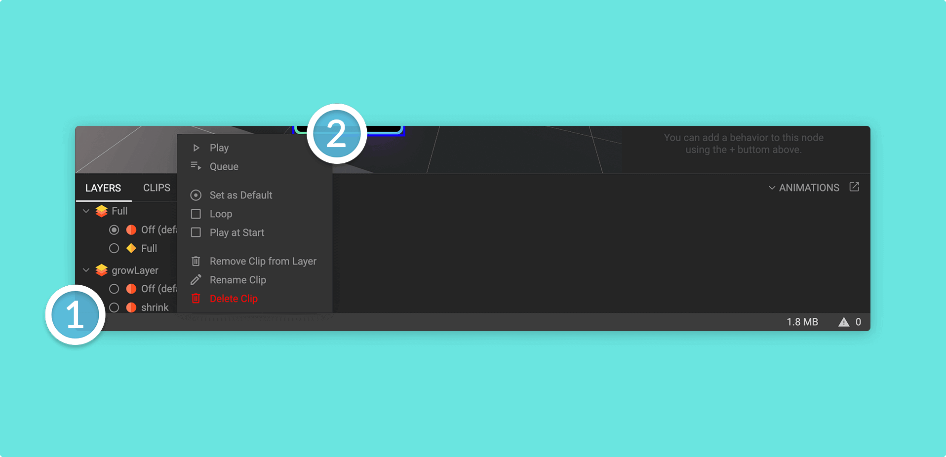

There are additional clip options you can find by right-clicking on it:
| Animation parameter | Description |
| Play | Plays (or activates) any clip inside a layer, including states and timelines. Will play from whatever Time is currently set to. |
| Queue | Queue clips to be played in succession of each other. |
| Set as Default | Set the default clip for a layer. This clip will play when your Mattercraft project is launched. If this option is not available, the chosen clip is already the default. |
| Loop | Loop the chosen clip so that it automatically plays from the start when it has ended. |
| Play at Start | Plays (or activates) any clip inside a layer from the start. |
| Remove Clip from Layer | Remove a clip from a layer but allow it to remain in the project as an independent clip. |
| Rename Clip | Rename a clip to something new. |
| Delete Clip | Remove a clip from a Mattercraft project entirely. |
