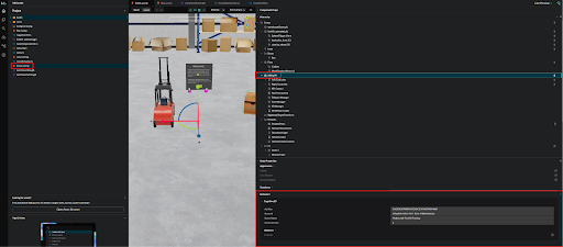

Cognitive3D distinguishes between static scene geometry and dynamic objects — objects that move, or objects whose heatmap data you want to capture. Dynamic objects are marked by attaching a Cognitive3DDynamicObject behavior to them.
Where you attach the behavior depends on whether the object is a zcomponent or not. You can identify a zcomponent by the lightning bolt icon next to it in the Hierarchy.
For zcomponents (objects with the lightning bolt icon), open the zcomponent definition in the Project window and attach the Cognitive3DDynamicObject behavior to the object inside it — not to the zcomponent instance in the scene hierarchy. Enter a matching C3D Mesh Name (e.g. WarehouseBox).
For standard scene objects (no lightning bolt), attach the Cognitive3DDynamicObject behavior directly to the object in the scene hierarchy. Enter a matching C3D Mesh Name (e.g. Forklift).

  1. Right-click in the Hierarchy and select New > AttachmentPoint
  2. Inside the AttachmentPoint node, set the child object’s name to the component you want to track (e.g. hydraulics_front_13)
  3. Attach a Cognitive3DDynamicObject behavior to this AttachmentPoint
