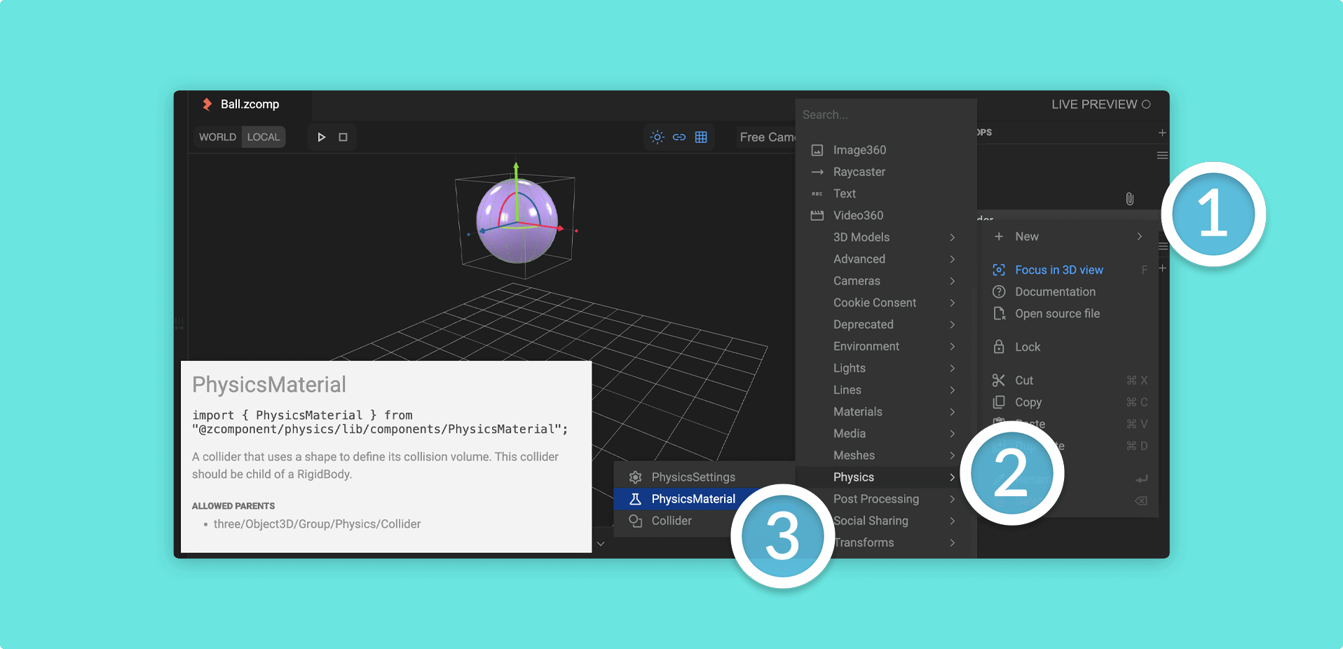

Adding a Physics Material
Section titled “Adding a Physics Material”Adding a Physics Material to a Collider in Mattercraft is straightforward. To add a Physics Material, right click on your Collider in the Hierarchy and add a New → Physics → Physics Material.
