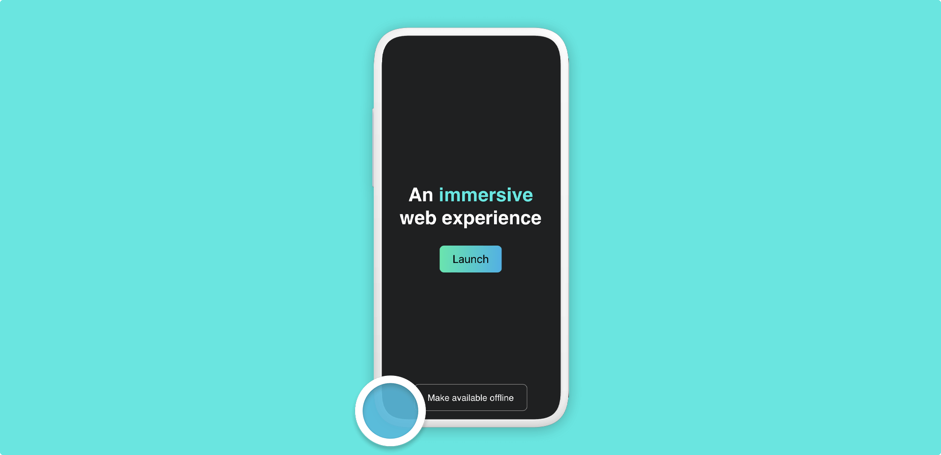

End User Experience
Section titled “End User Experience”When an end user first visits an experience that has Offline Mode enabled, the browser will proactively download and cache the project’s files and assets. An on-screen user interface is shown to notify the user of the progress and completion of this process.
One the download is complete, that page can be accessed by the user later, even if they don’t have a network connection on their device, or if their connection is slow.
If the user subsequently visits the experience after an update has been published, that update will be downloaded and the user will be prompted to reload the page to access the latest version.

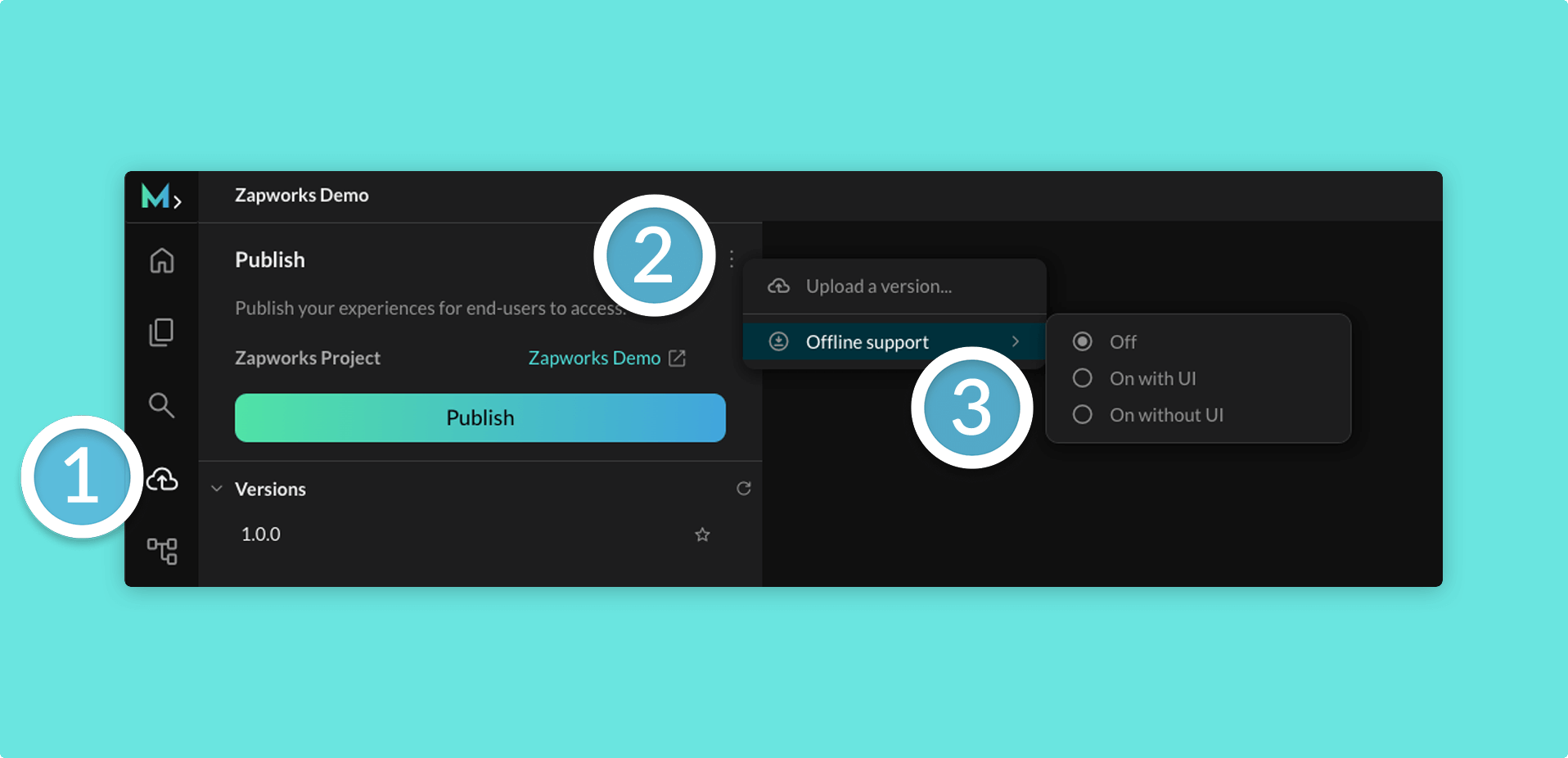

Enabling Offline Mode
Section titled “Enabling Offline Mode”Offline Mode can be enabled from the Publish tab’s menu:
There are three settings for Offline Mode:
| Setting | Description |
| Off | No attempt is made to make the experience available offline. This is the default setting. |
| On with UI | When users visit the page, the experience will attempt to download the necessary files and assets for offline access. A simple on-screen user interface will be shown to the user, both to indicate the status of the download and when there is an update to the site that requires a reload of the page. |
| On without UI | Support for Offline Mode is provided by Mattercraft, but no default user interface will be shown to the user to indicate status. With this option, we highly suggest adding custom UI of your own. |
There are a few important considerations when using Offline Mode:
- Only assets stored in your project in Mattercraft and referenced from your scenes or script files will be downloaded.
- Mattercraft uses a standard browser feature called ‘Service Workers’ to provide this functionality. Most modern browsers support Service Workers, but how long the downloaded cache of a site is stored varies by browser and device.
- Offline support applies only to the published version of your project and thus it does not affect Live Preview.

Without any options set, the tag shows a button for the user to click or tap to make the site available offline, then it shows status messages throughout the download process.
