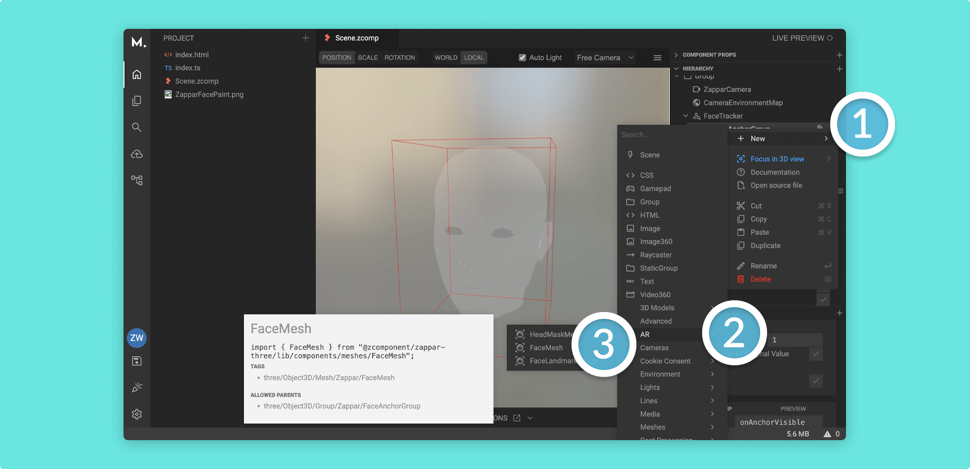

Adding a face mesh
Section titled “Adding a face mesh”To add a face mesh, first make sure that there is a Face Tracker and a Face Anchor Group in your Hierarchy.
Then, you may use the following instructions:
- Right click on the
FaceAnchorGroupand hover overNew - Find the
ARcomponent category and select theFaceMeshcomponent
