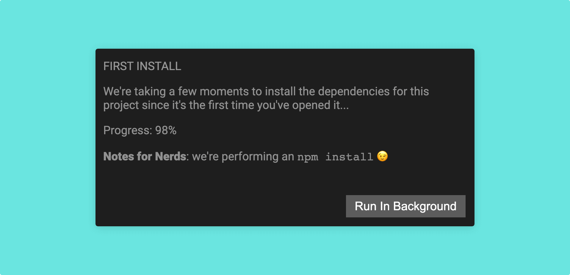

When you select a Blank Project, or a Project Template, a dialog will appear to install the required dependencies for your project.
‘Dependencies’ are the files your project needs to function.
Once the installation is complete, the 3D viewport and Mattercraft menu items will become available.
For web developers: when Mattercraft opens a project, it is running the npm install command. You may install your own dependencies in a Mattercraft project at any time.
