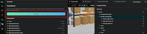

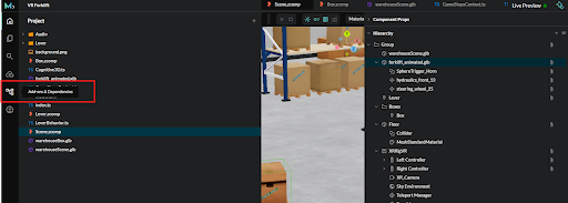

  1. Open the Dependencies Browser by clicking Add-ons and Dependencies in the project editor
  2. Click Browse and ensure you are in the Recommended tab
  3. Find the @cognitive3d/zappar-three package and click on it to open the information dialog
  4. Click the Install button to instantly install it to your project
If you can’t find the package in the Recommended tab, switch to the From NPM tab and search for @cognitive3d/zappar-three.

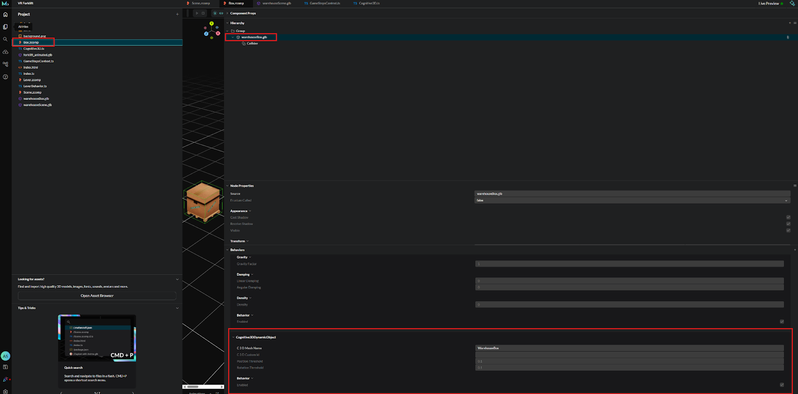

Cognitive3D distinguishes between static scene geometry and dynamic objects — objects that move, or objects whose heatmap data you want to capture. Dynamic objects are marked by attaching a Cognitive3DDynamicObject behavior to them.

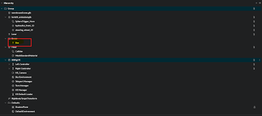

Where you attach the behavior depends on whether the object is a zcomponent or not. You can identify a zcomponent by the lightning bolt icon next to it in the Hierarchy.
For zcomponents (objects with the lightning bolt icon), open the zcomponent definition in the Project window and attach the Cognitive3DDynamicObject behavior to the object inside it — not to the zcomponent instance in the scene hierarchy. Enter a matching C3D Mesh Name (e.g. WarehouseBox).

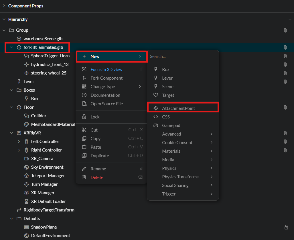

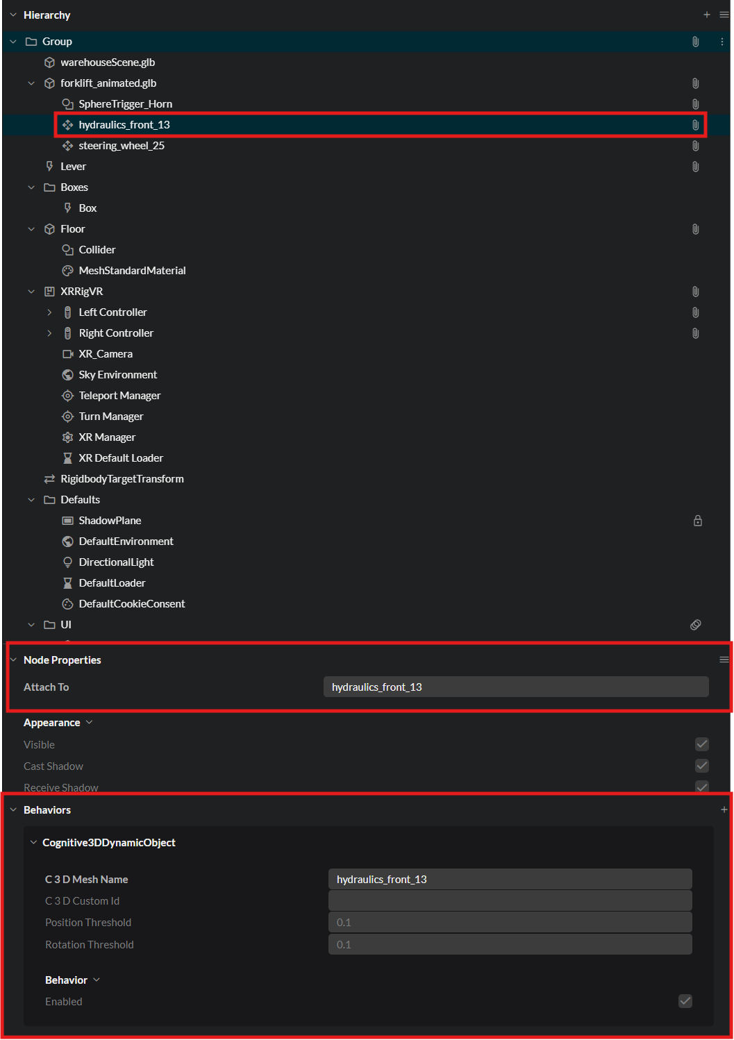

Dynamic objects on attachment points (children of GLB files)
Section titled “Dynamic objects on attachment points (children of GLB files)”
Cognitive3D does not support animations, but you can still track the transforms of individual components within an animated object (e.g. a moving part on a forklift).
  1. Right-click in the Hierarchy and select New > AttachmentPoint
  2. Inside the AttachmentPoint node, set the child object’s name to the component you want to track (e.g. hydraulics_front_13)
  3. Attach a Cognitive3DDynamicObject behavior to this AttachmentPoint
For standard scene objects (no lightning bolt), attach the Cognitive3DDynamicObject behavior directly to the object in the scene hierarchy. Enter a matching C3D Mesh Name (e.g. Forklift).
Each Cognitive3DDynamicObject behavior has the following properties:
Property Description
C3DMeshName Must match the mesh name uploaded to the Cognitive3D dashboard. This tells Cognitive3D which mesh the object represents.
C3DCustomID A unique identifier for this object instance. Leave blank to auto-generate, or set manually (e.g. 1, 2, 3 for multiple objects sharing the same mesh).
Position Threshold Minimum position change (in units) before a snapshot is sent. Default: 0.1
Rotation Threshold Minimum rotation change (in degrees) before a snapshot is sent. Default: 0.1

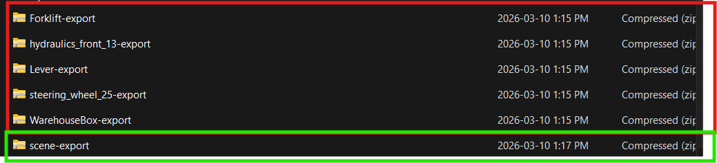

Once all dynamic objects are marked, export your scene data using Live Preview:
  1. On the Cognitive3D Manager in the Hierarchy, enable the Enable Export toggle and save your scene
  2. Open your project in the simulator via Open In Simulator
  3. Press Shift + E to export the scene
  4. Press Shift + D to export the dynamic objects
The exported files are saved as compressed .zip archives to your Downloads folder.
Before uploading, you can preview your dynamic objects by dragging and dropping the .zip files onto the glTF Viewer.
Upload them to the Cognitive3D Upload Tool using your Developer Key.
The scene .zip can be uploaded directly. The dynamic objects .zip must be unzipped first — upload the extracted files to the uploader.

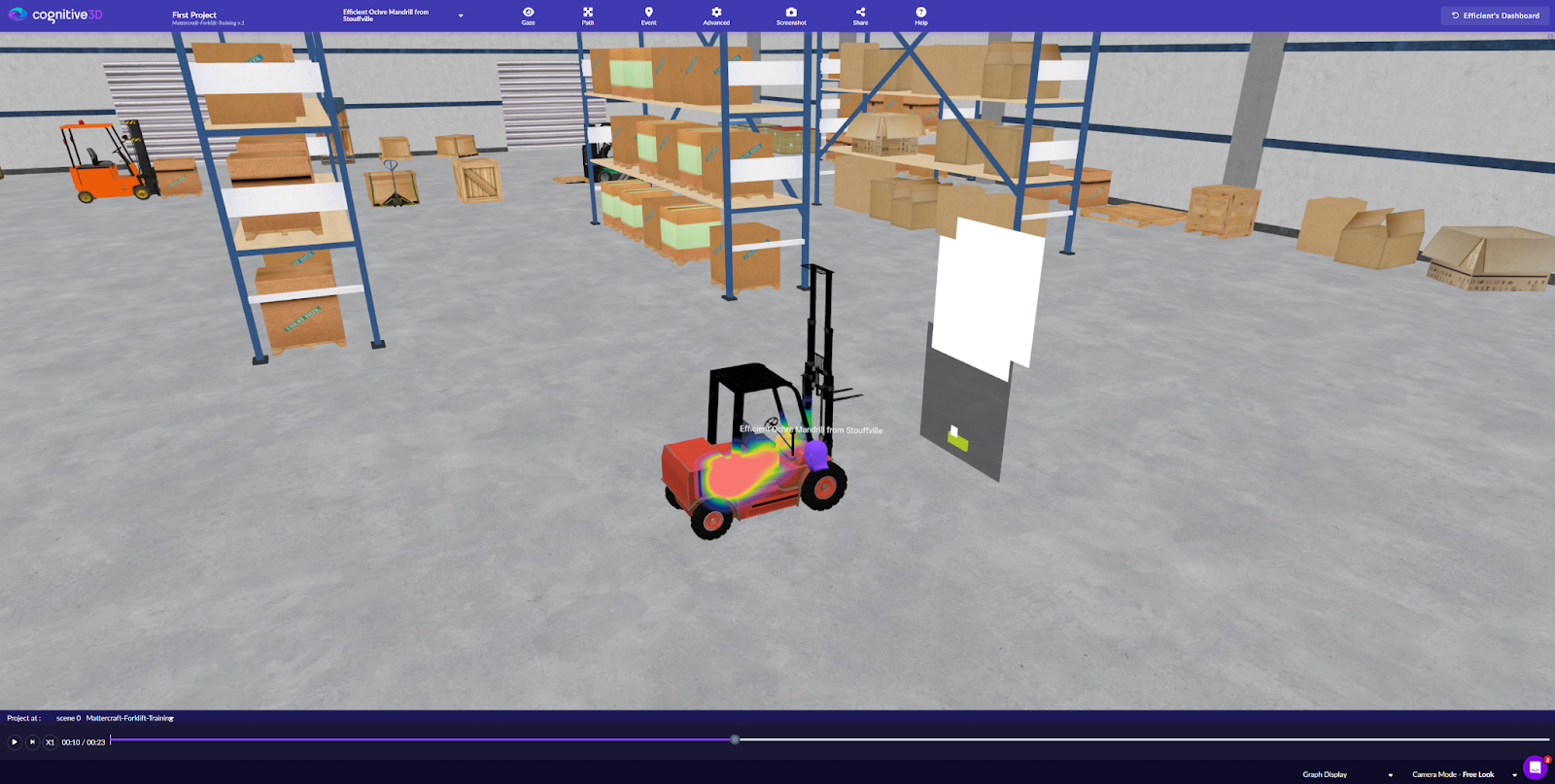

Once your scene is set up on the Cognitive3D website:
  1. Return to the Cognitive3D Manager node in your scene Hierarchy
  2. Enter your Scene ID, Scene Name and Scene Version alongside your Application Key
Session data will not be recorded during Live Preview. Cognitive3D will begin capturing data once your experience is published.
