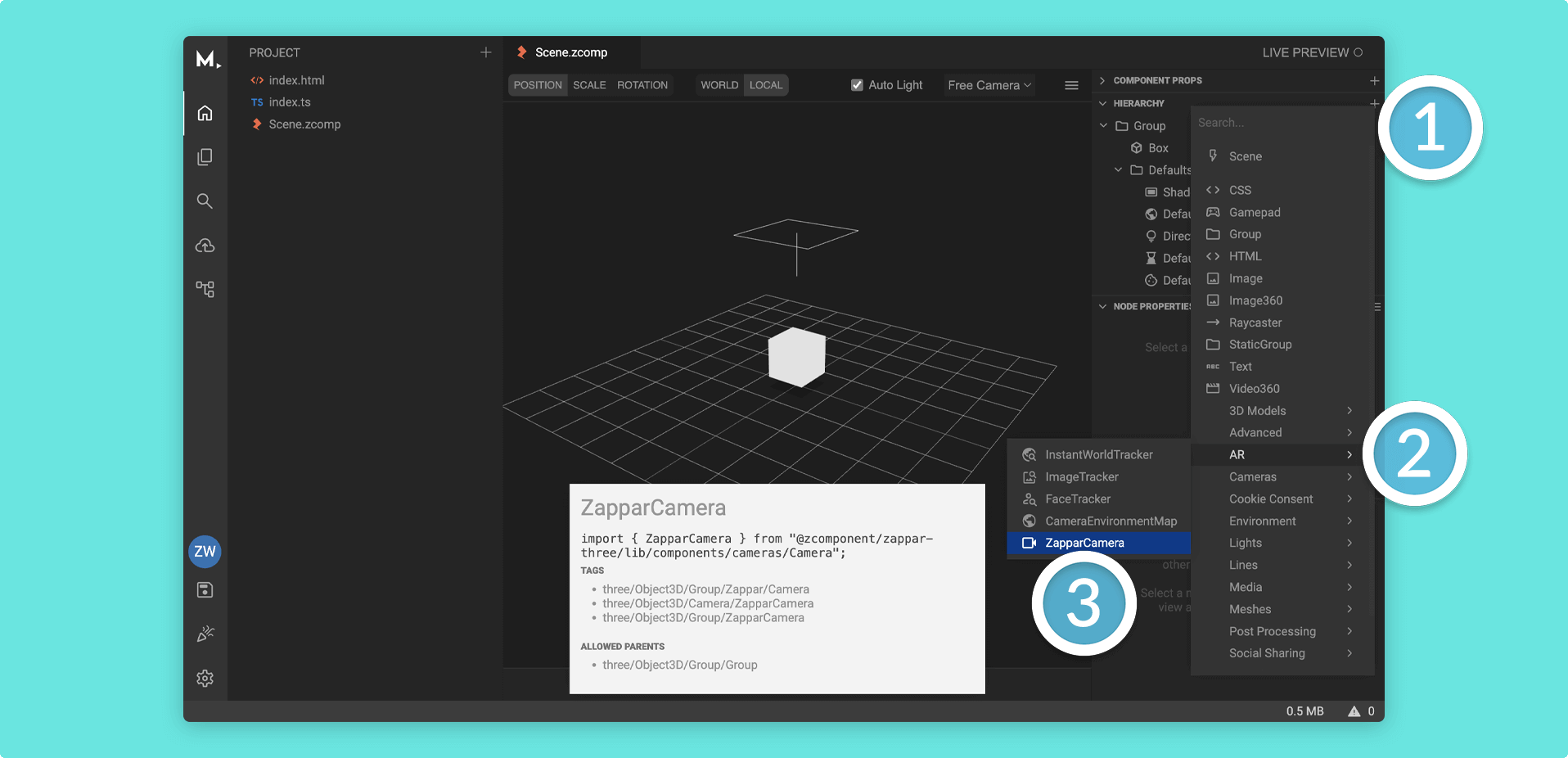

To start using the ZapparCamera from here, you can then add the ZapparCamera component to your Hierarchy by using the following instructions:
- Click on the + (plus) icon in your Hierarchy (or right click on a Group Node)
- Find the
ARcomponent category and from here, selectZapparCamera
The ZapparCamera will give you the correct parameters to track content, as well as request the appropriate permissions to access the camera and motion sensors on the user’s device.
