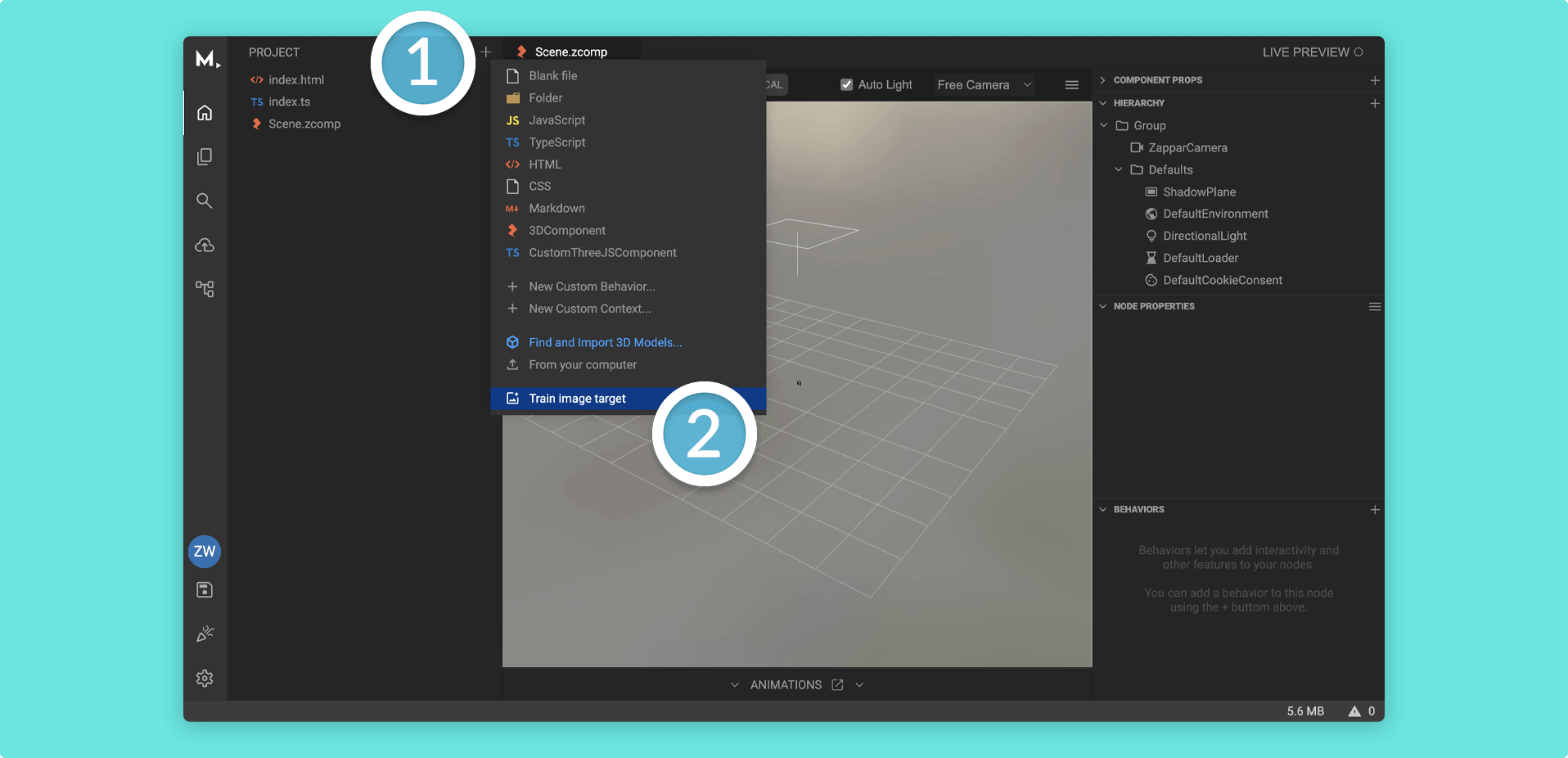

Image trackers use a special ‘target file’ that has been generated from the source image (.jpg or .png) you’d like to track. You can create a target image by using the option found under the Left Menu’s + (plus) icon menu.
This will launch the in-built Image Trainer, which will first allow you to select the particular image tracking type you would like to use. The options are as such:

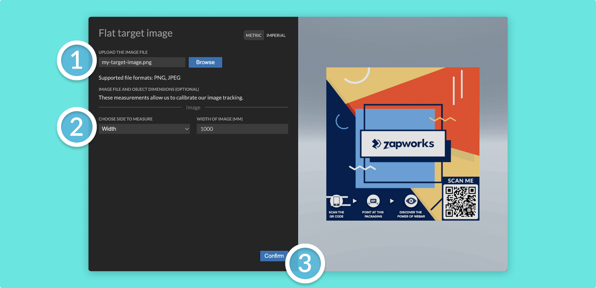

When you select an image tracking type (Flat, Curved or Conical), you will then be prompted to upload an image file (a regular .png or .jpg) for training; as well as provide measurements for that image which will allow Mattercraft to calibrate the image tracking.
It is critical that Curved and Conical image measurements are exact, as this will affect the stability of your target image.
When Mattercraft has successfully trained your image, it will display a notice letting you know that you can begin to track content to it. You can then close the Image Trainer window and will see your target image file (.zpt) in the Left Menu, ready to be used as the Source for an ImageTracker component.

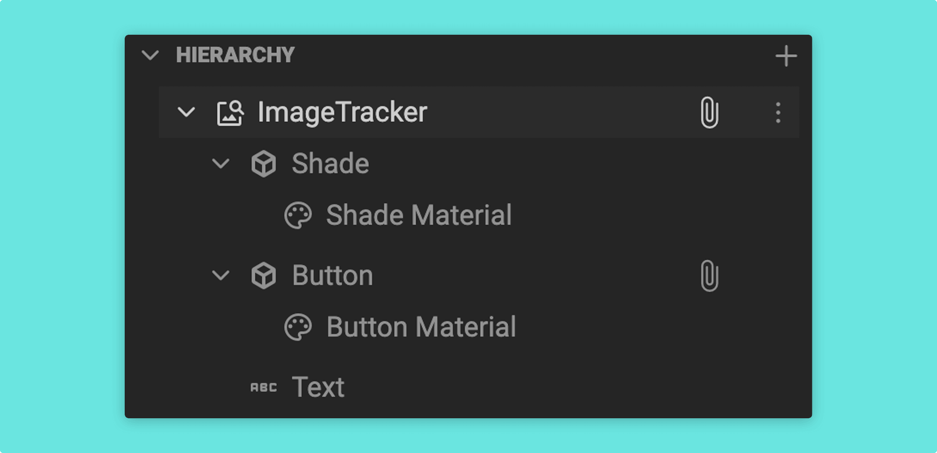

When your ImageTracker has an image assigned to it, you can start adding tracked content by placing components inside of the tracker.
