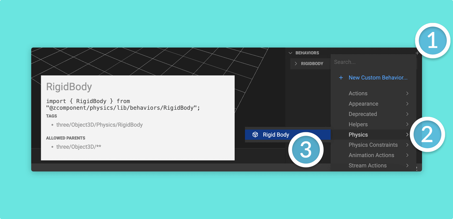

Adding a Rigid Body
Section titled “Adding a Rigid Body”Adding a Rigid Body to Mattercraft is simple and intuitive. Simply add a Physics → Rigid Body Behavior to a component.
The Rigid Body Behavior sets up and exposes everything you need to get started with physics, including creating a default Collider (depicted as a green bounding box) to wrap around your component.

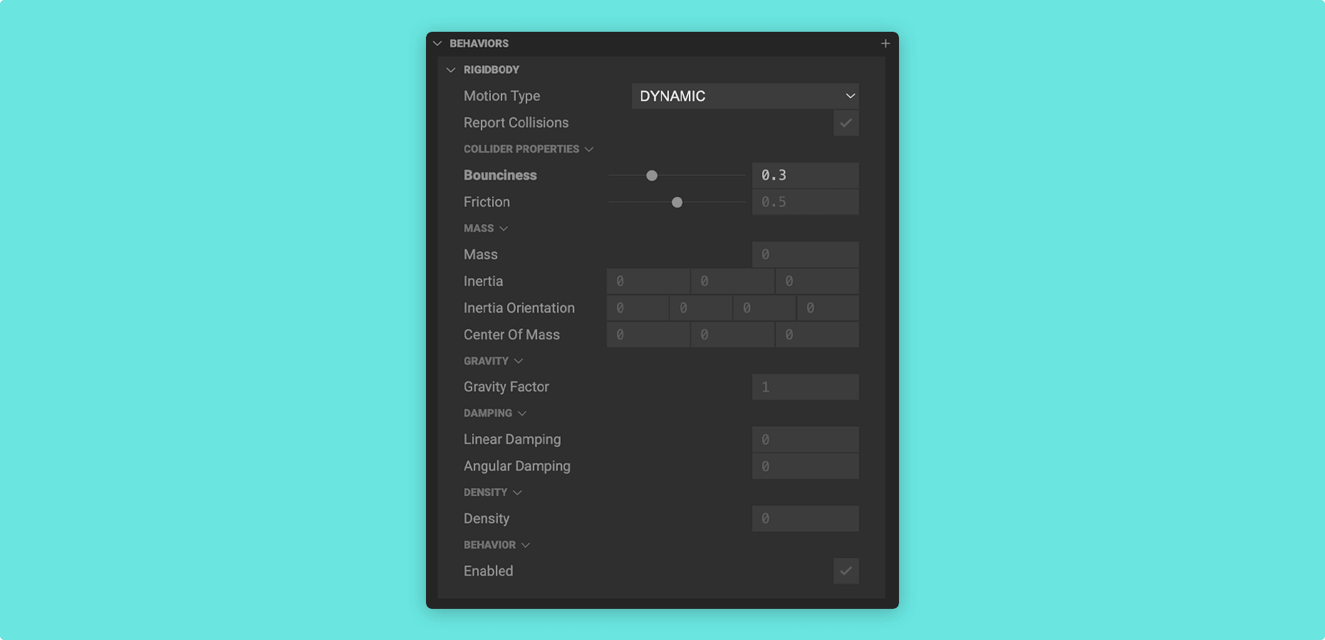

You can update and customize your Rigid Body Behavior properties in the Behaviors Panel.
Rigid body properties
Section titled “Rigid body properties”Components that have the Rigid Body Behavior attached will have the following additional properties:
| Property | Description |
Motion Type |
Describes how the Rigid Body is able to move. These options are:Static: Not affected by external forces (collisions, gravity, etc.) and is optimized to never move. Great for platforms, buildings, etc.Dynamic: Natural movement and affected by external forces. Used for things that need to bounce, have friction, etc.Kinematic: Not affected by external forces but can be animated, for example, on a timeline. Perfect for things like moving platforms. |
Report Collisions |
If true, an onCollision event is emitted. |
Bounciness |
This describes how bouncy the object will be.0: No energy is retained and it will not bounce.1: All energy is retained and will bounce. |
Friction |
Determines how much an object will slow down. Important for simulating realistic physics, such as an object sliding across a surface. |
Mass |
Sets the Rigid Body’s overall mass, which affects how easy it is to move. |
Inertia |
Determines how easy the object is to rotate. |
Inertia Orientation |
Describes the axes that a Rigid Body spins around. |
Center of Mass |
Sets the Rigid Body’s mass distribution. |
Gravity Factor |
Sets the force of gravity on a Rigid Body. |
Linear Damping |
Sets how fast the linear velocity decreases on the Rigid Body over time. |
Angular Damping |
Sets how much the Rigid Body resists rotating over time. |
Density |
Sets the Rigid Body’s overall density. |
