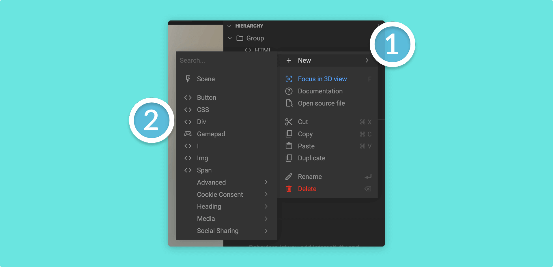

Simply right-click on the HTML node in the Hierarchy to reveal the available elements you can add:
