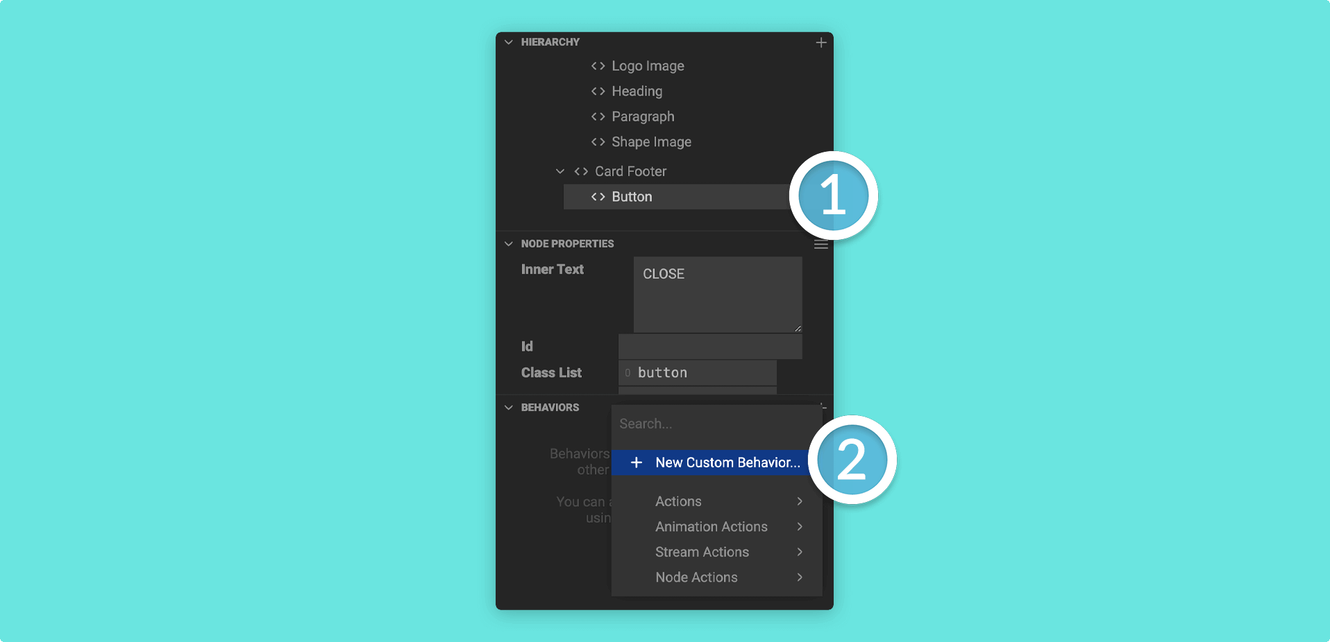

1. Click on your button in the Hierarchy and then find the Behaviors Panel. Click on the plus (+) icon in the Behaviors Panel and then + New Custom Behavior.

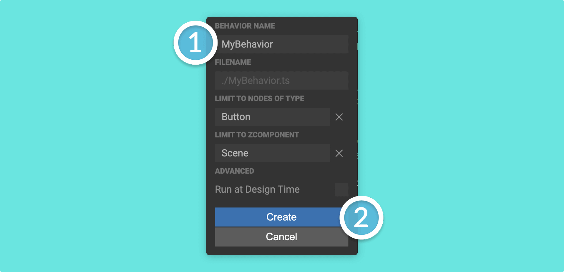

2. Give your custom behavior a name and then click on Create.
If you want your custom behavior to take effect in the Mattercraft editor, check the Run at Design Time box.

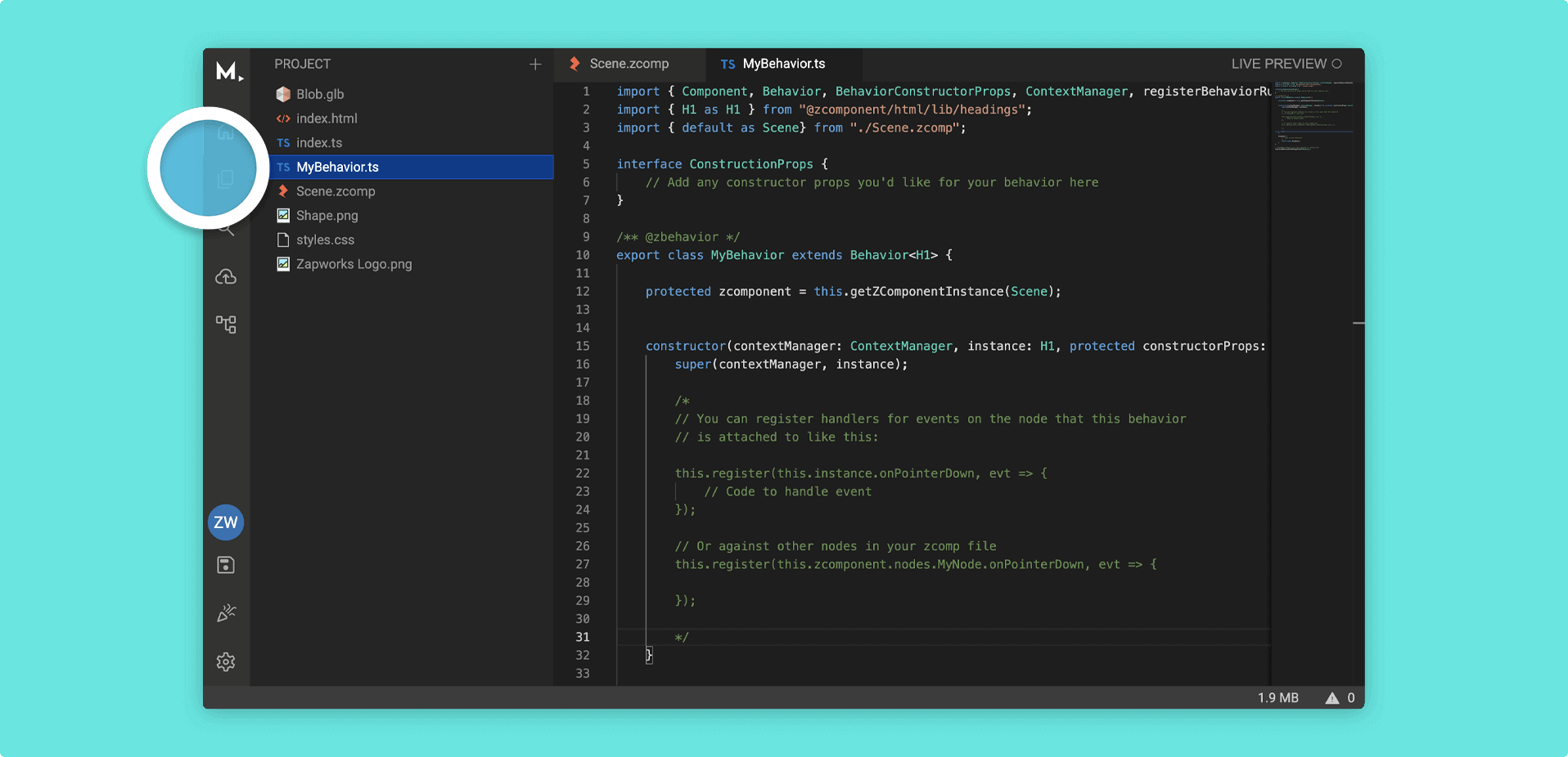

3. Head to the Left Menu and double click on your custom behavior to open it in the Mattercraft scripting environment.
You can also open the script by right clicking on it in the Left Menu and going to Open to the Side
