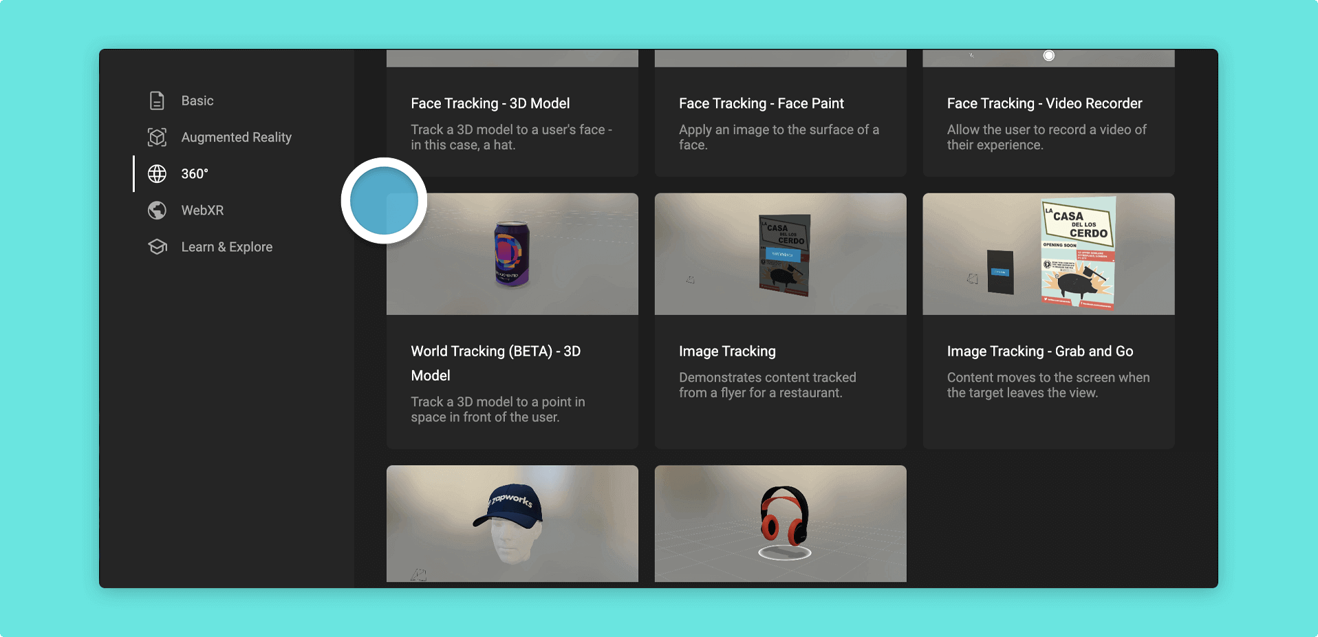

When you open Mattercraft, you will be presented with a few Project Templates to help you get started.
Upon selecting a World Tracking template, your .zcomp will display a project which includes a WorldTracker component; as well as some simple content and basic behaviors.

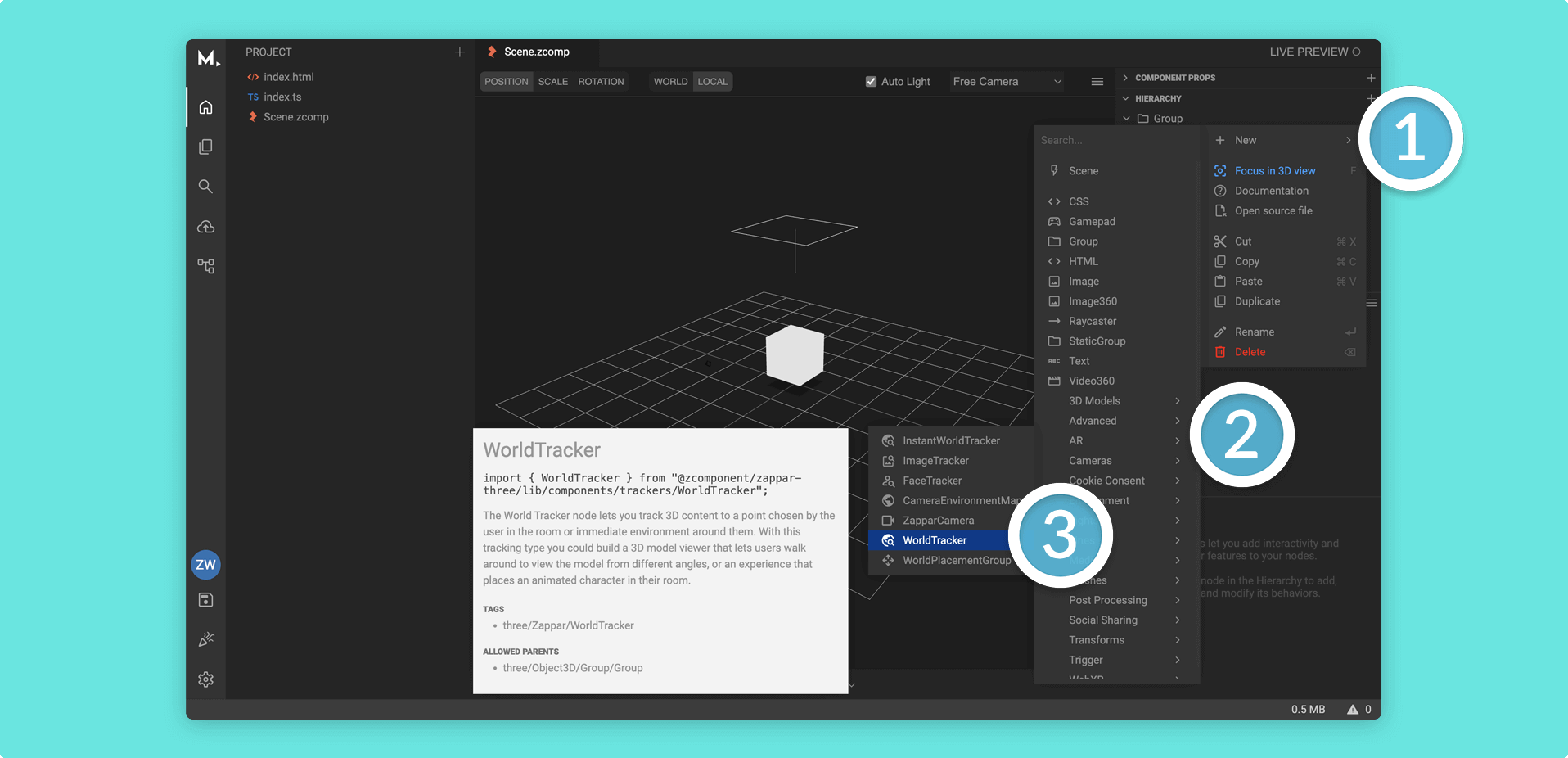

To add World Tracking to an existing project, you will first need to install a beta version of the Augmented Reality by Zappar package from the dependencies browser if you have not already.
You can then add the WorldTracker to your .zcomp by using the following instructions:
- Click on the + (plus) icon in the Hierarchy (or right click on a Group Node)
- Find the
ARcomponent category and from here, selectWorldTracker
To use World Tracking properly, you must also add (or replace any existing camera you have in your
.zcompwith) aZapparCameracomponent. Learn more about this on our dedicated Zappar Camera article.

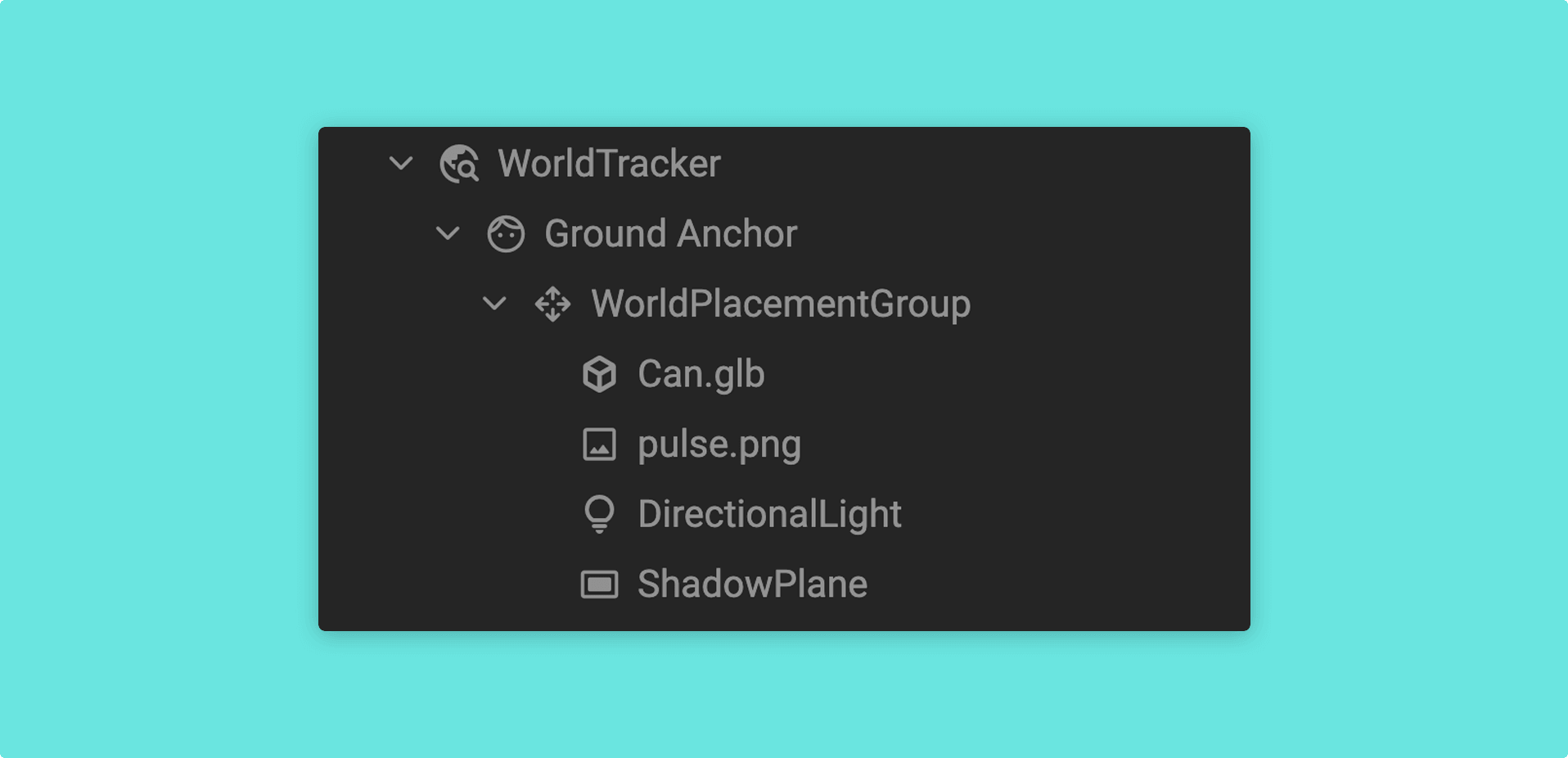

Tracking content to the environment
Section titled “Tracking content to the environment”When your World Tracker is in the Hierarchy, you can start adding tracked content by placing components inside of the tracker’s WorldPlacementGroup.
