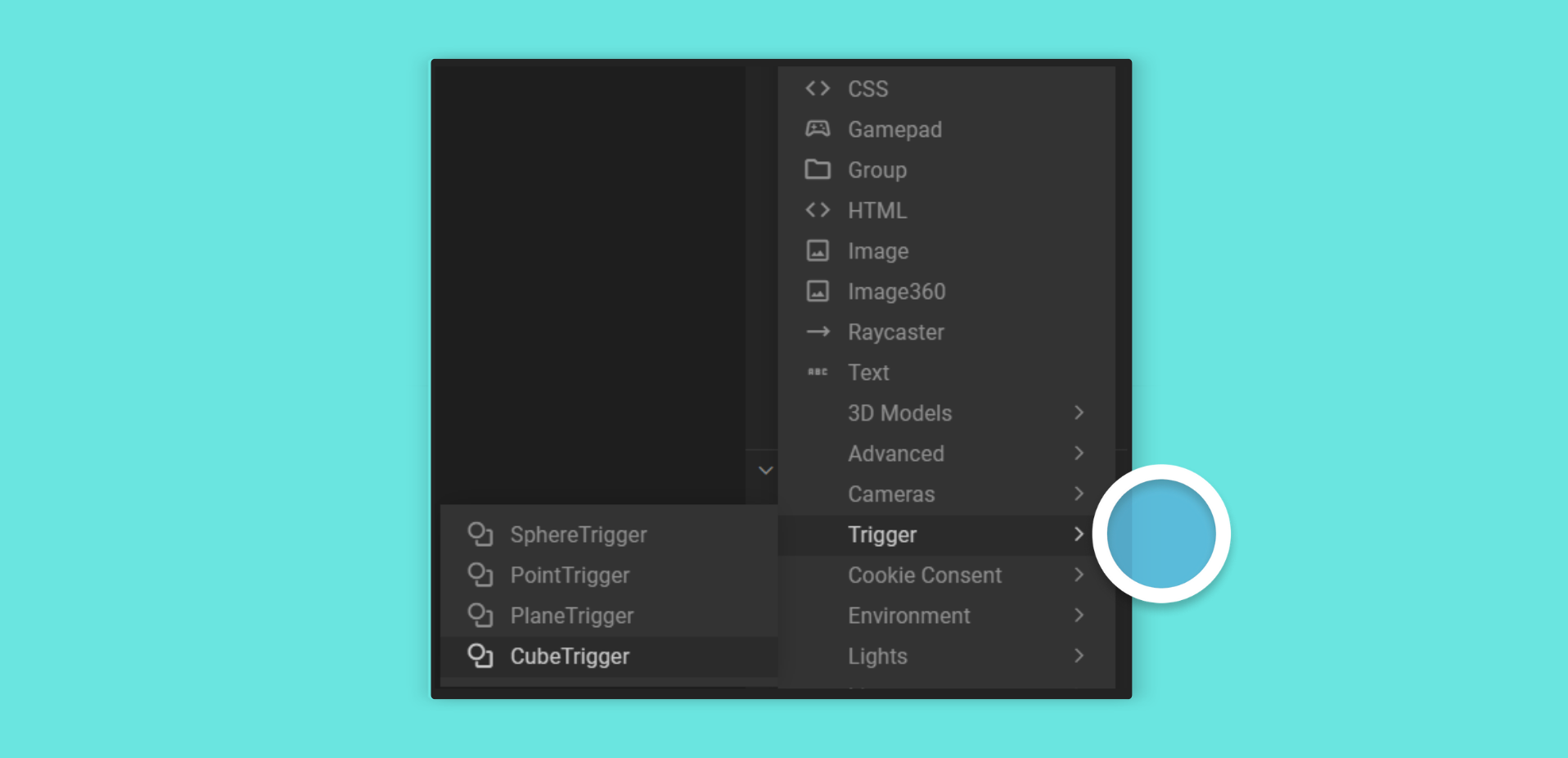

Adding Triggers
Section titled “Adding Triggers”To add a trigger to your project, simply right-click on the Hierarchy and go to the Triggers dropdown. Currently, Mattercraft supports four trigger shapes:
SphereTriggerPointTriggerPlaneTriggerCubeTrigger

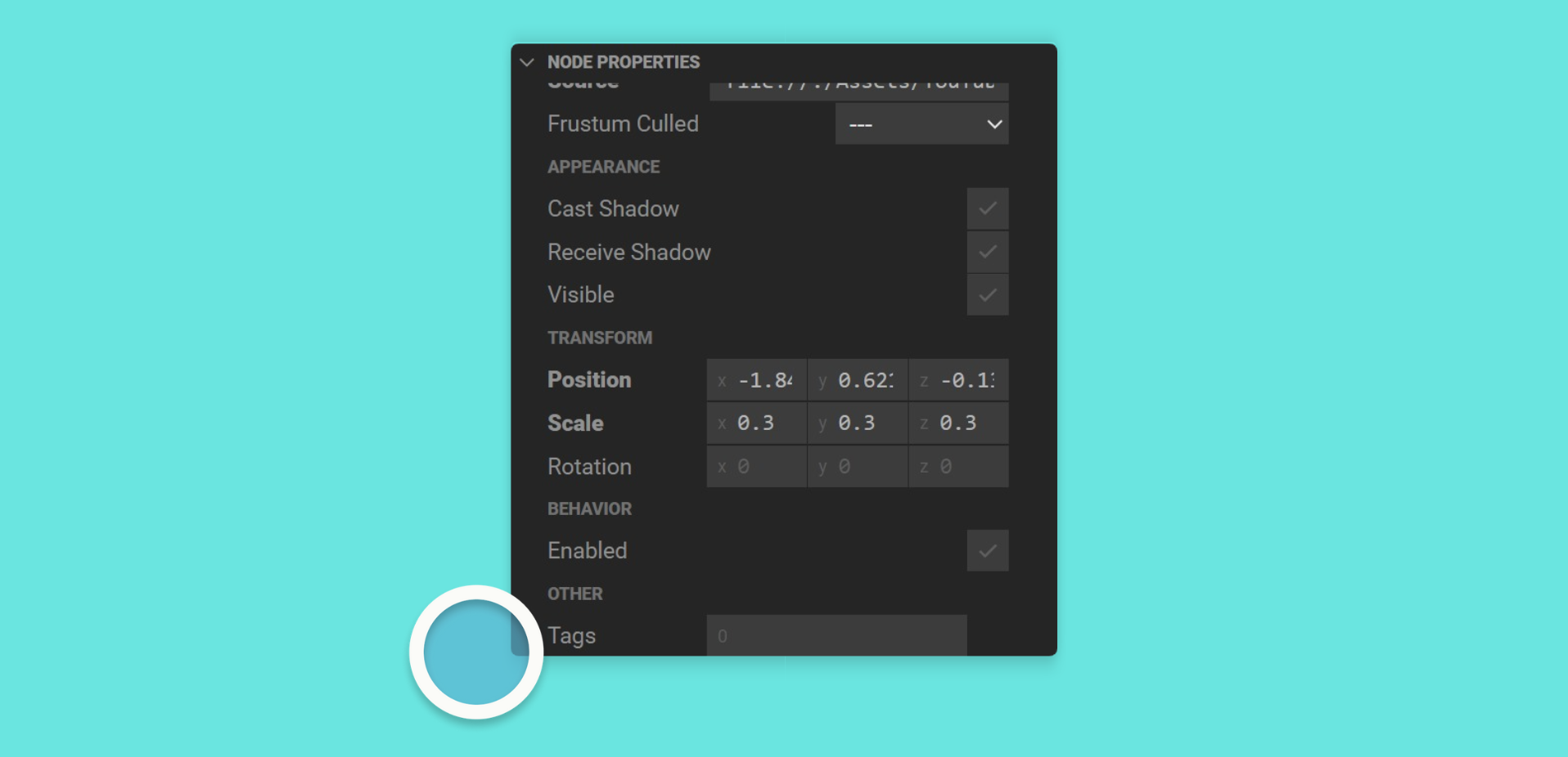

Section titled “Using Triggers”Tags
For triggers to interact with each other, they must have the exact same tag assigned to each of them. Tags act as identifiers, meaning that triggers with the same tag will interact with each other while ignoring others with different tags, or those with none assigned at all.
To set the tag for a trigger, you should:
- Navigate to the Properties Panel and find the Other section (near the bottom)
- Add the exact same tag name (using any naming convention) to the
Tagproperty for all triggers that should interact with each other.

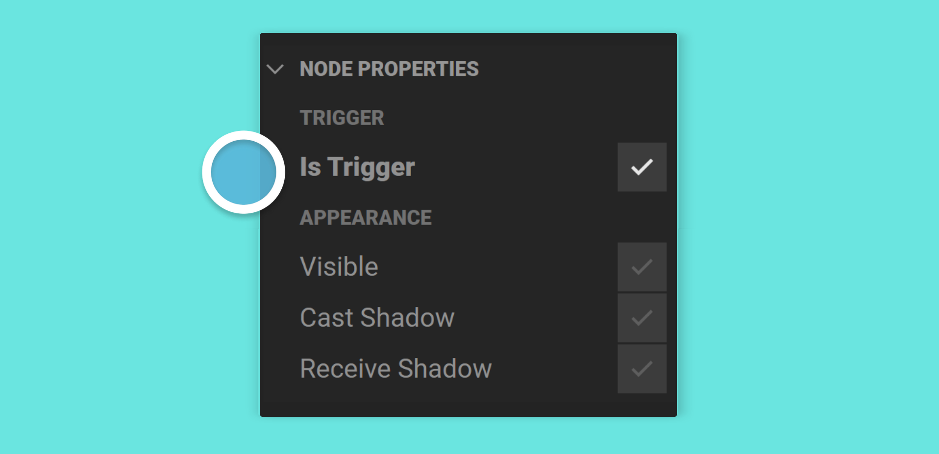

Is Trigger
Triggers can only emit events when they intersect with another trigger that is marked as a Trigger.
Only one trigger in the interaction needs to be marked as a trigger, typically the one for which you’ve set up the events.

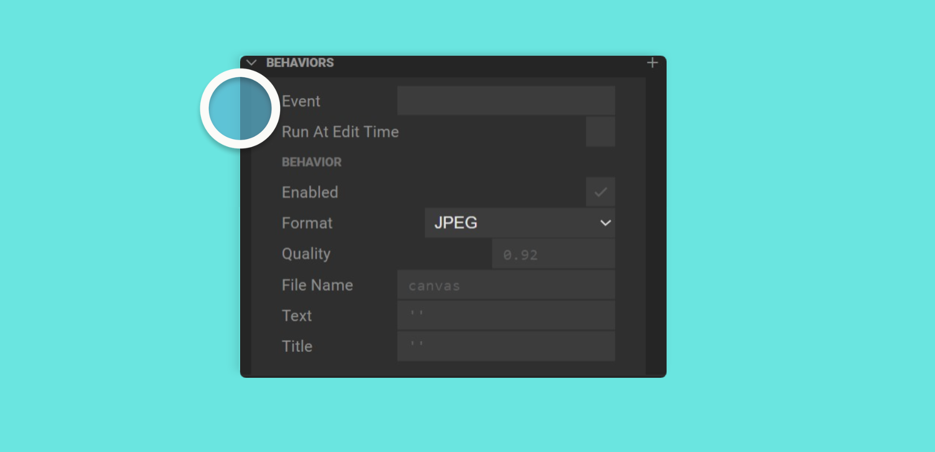

Triggering events with Behavior Actions
Section titled “Triggering events with Behavior Actions”You may trigger events from within the Mattercraft visual editor, or with custom scripts.
You can activate a state by using the following instructions:
- Find the Trigger you wish to trigger events with inside the Hierarchy Panel and select it
- Head to the Behavior Actions Panel and click on the + (plus) icon
- Assign the desired Behavior Action and the trigger’s
Eventproperty
