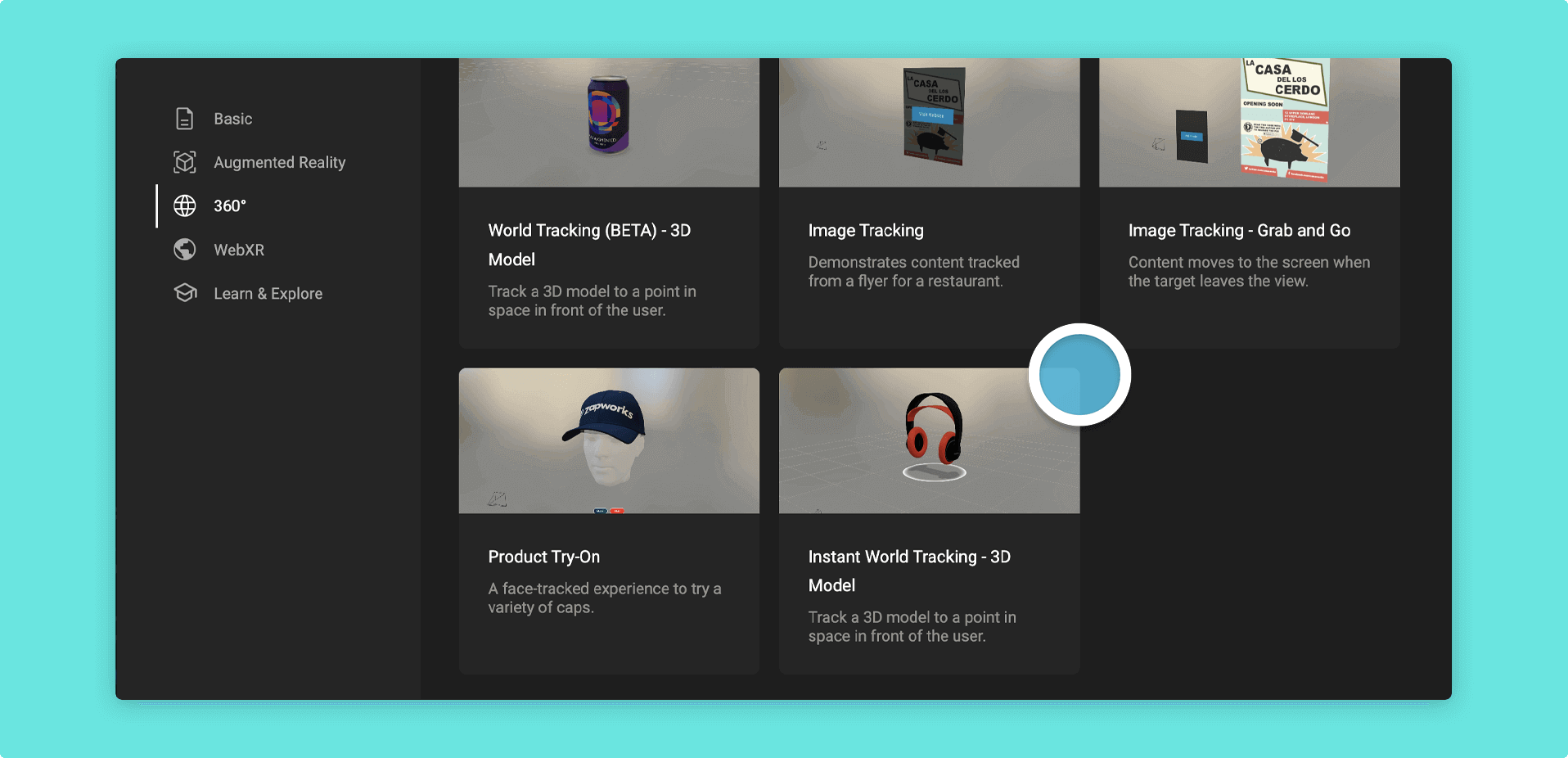

When you open Mattercraft, you will be presented with a few Project Templates to help you get started.

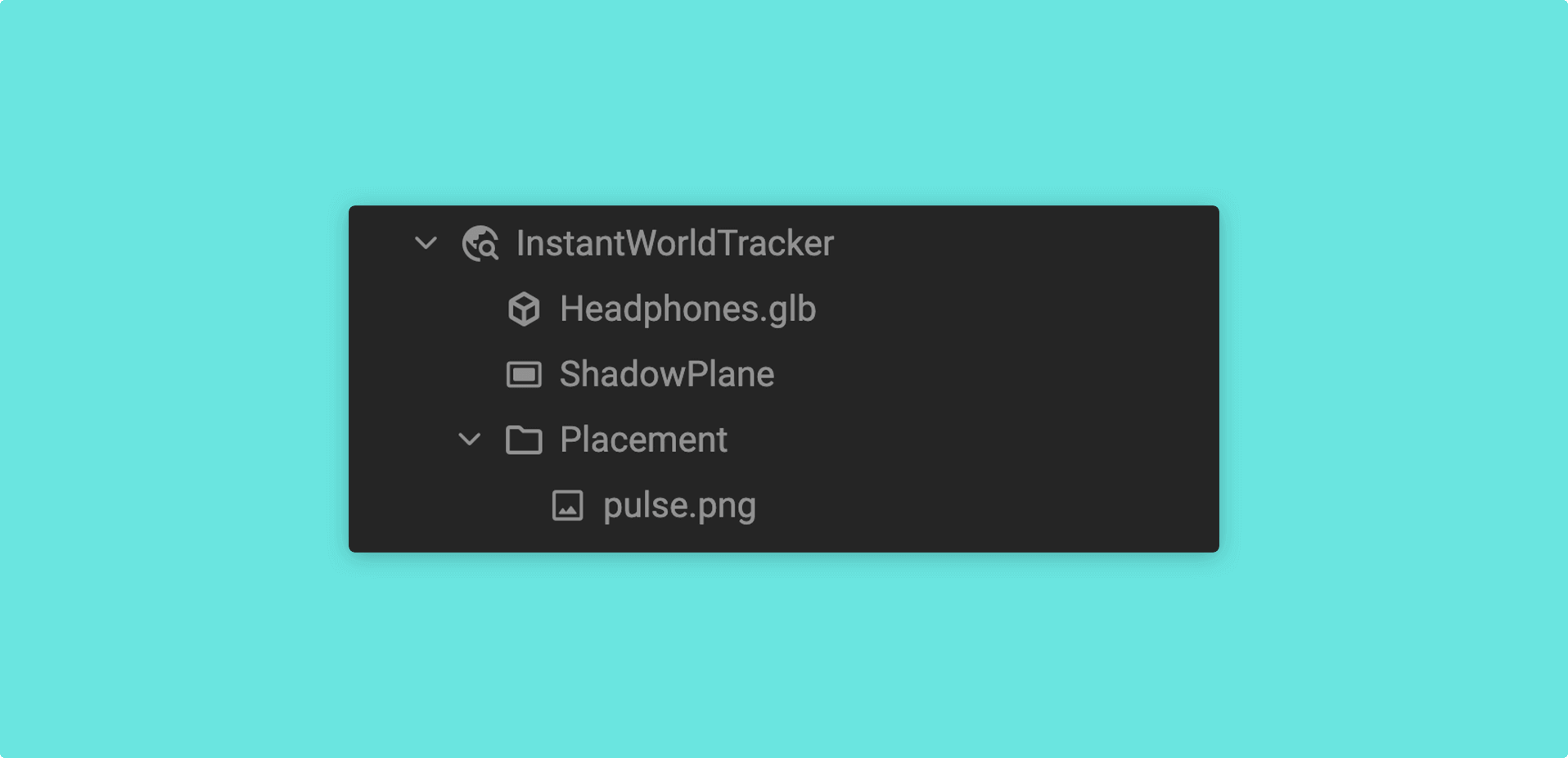

Upon selecting an Instant World Tracking template, your .zcomp will display a project which includes an InstantWorldTracker component; as well as some simple content and basic behaviors.
You may customize any Mattercraft template like an ordinary Mattercraft project.
To learn more about getting started with Mattercraft’s templates, check out our dedicated Project Templates documentation.

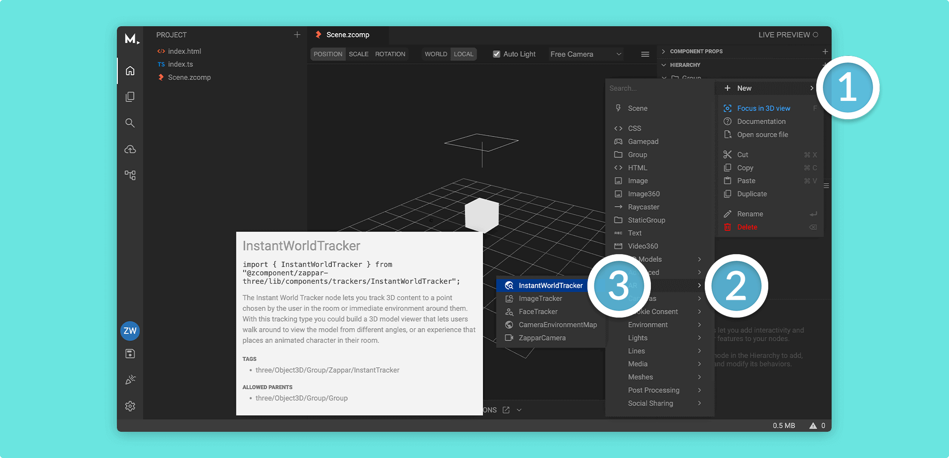

After following the pre-requisites, you can then add an InstantWorldTrackercomponent to your .zcomp. To do this:
- Click on the + (plus) icon in the Hierarchy (or right click on a Group Node)
- Find the
ARcomponent category and from here, selectInstantWorldTracker
To use Instant World Tracking properly, you must also add (or replace any existing camera you have in your
.zcompwith) aZapparCameracomponent. Learn more about this on our dedicated Zappar Camera article.

Section titled “Tracking content to an Instant World Tracker”When your Instant World Tracker is in the Hierarchy, you can start adding tracked content by placing components inside of the tracker.
