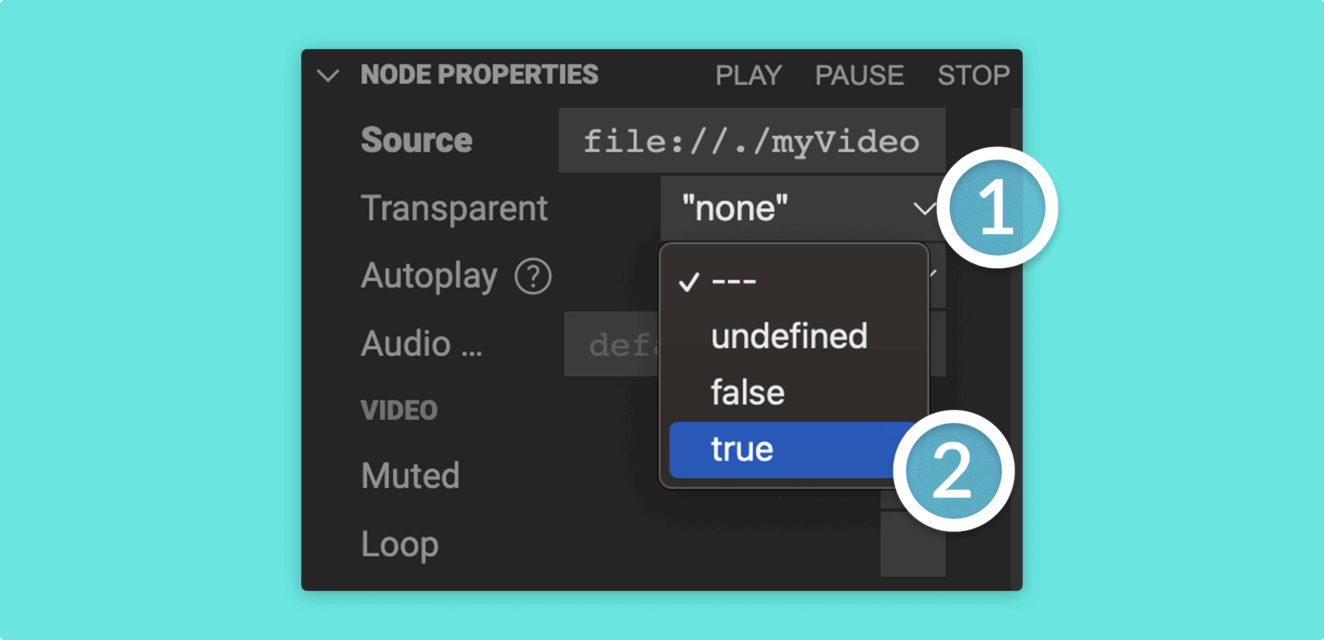

For videos requiring transparent areas, Mattercraft offers the chromaKey feature.
Using the chromaKey material for transparent videos
Follow these steps to use it:
  1. Add your Green Screen Video following the steps above
  2. Drag the Video into the Hierarchy
  3. In the Properties Panel, set the Transparent property to chromaKey
  4. Still within the Properties Panel, scroll down to the Chroma Key Transparency section and click on the Key Color
  5. Use the color picker to select the green color in your video that you want to make transparent
This should update the video and mask out the green screen. You can further refine the Similarity, Smoothness, or Spill properties in the same section for the perfect green screen effect.
If you have a masked side-by-side video, you can use the sideBySide property value to create transparency:
Side by Side Videos
You may use the following instructions for side by side video:
  1. Add your Masked Side By Side Video following the importing steps above
  3. In the Properties Panel, set the Transparent property to sideBySide
This should update the video and mask out the video properly. You can further refine the Direction or Alpha First properties in the same panel for the perfect masking effect.
