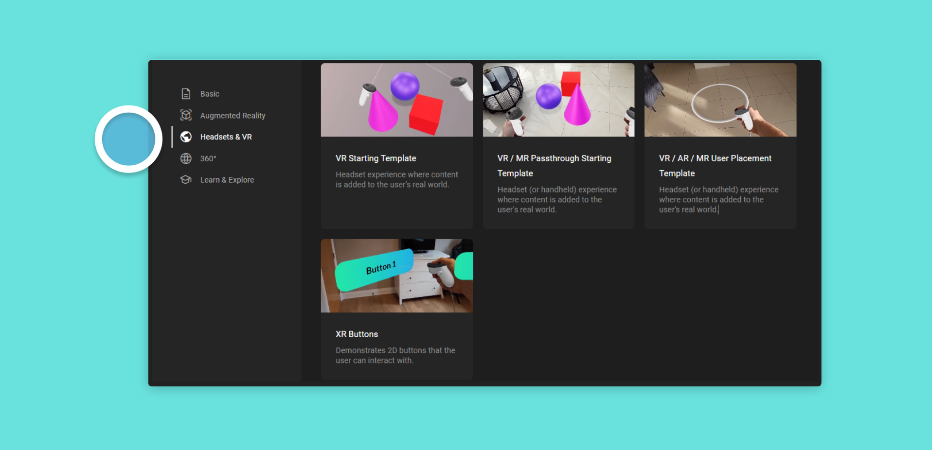

Using a Project Template
Section titled “Using a Project Template”Once you select a template, like the VR/MR passthrough Starting Template for example, it will configure your project with the specific components for that type of immersive experience.
These templates demonstrate certain WebXR functionalities and can be easily modified by swapping in your own assets.
You may click on a project template to learn more about it before you launch the project in the Mattercraft editor.

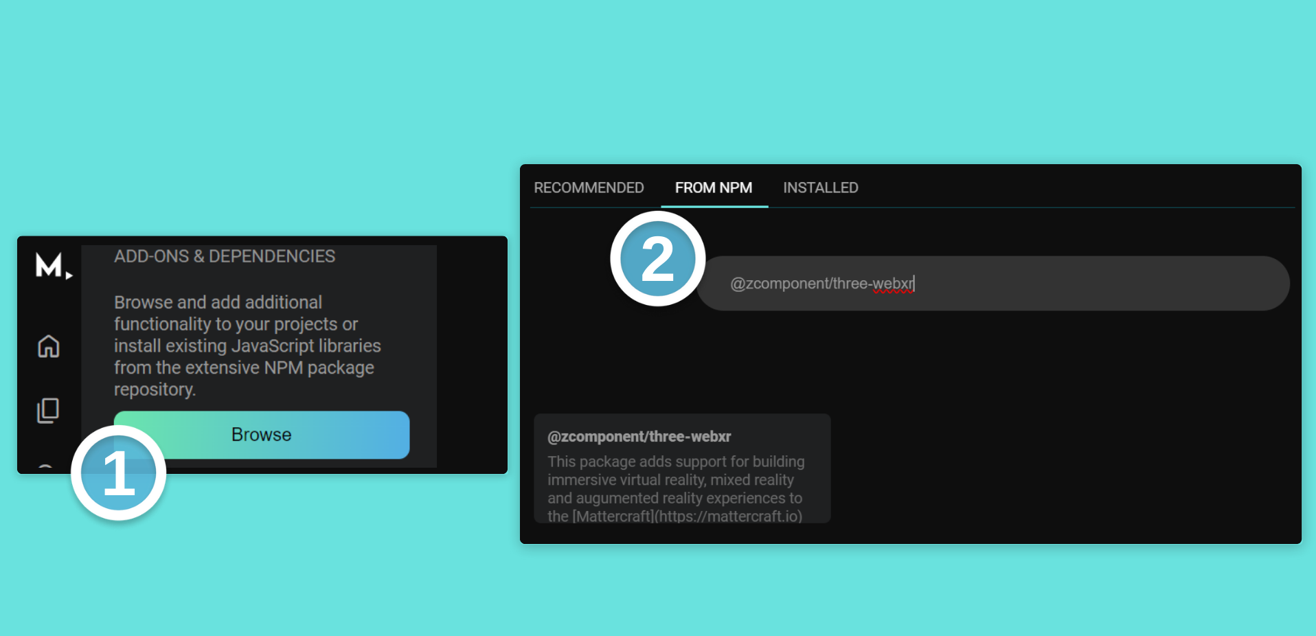

Section titled “Using the WebXR Package”We highly recommend using a dedicated project template from scratch, however, if you decide not to use a template and opt for the WebXR package, you will need to install it within your project first. Mattercraft allows you to easily add npm packages through its Add-ons & Dependencies tab.
Follow these instructions to install the Zappar WebXR package:
- Navigate to the Add-ons & Dependencies tab within the Left menu, and click on Browse.
- In the modal that pops up, click on the From NPM tab at the top.
- Within the search bar, type in
@zcomponent/three-webxrand then click on the module to install it.

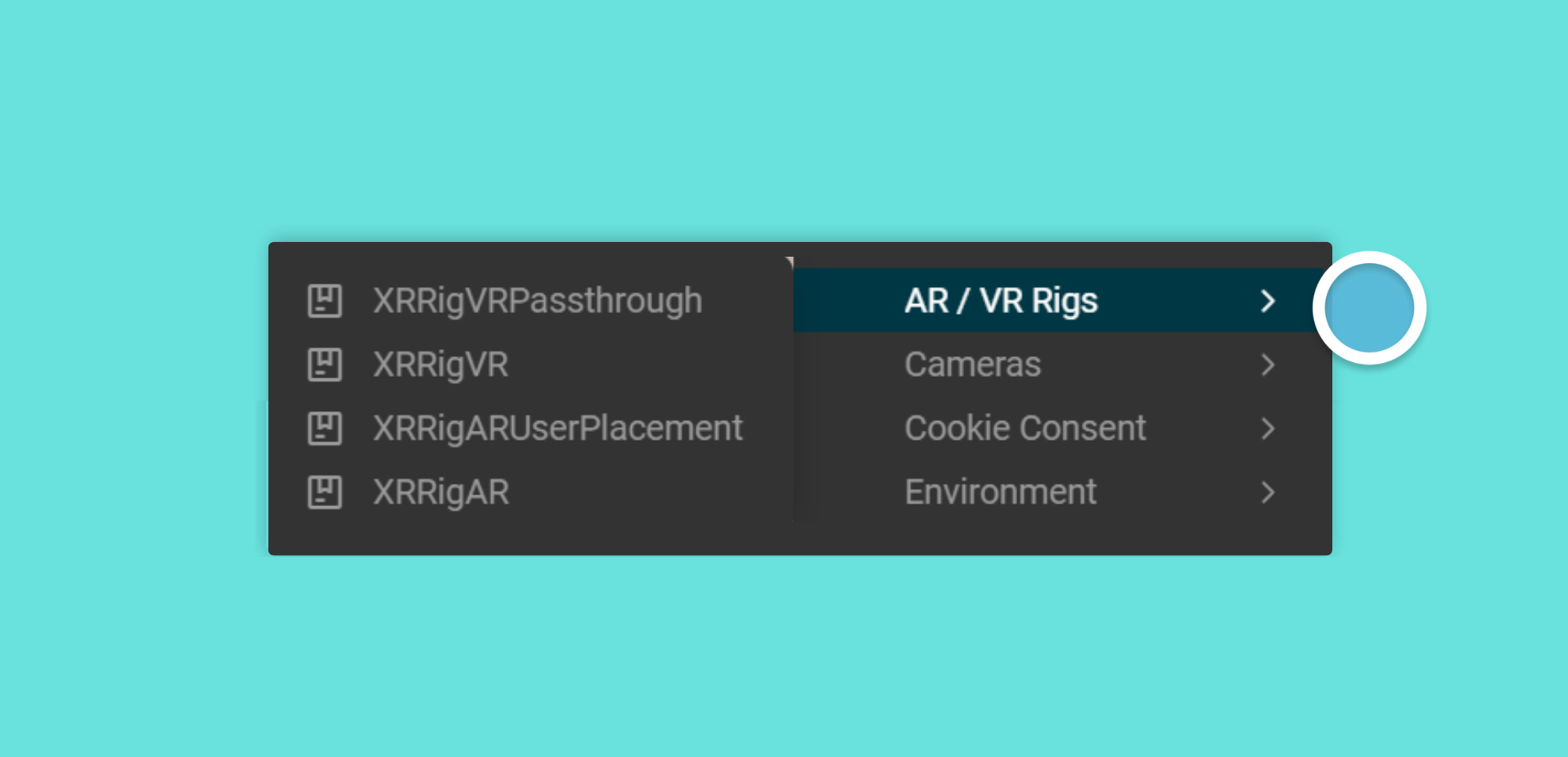

Section titled “Understanding the WebXR Components”Whether you use a template or install the NPM package, you can access all the WebXR components if you right-click on the menu next to the Hierarchy and click New under root(Group) . You will then see all the availablerigs to choose from the AR/VR Rigs menu.
You can then add a rig that corresponds with the immersive experience you aim to build.

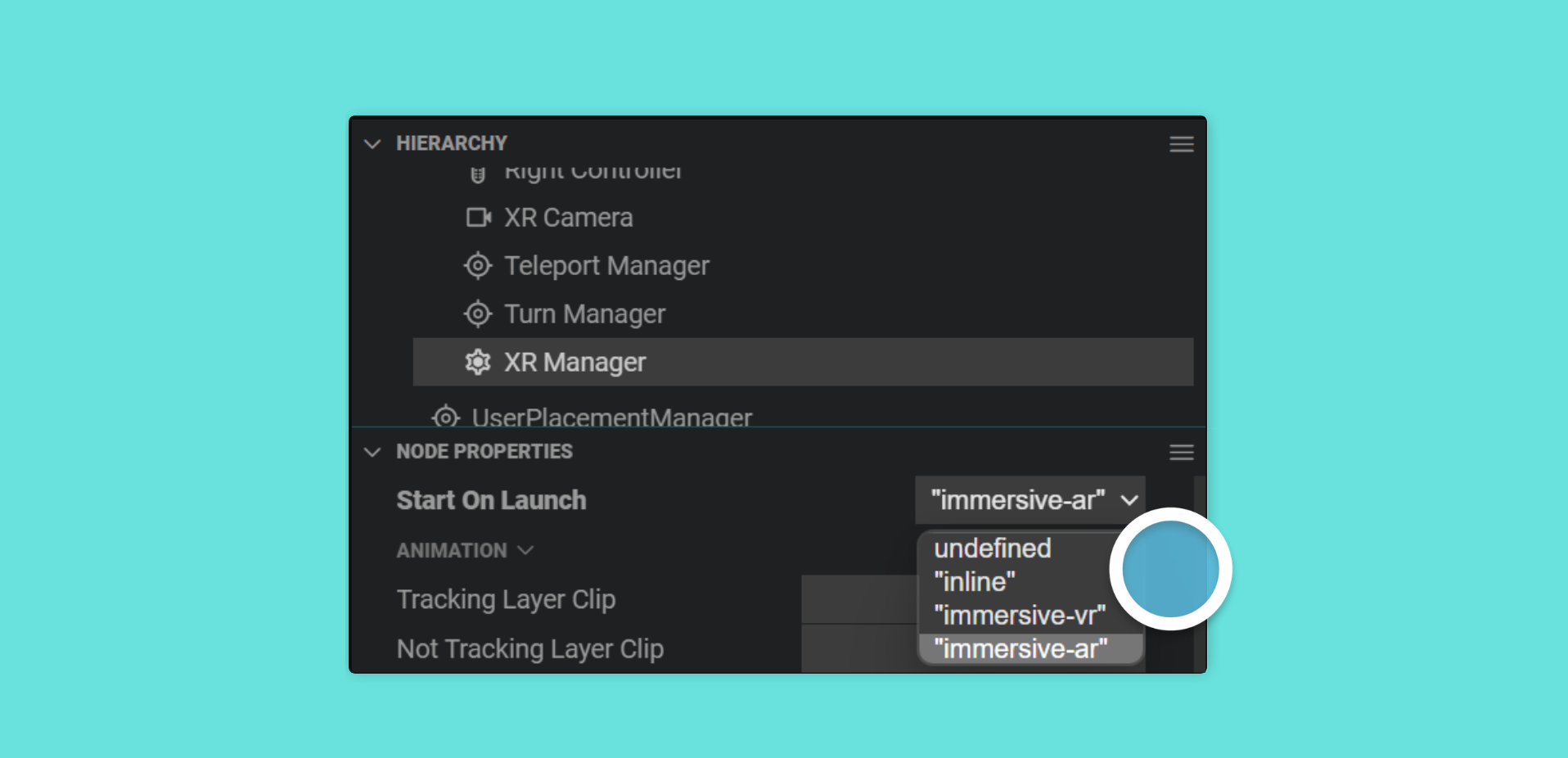

Section titled “Configuring the WebXR Package”Once you have selected a rig, you can edit the node properties of the different components within it. Each rig contains an XR Camera, XR Manager, Left Controller and Right Controller.
Depending on the selected
rig, you might also have additional options.
This table summarizes the main node properties for each available component within the various rig options.
| XR Rig Components | Main Node Properties | Description |
XR Manager |
Start On Launch |
Determines which mode (“immersive-vr” or “immersive-ar”) to start when the application launches. |
