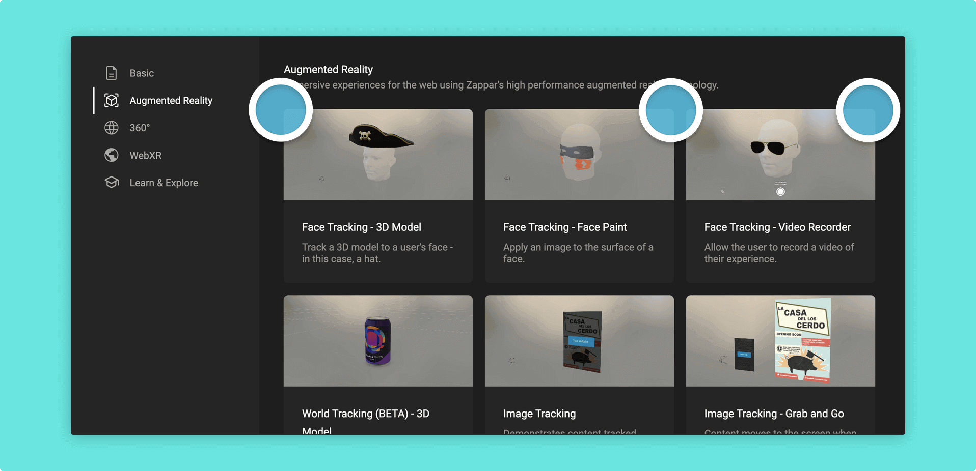

Customizing a template
When you open Mattercraft, you will be presented with a few Project Templates to help you get started.
Upon selecting a Face Tracking template, your .zcomp will display a project which includes a head mesh in the Viewport to indicate where to place your content; as well as some simple content and basic behaviors.
The template may also include a Head Mask Mesh, which will automatically hide content inside the head. This is used to mask 3D objects positioned behind the head, for example in the case of hats or helmets.
You may customize any Mattercraft template like an ordinary Mattercraft project.
To learn more about getting started with Mattercraft’s templates, check out our dedicated Project Templates documentation.

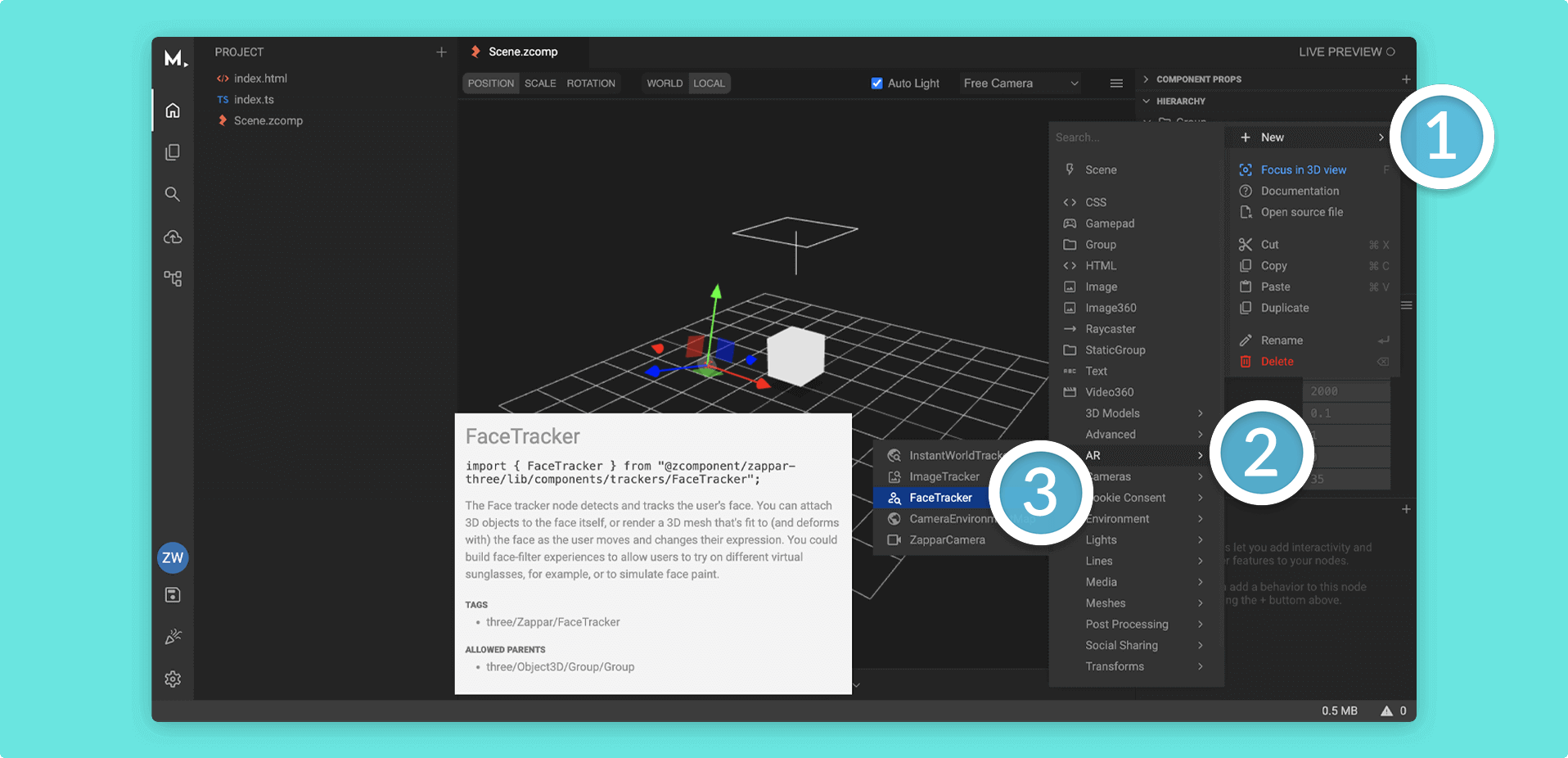

After following the pre-requisites, you can then add a FaceTracker component to your .zcomp. To do this:
- Click on the + (plus) icon in the Hierarchy (or right click on a Group Node)
- Find the
ARcomponent category and from here, selectFaceTracker

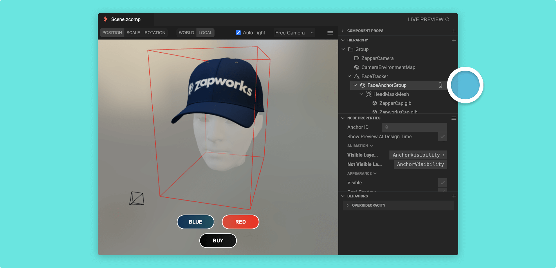

Section titled “Face Anchor Group”Each FaceTracker has an Anchor Group for faces detected and tracked in the camera view.
By default, a maximum of one (1) face is tracked at a time, however, you can change this by heading into the Node Properties Panel for the FaceTracker and updating the Max Faces parameter.
For example, you could then add another
Anchor Groupand set an individualAnchor IDif you wanted different content to appear on eachAnchor Group.

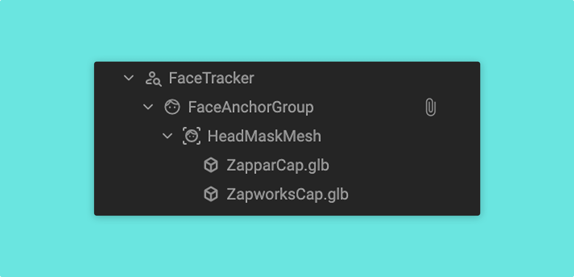

Section titled “Tracking content to a face”When your FaceTracker is in your Hierarchy and has an Anchor Group, you can start adding tracked content by placing components inside of the Anchor Group, or any Face Landmarks.
