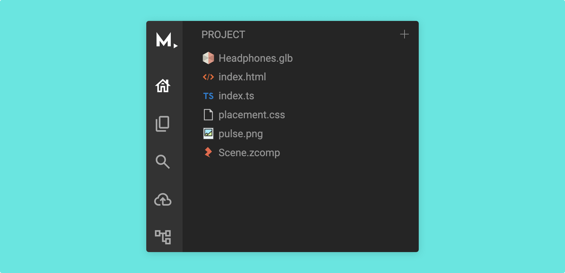

Project panel A list of files in your project that are relevant to the creative process.
All Files panel A tree of all of the files that make up your project, including those that are more technical or automatically generated by Mattercraft.

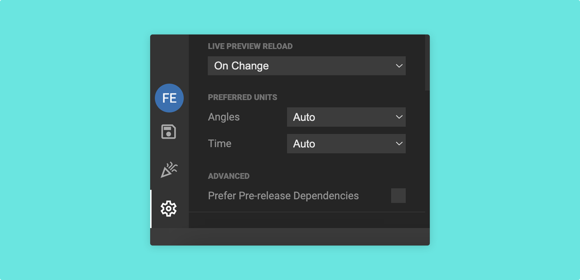

At the bottom of the Left Menu, you will find other helpful features in addition to the panels described above, such as:
Feature or panel Description
User Shows how many people are working on this project at the same time. You may have multiple users edit a Mattercraft project at once.
Commit history The Commit History lets you save versions of your project as you work on it.
What’s new The What’s New section provides a list of the latest Mattercraft updates.
Settings The Settings menu enables you to edit project-related settings.

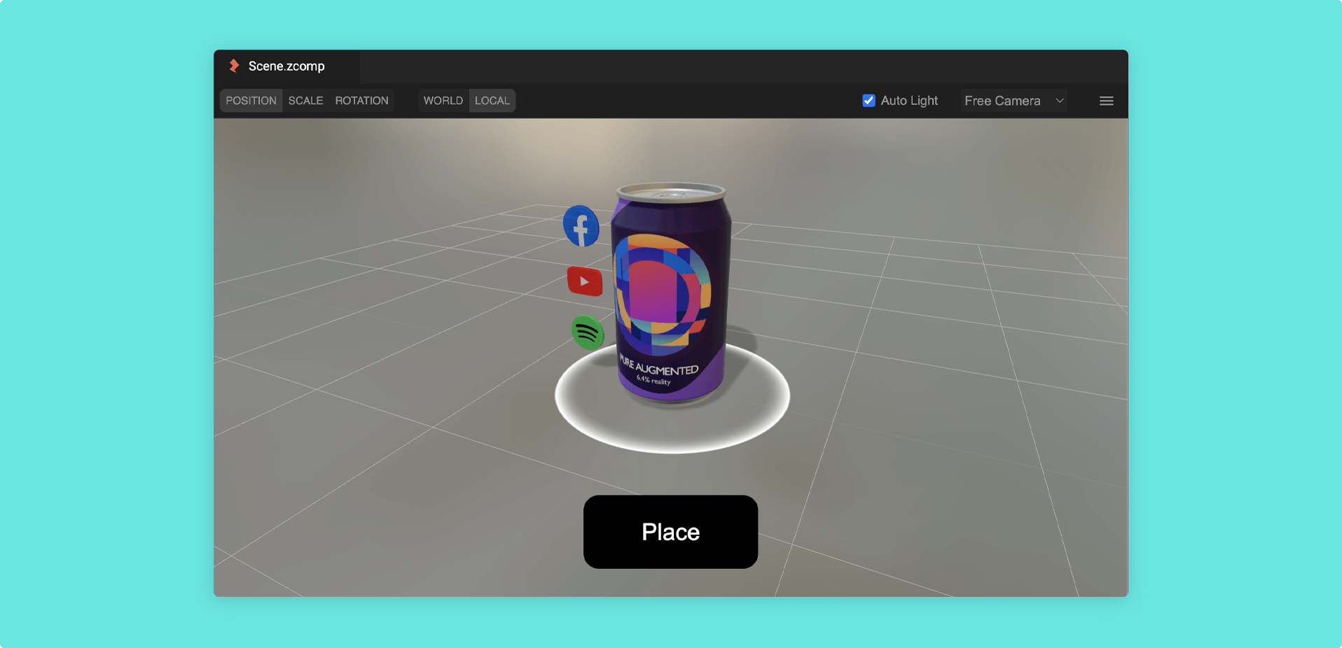

The 3D viewport provides a view of your scene, where you can manage the scale, rotation, and position of your content.

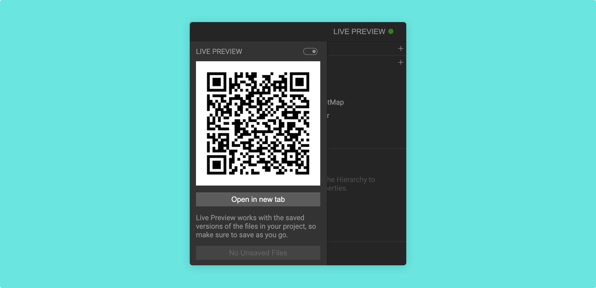

Clicking on the Live Preview button, located to the top left of the screen, will allow you to preview your project (remember to save your changes first!).
Learn how to preview and publish your Mattercraft project on our Previewing and Publishing documentation.

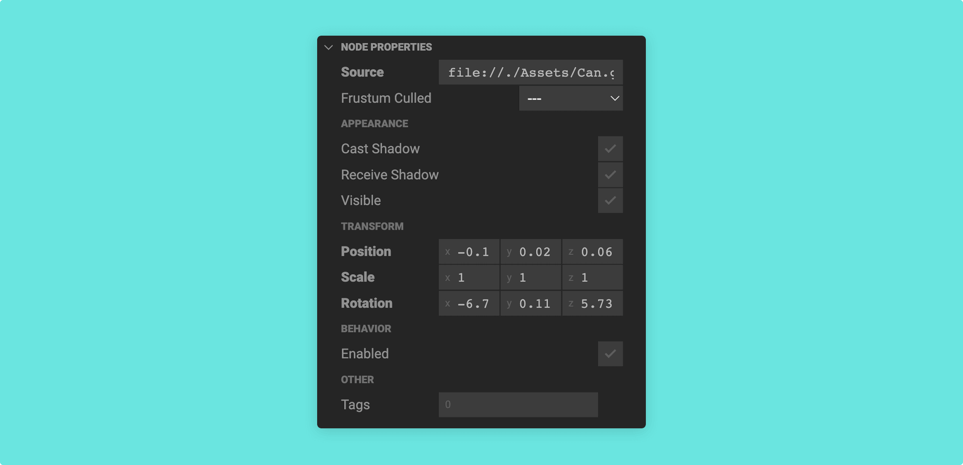

The Node Properties panel shows properties relevant to the selected node in the Hierarchy.
You can also use the gizmo in the 3D Viewport to adjust the Position, Scale and Rotation property of a node.

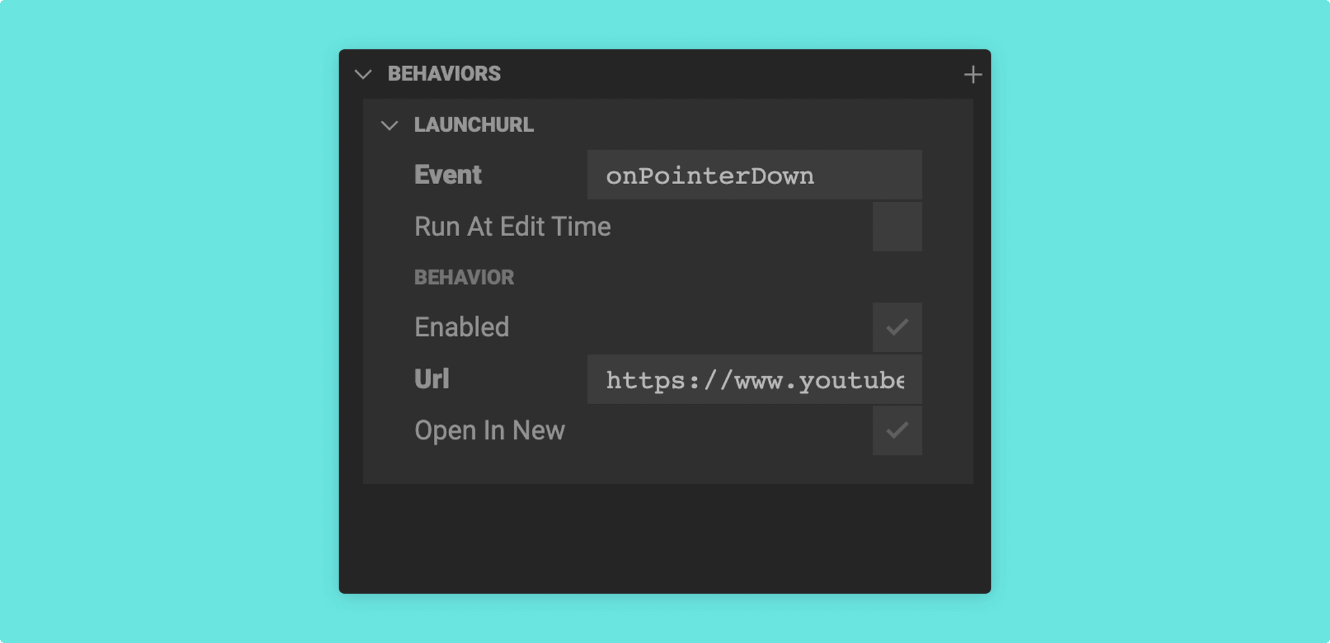

The Behaviors panel allows you to add or create custom behaviors for the selected node in the Hierarchy.
Learn how to add and create interactivity to your Mattercraft project with behaviors by taking a look at our Adding interactivity documentation.

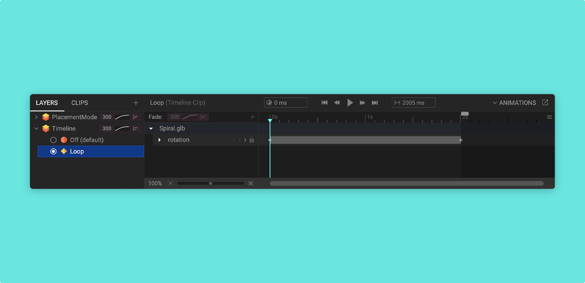

The Animations panel can be opened from the bottom right corner. This panel contains the characteristics of your animations; such as Layers, Timelines, and States.
You can also launch the Animations panel in a pop-up window. This is helpful if you have a larger project with a multitude of animations.
Using the Animation panel’s pop-out feature
Discover more about creating and using animations in your Mattercraft project by checking out our Animation System documentation.

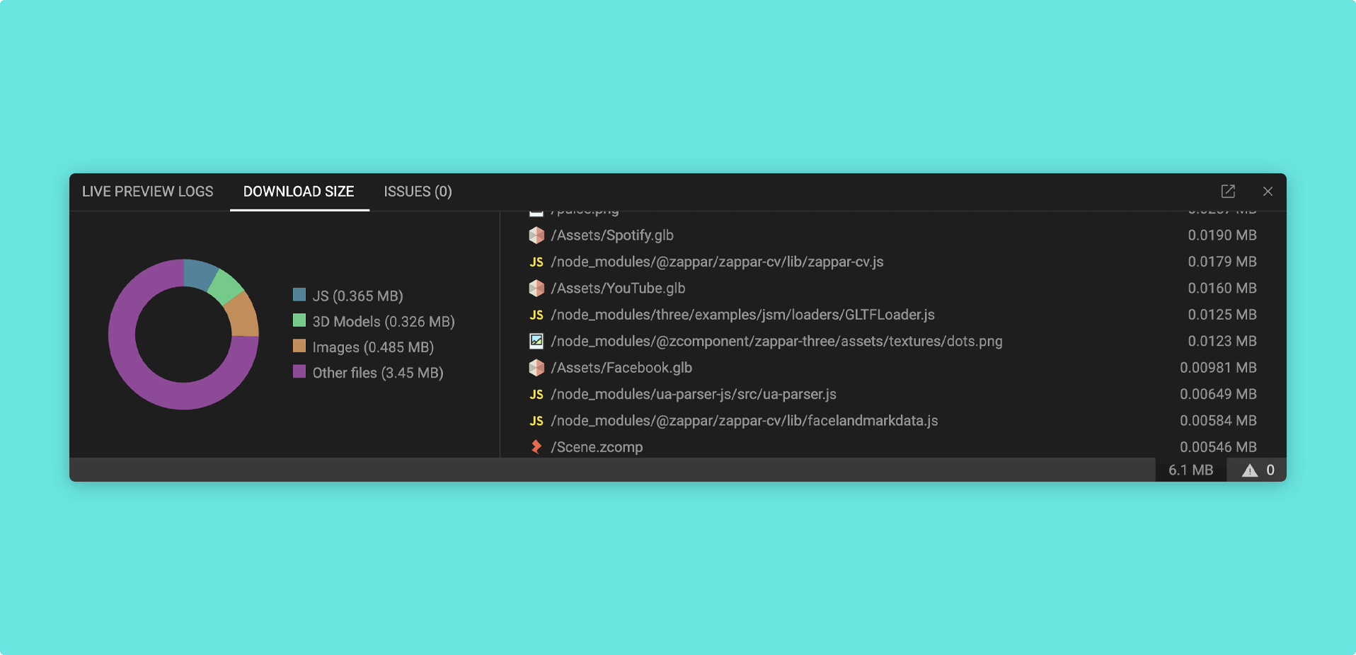

The Status Bar shows you the size of your project and if any errors are present. This bar also enables you with tools to debug your project.
