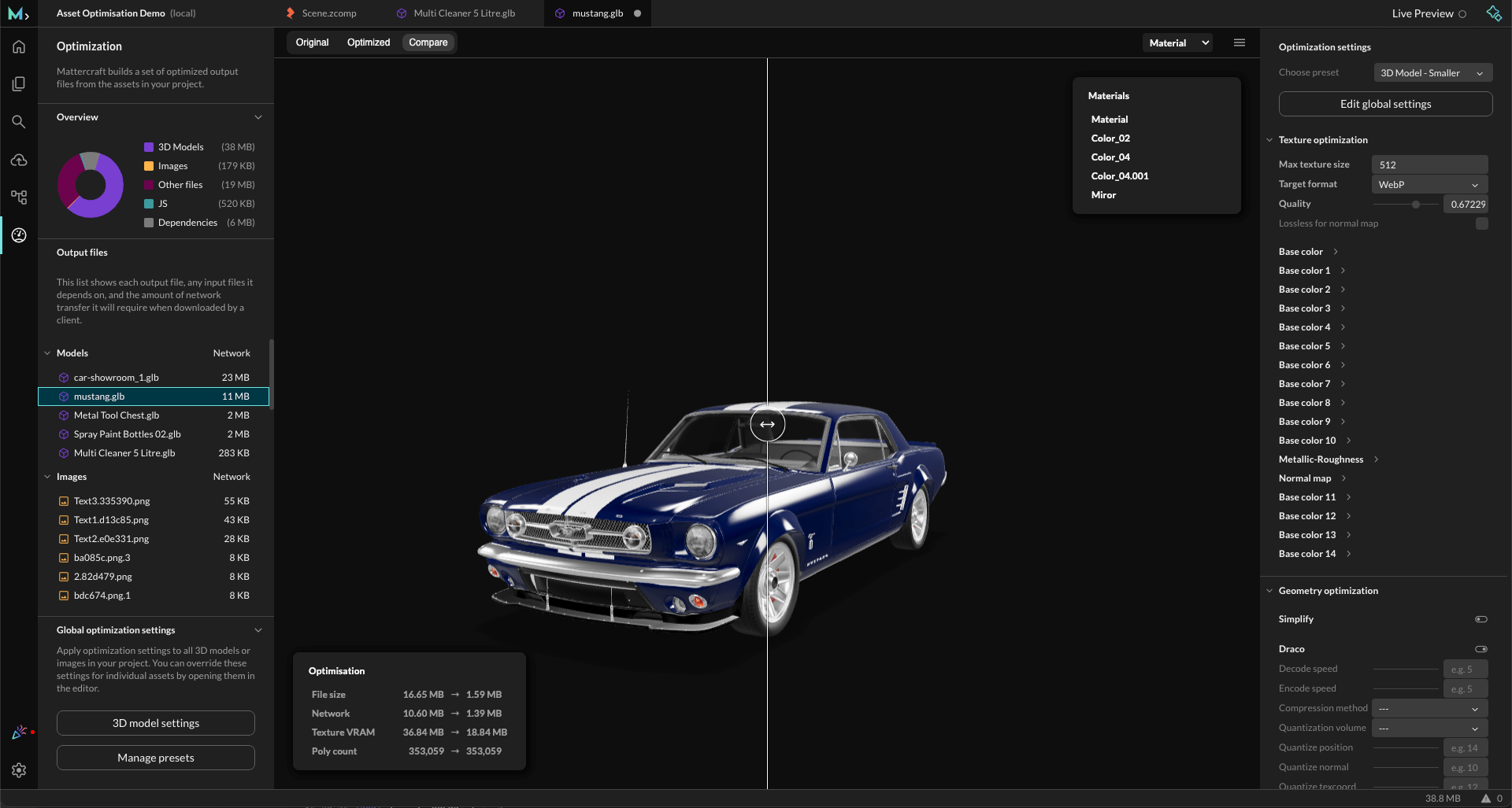

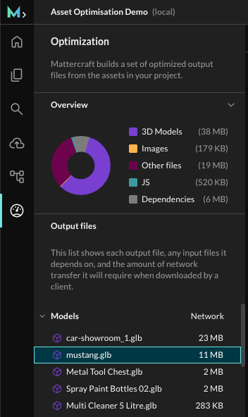

Once open, you’ll see:
  • A preview window where you can compare the original and optimized model (with a side-by-side slider).
  • An overview of all assets in your project, showing file sizes and network usage.

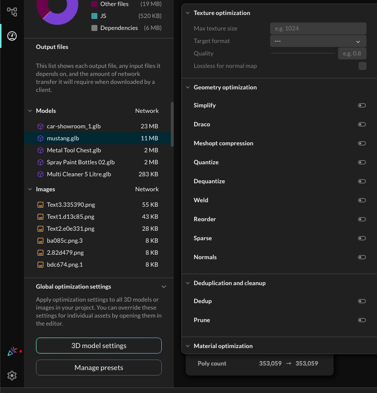

  • optimization settings for adjusting textures, geometry, and compression.
Texture optimization
  • Set a maximum texture size (e.g. 512px for mobile, 1024px for desktop).
  • Change the format (e.g. WebP) and adjust the quality slider.
  • Ensure normal maps are kept lossless for accuracy.
Geometry optimization
  • Apply Draco compression to significantly reduce file sizes.
  • Use mesh simplification and quantization to lower polygon count while maintaining quality.
  • Enable welding and reordering to optimize vertex data.
Global optimization
At the bottom of the sidebar you’ll find Global optimization settings, which apply your chosen rules across all 3D models and textures in the project.
Review results
The optimizer will show you exactly how much space and network bandwidth you’ve saved. For example:
  • File size reduced from 1.30 MB → 286 KB
  • Network size reduced from 1.26 MB → 282 KB

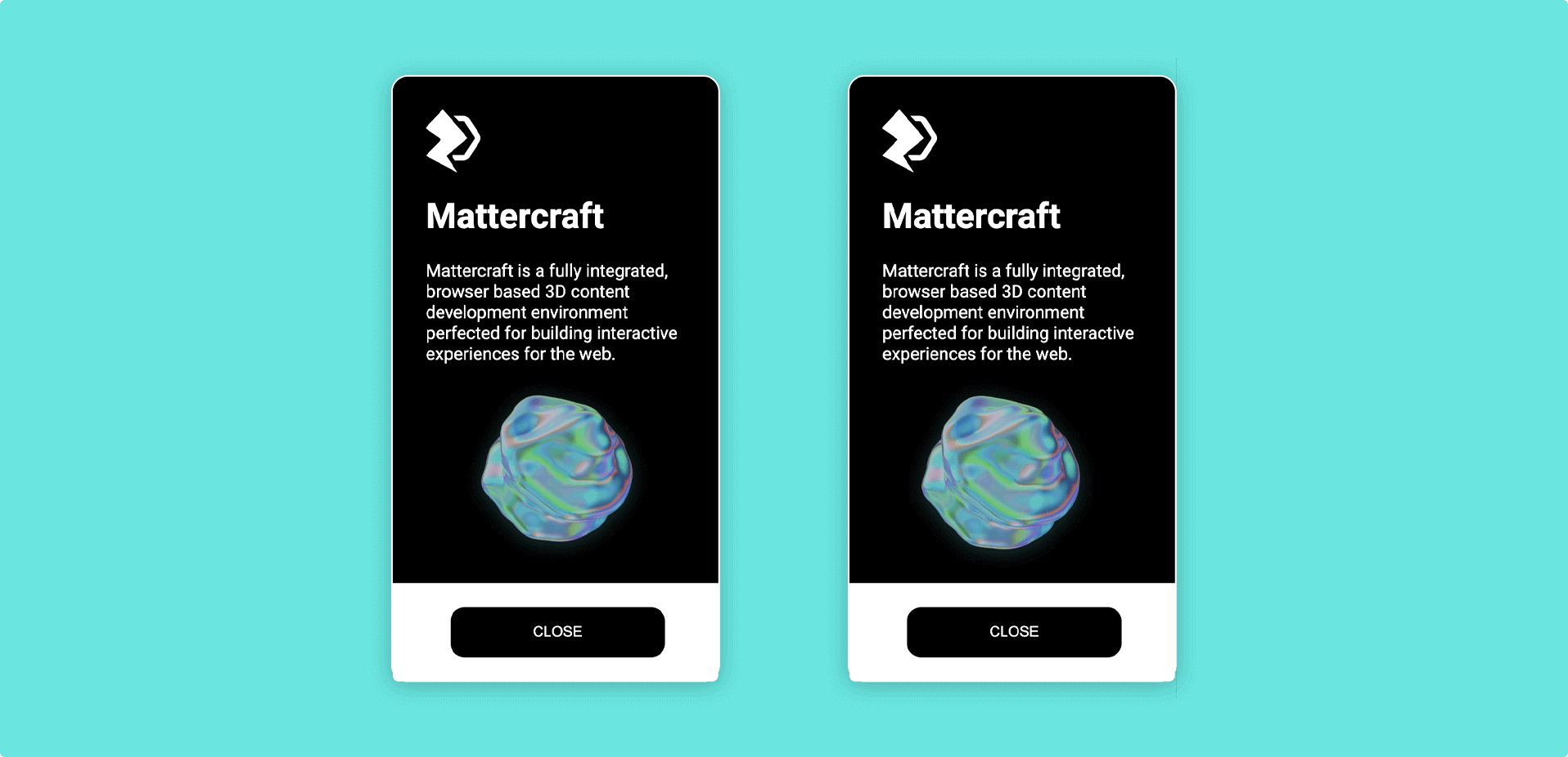

In the diagram above, the UI content on the left was exported at 1024px x 1024px, while the UI content on the right was exported at 512px x 512px. Though the latter produced a significantly lower file size, the reduction in image quality is not noticeable due to its small scale relative to the scene.

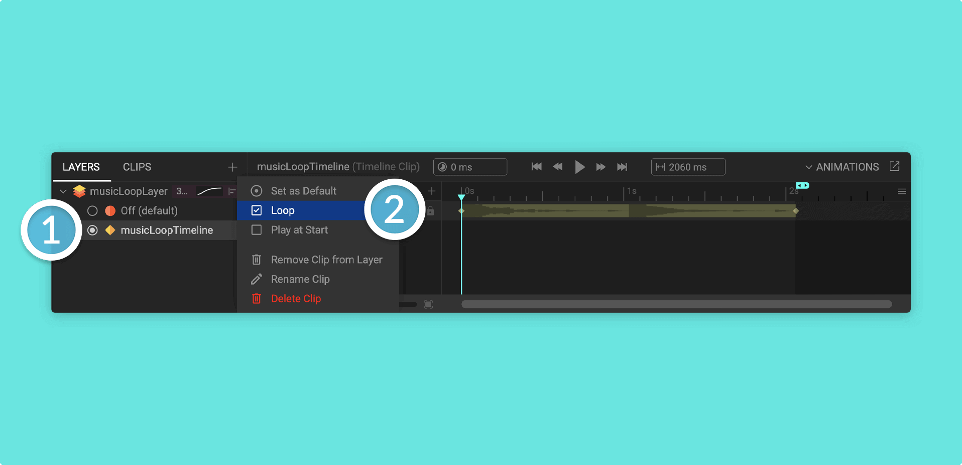

Trim long audio tracks
Long audio files that are comprised of a shorter, looping audio track can be exported as a single looped section instead. You can then use Mattercraft to loop the audio in your project.
