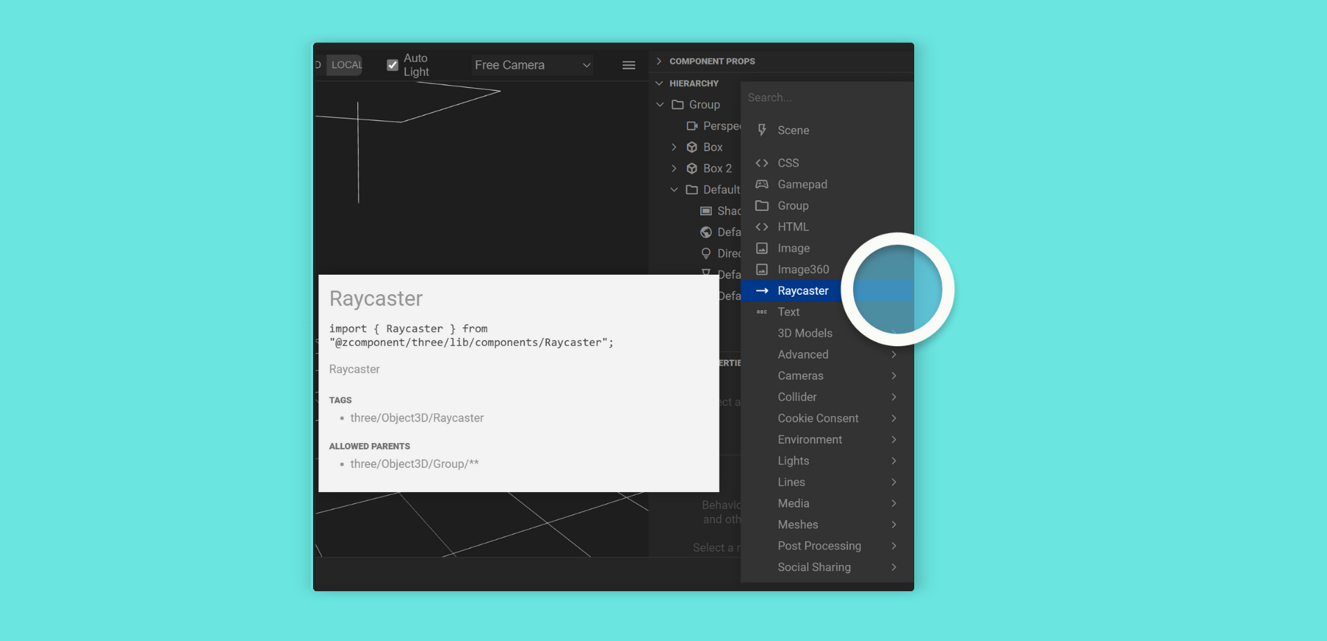

To add a raycaster, you can use the following instructions:
- Make sure nothing is selected in your Hierarchy Panel and click the + (plus) icon at the top of the panel, or right-click on Group in the Hierarchy Panel and click the three dots next to it
- Find the Raycaster component and add it to your Hierarchy

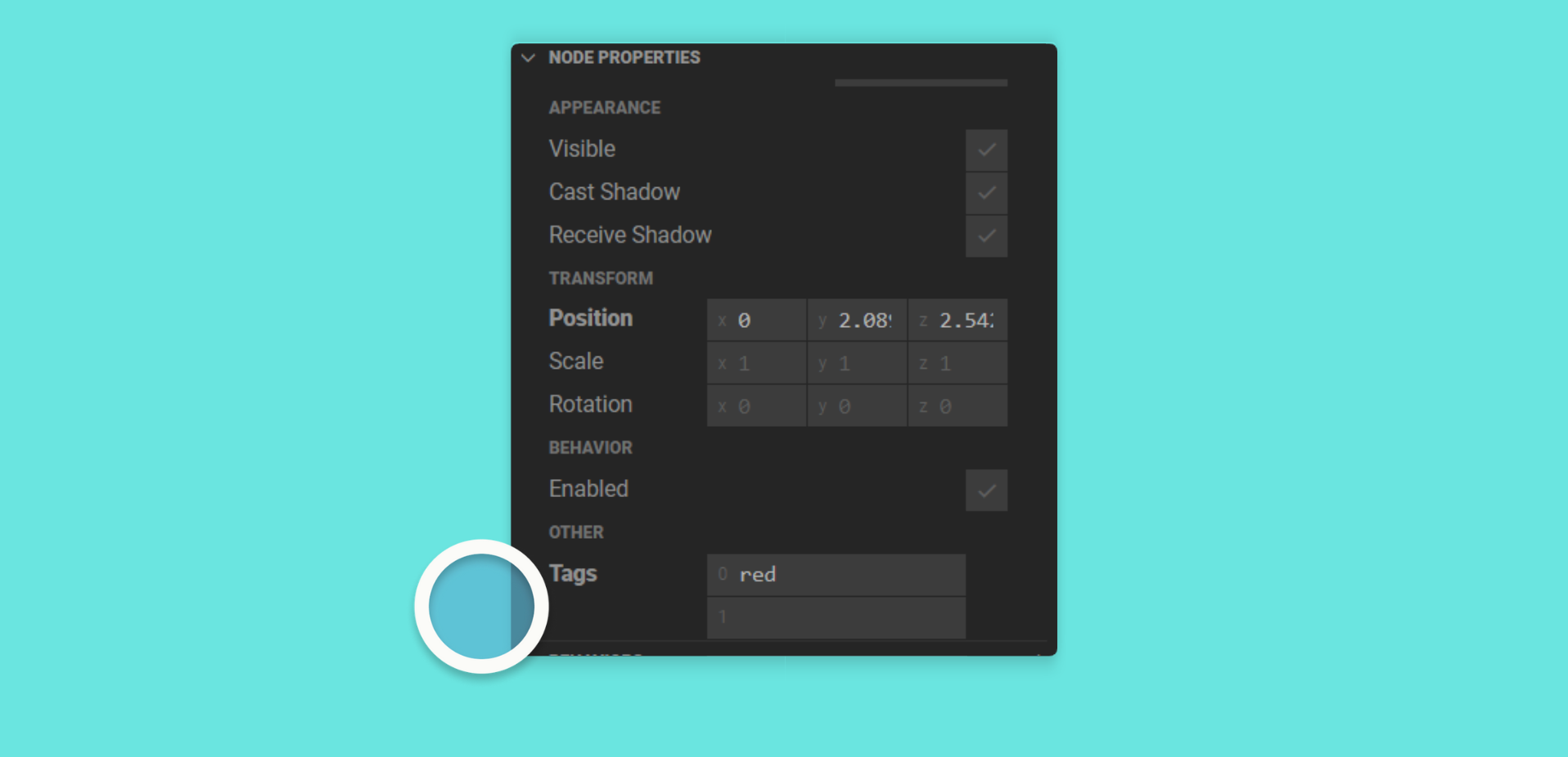

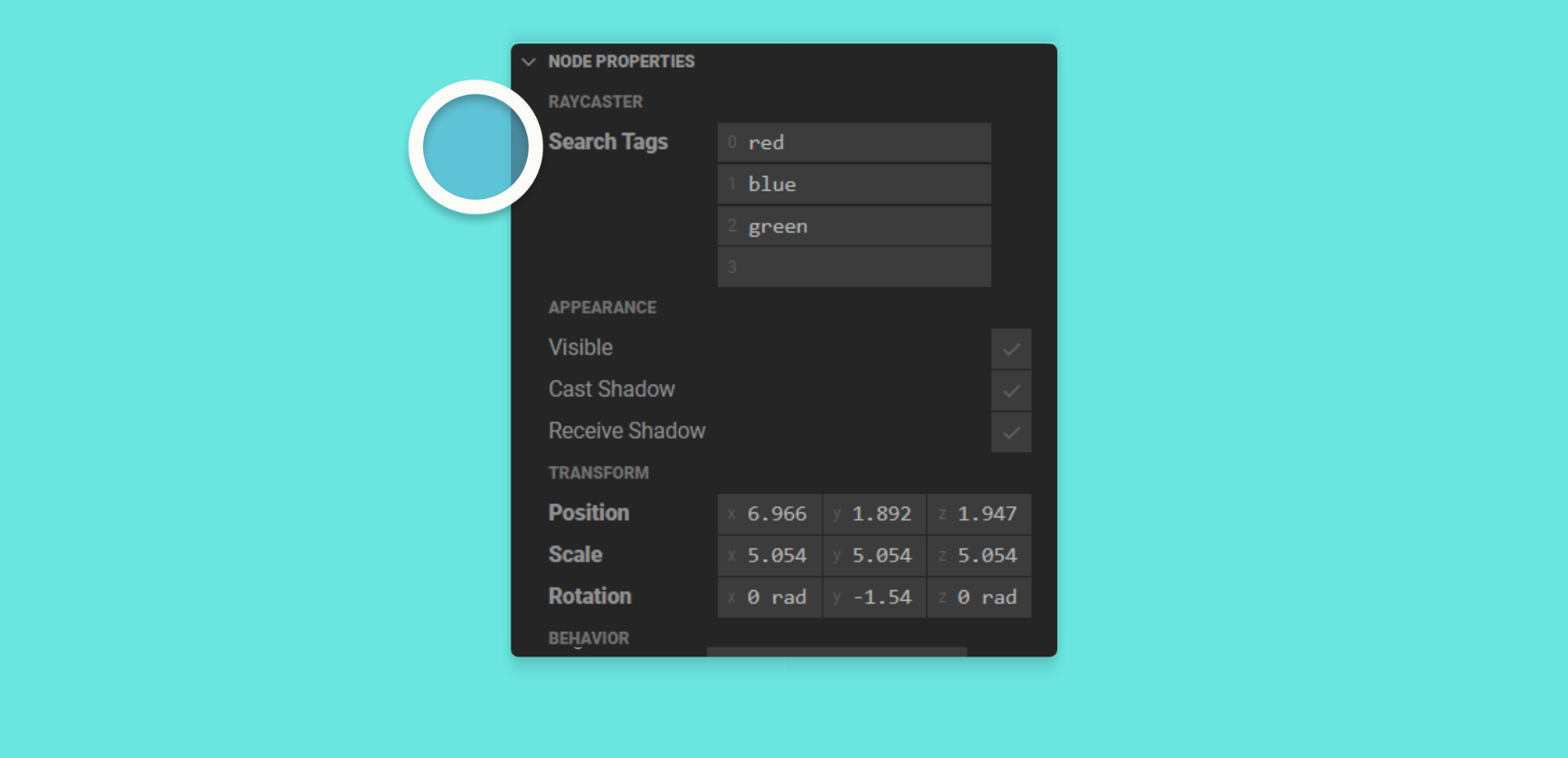

- Assign a Tag to the Raycaster’s
SearchTagsproperty. - Assign the same tag to the Node(s) you wish the Raycaster to interact with.
You can add as many tags as you want to this property. The corresponding nodes that have those tags will be the only nodes the raycaster will interact with.
Tags are not only used for specifying which node the raycaster will interact with, they are also useful in categorizing the interactions. So it’s recommended to make them descriptive and applicable to their use case.
