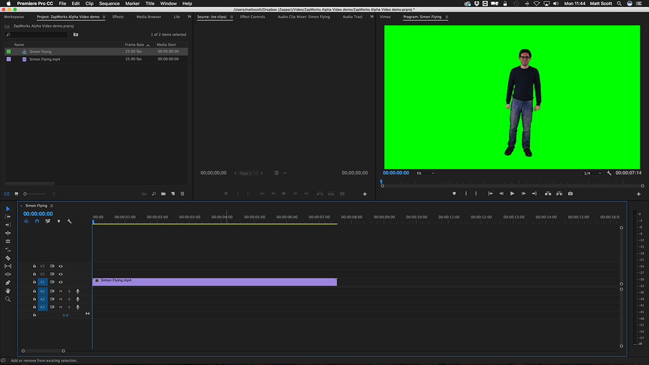

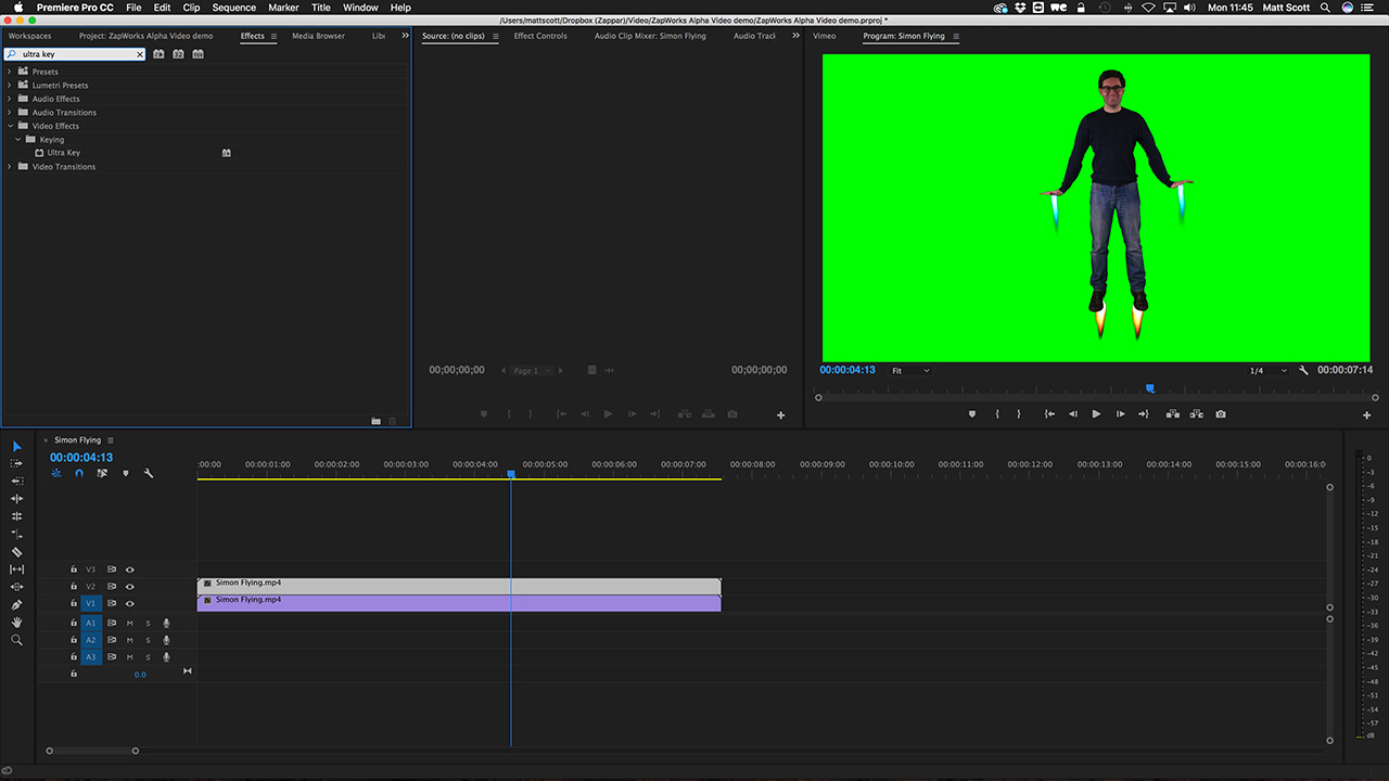

We start with our video; here we have some footage of Zappar’s co-founder, Dr. Simon Taylor pretending to fly around like a familiar superhero who has jets on his hands and feet.
We imported this footage, which has a green screen background, into Premiere Pro and created a new sequence from it.

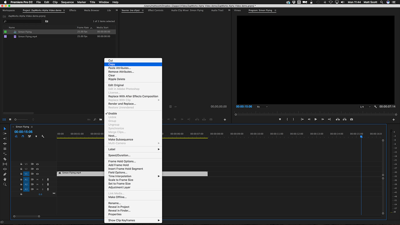

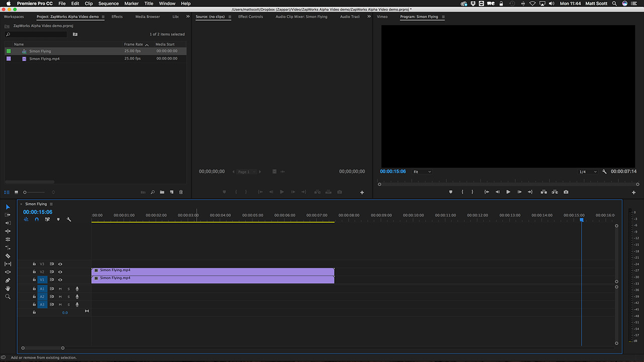

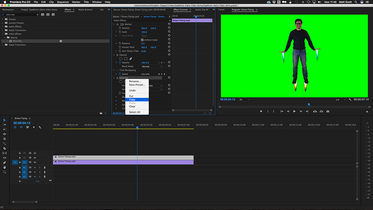

  1. Copy and paste this clip, and place the copy directly above the original in the timeline.

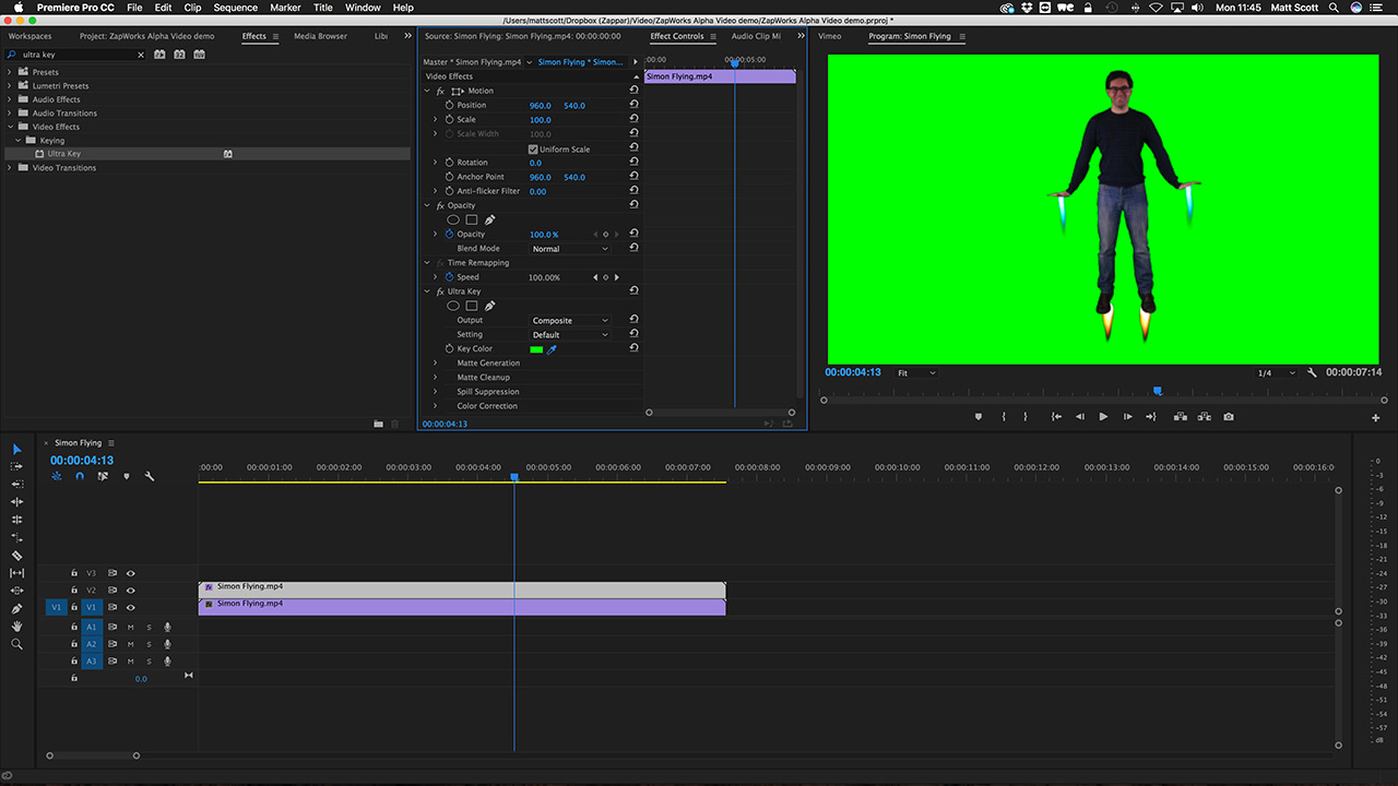

  1. Select the top clip and search for ‘Ultra Key’ in the Effects panel.
  1. Drag ‘Ultra Key’ onto the top clip and double-click to open the Effect Controls panel.
  1. Use the Eyedropper tool to select the Key Color - click on the green in the Program Monitor.
  1. Copy and paste the whole ‘Ultra Key’ effect onto the below clip.

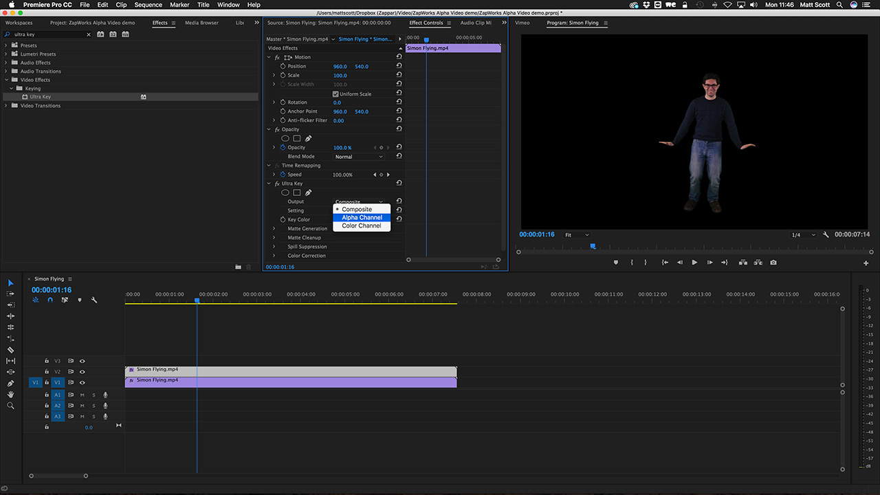

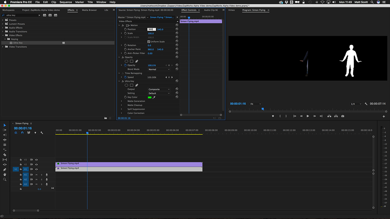

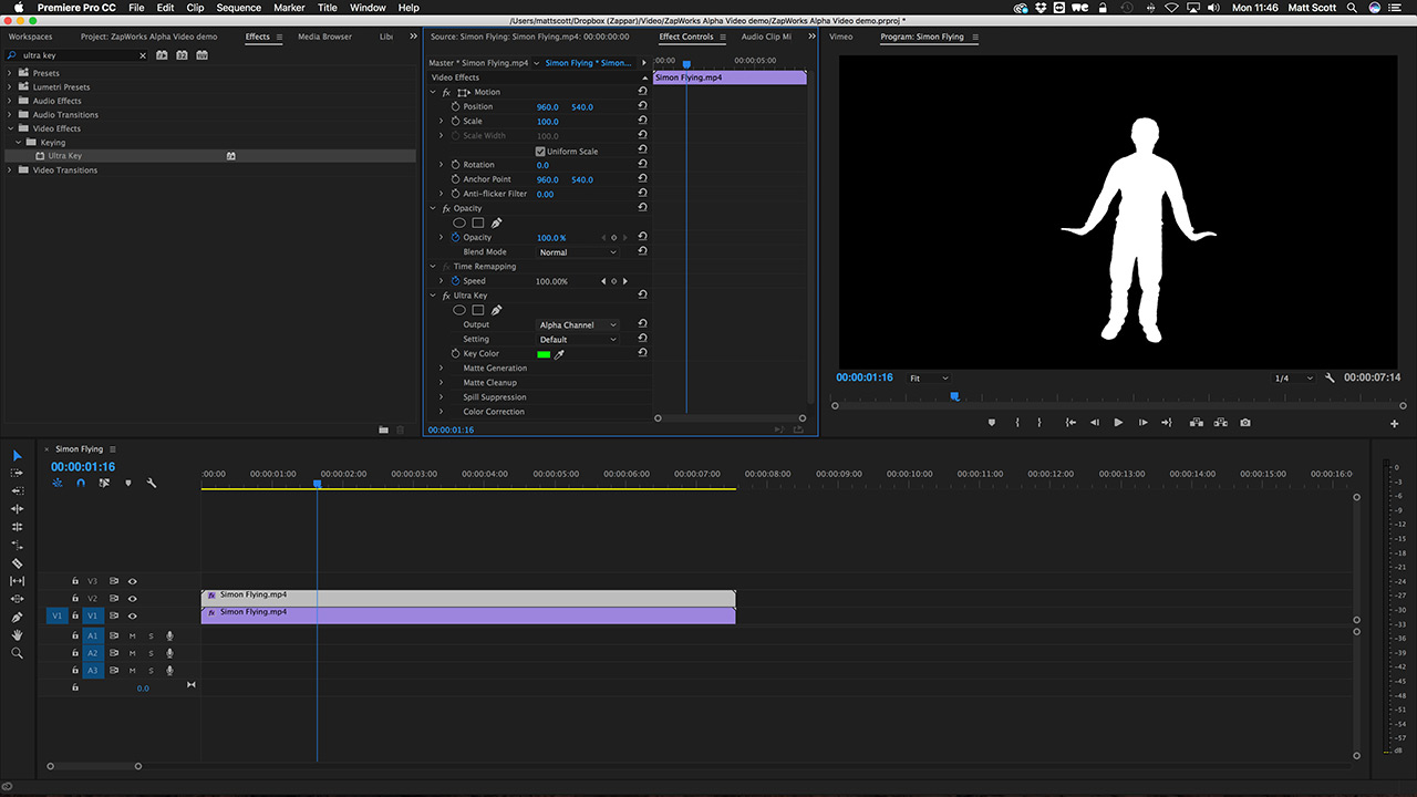

  1. Reselect the top clip, and in the Ultra Key Effect Control, select ‘Alpha Channel’ as the Output.
Simon becomes a solid white shape.

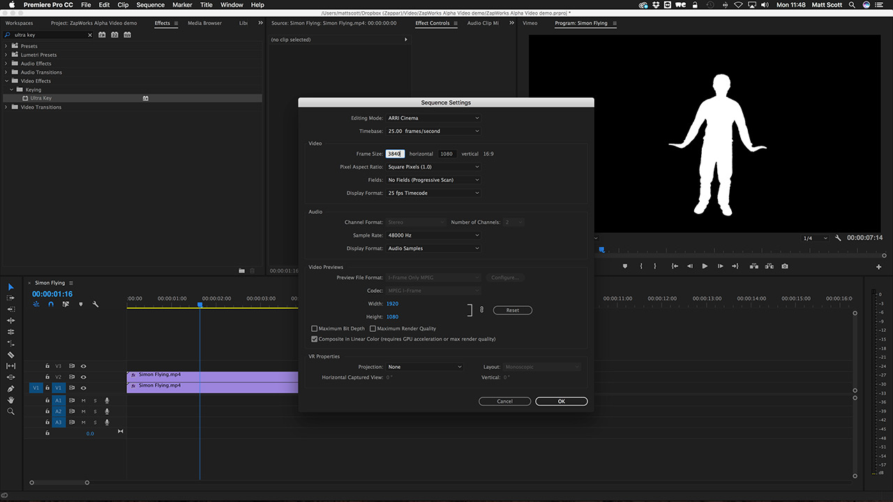

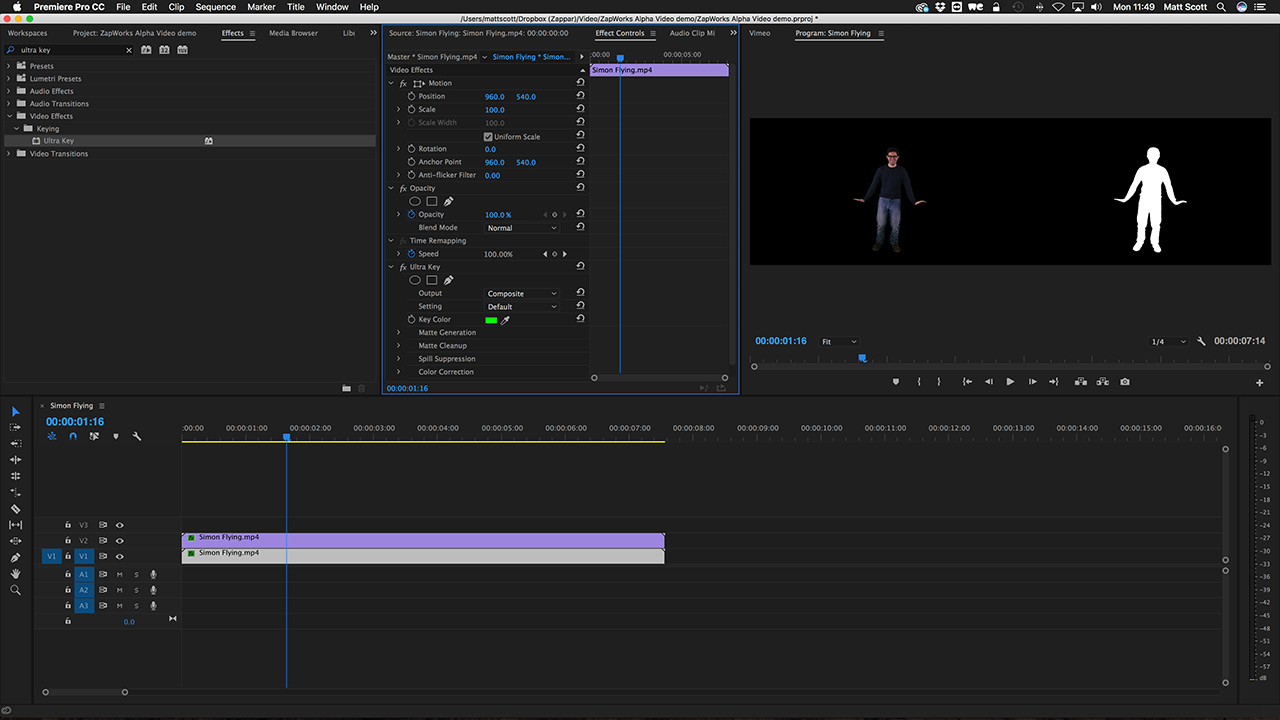

  1. We need to make the sequence we have been working in twice as wide so select Sequence > Sequence Settings and change the Horizontal Frame Size to double the width of your original video (3840 in our case as the video was 1920 pixels wide).

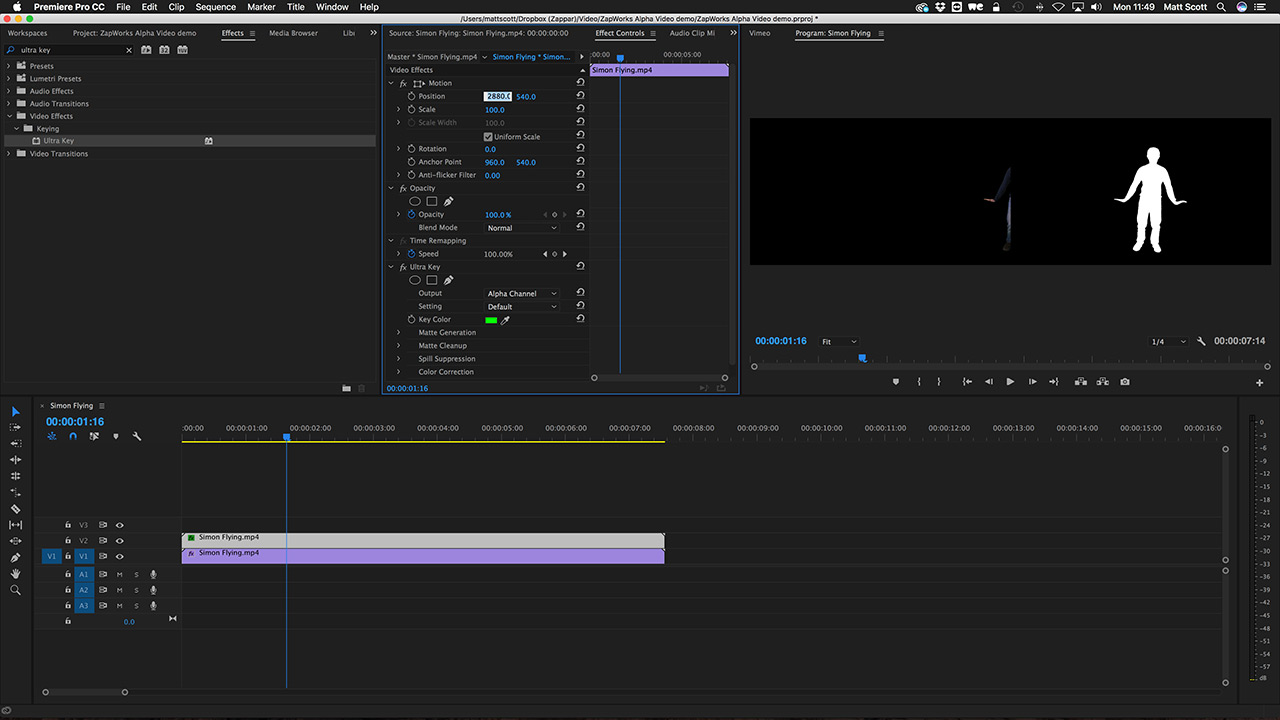

  1. We need to position the clips so they are side by side. The position needs to be pixel perfect, so don’t move the clips by eye. Double click the top clip in the timeline to open the Effect Controls panel. Change the horizontal position to 75% of the width of the sequence (2880 in our case). The solid white version of Simon should move over to the right in the Program Monitor.
  1. Double click the bottom clip, and change the horizontal position to 25% of the width of the sequence (960 in our case).
The full-color version should move over to the left.

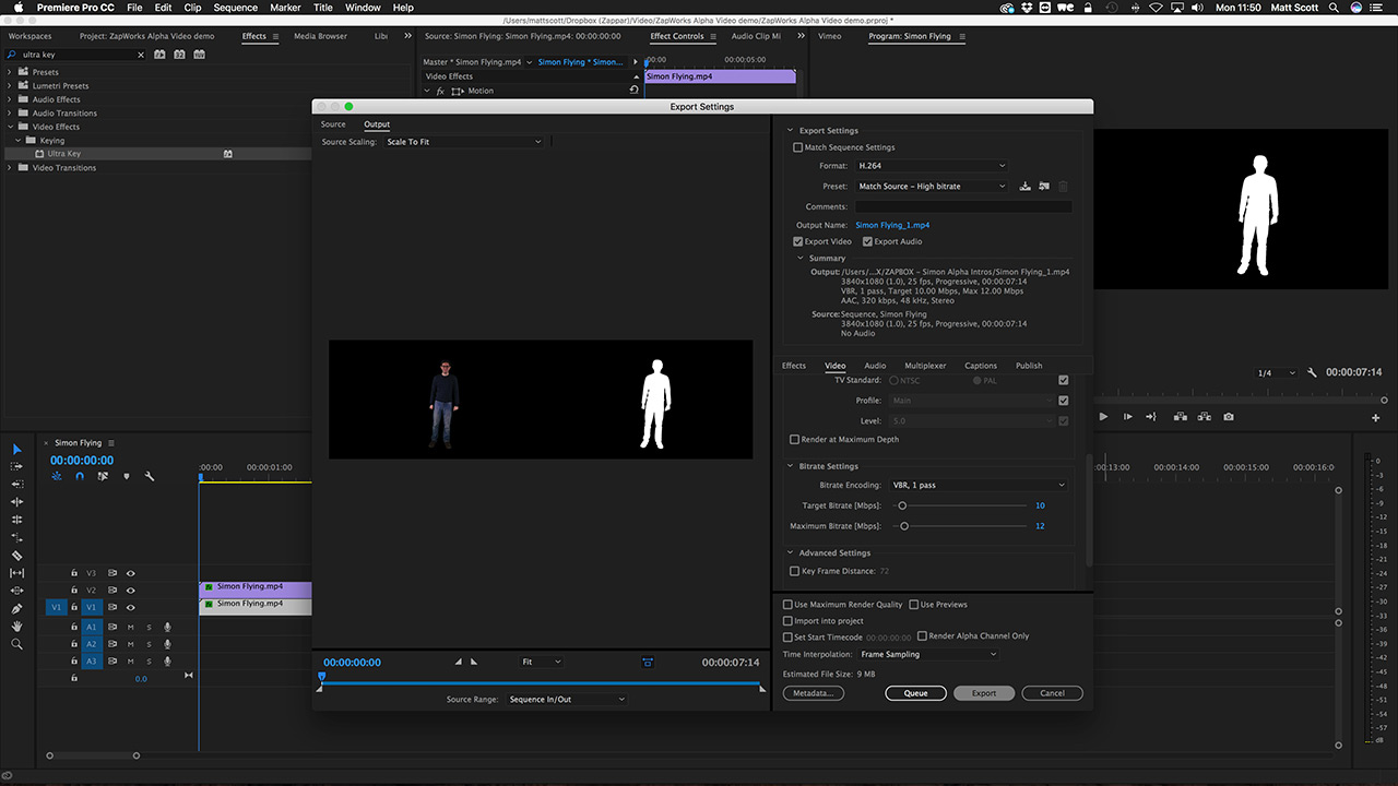

  1. Export the video as an h.264 mp4 file.

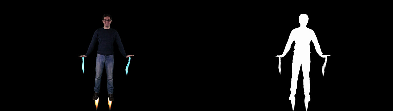

Below you can see the before and after of this process.
Before:
After:

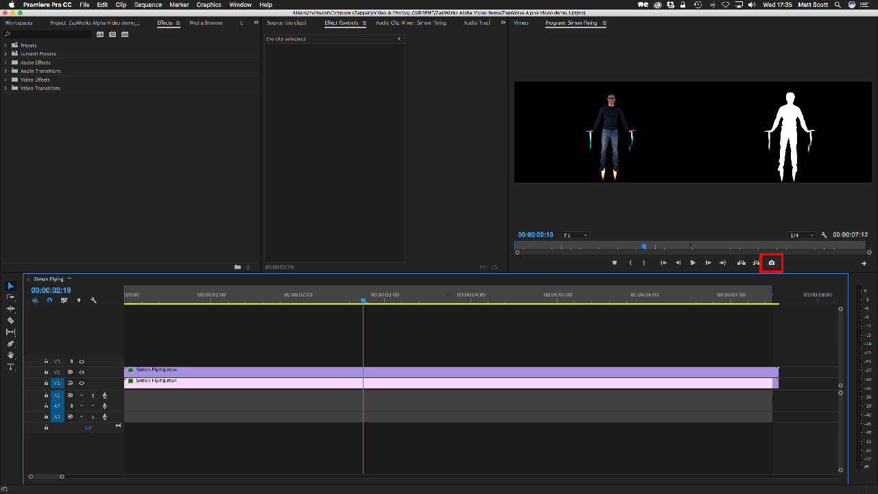

  1. The final preparation step is to grab a single frame snapshot of the video to be used as a reference when creating our experience within ZapWorks Studio. In Premiere, you can create a snapshot by clicking the camera icon in the Program Monitor.
Snapshot:
