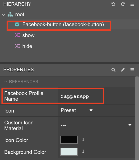

  1. Drag the Facebook subsymbol from Symbol Definitions, into the Hierarchy in the parent symbol.
  2. Select the Facebook node and add a link to a valid Facebook profile in the Facebook Profile Name property. This property is pre-filled with https://www.facebook.com/ so this portion of the URL should be omitted. The example shown below will launch https://www.facebook.com/ZapparApp/.
The Facebook Button symbol has five custom properties that can be edited:
Property Description
Facebook Profile Name Sets the Facebook URL to launch.
Icon Sets whether to use the button’s preset icon or a custom one.
Custom Icon Material Sets the image to use as the button’s icon, if Icon is set to Custom.
Icon Color Sets the color of the button icon.
Background Color Sets the color of the button background.
To use a custom icon instead of the default graphic, change the Icon property to custom and set the Custom Icon Material property to your imported image.
