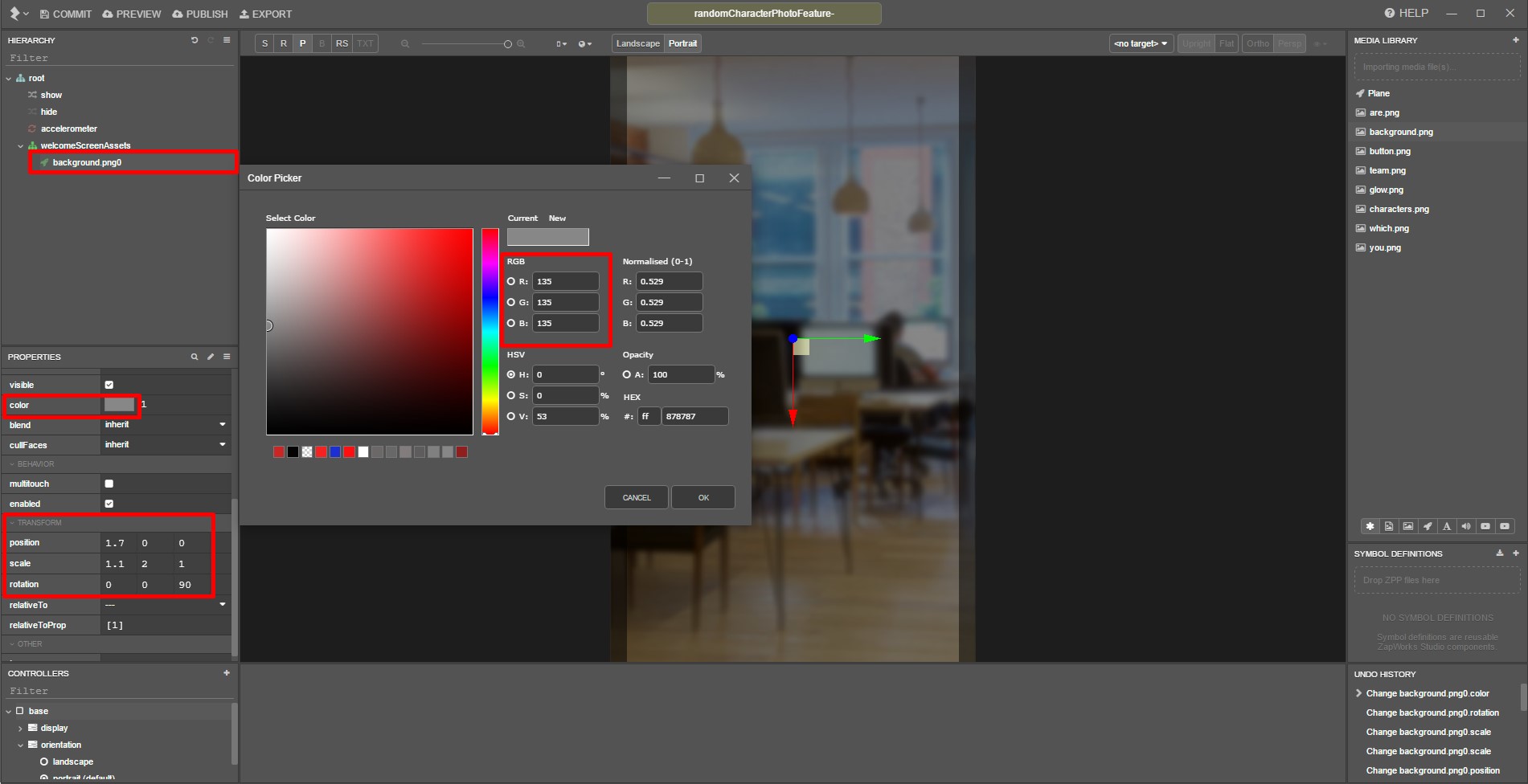

3.2) Setting the transforms for the ‘background’ node
Drag the ‘background’ image file from the ‘Media Library’ into your hierarchy, within the ‘welcomeScreenAssets’ group.
In its ‘Properties’ panel, set the:
| position | 1.7 | 0 | 0 | |
| scale | 1.1 | 2 | 1 | |
| rotation | 0 | 0 | 90 |
Darken the image by changing its ‘color’ RGB values to [135, 135, 135].

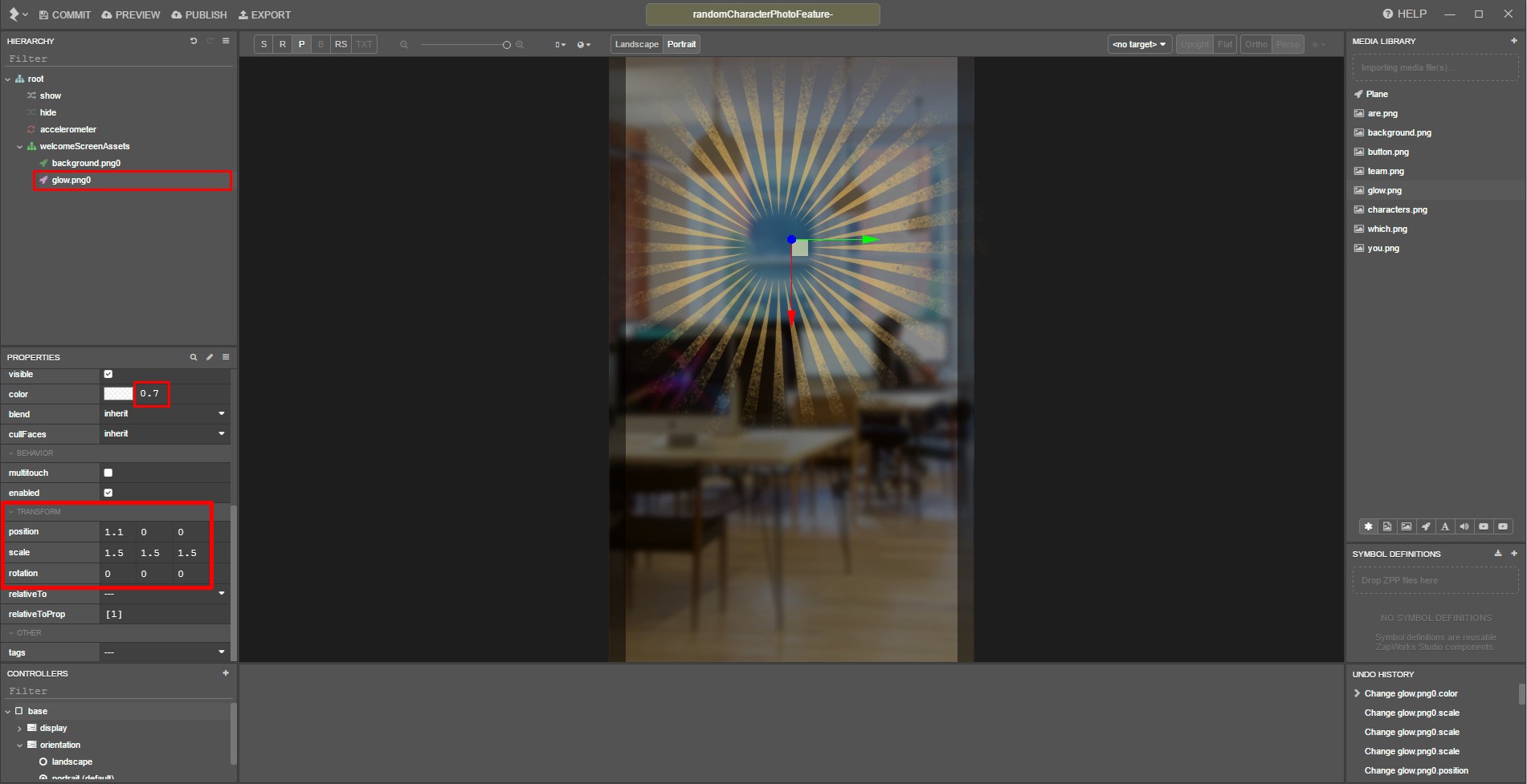

3.3) Setting the transforms for the ‘glow’ node
Drag the ‘glow’ media file into the same group, beneath the previous node and set the:
| position | 1.1 | 0 | 0 | |
| scale | 1.5 | 1.5 | 1.5 | |
| rotation | 0 | 0 | 0 |
Change its color opacity setting to 0.7.

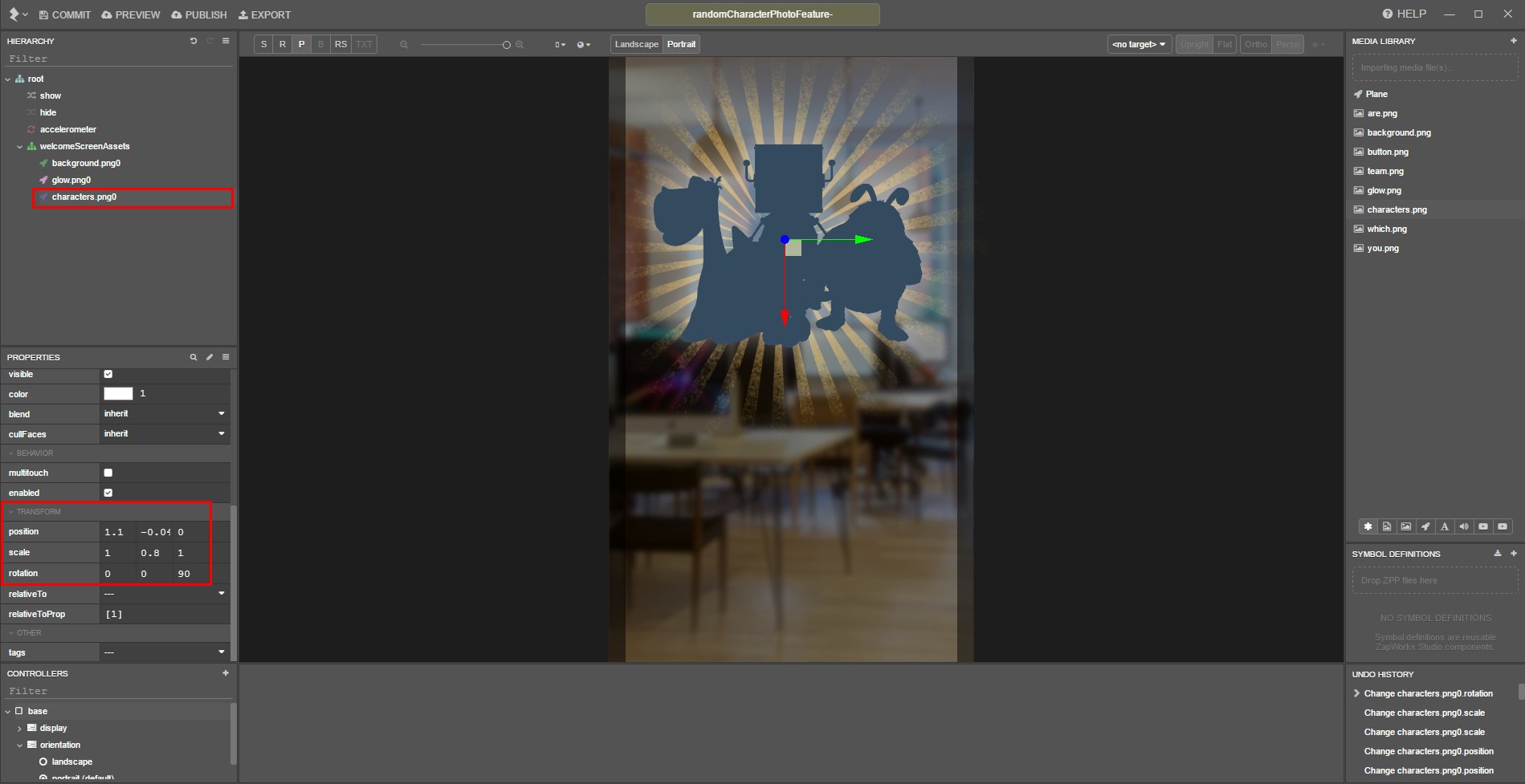

3.4) Setting the transforms for the ‘characters’ node
Drag the ‘characters’ media file into the ‘welcomeScreenAssets’ group, beneath the previous node and set its:
| position | 1.1 | -0.04 | 0 | |
| scale | 1 | 0.8 | 1 | |
You’ll want to keep an eye on the nodes’ position in the hierarchy. Nodes later in the hierarchy will be displayed over objects earlier in the hierarchy in the 3D view.

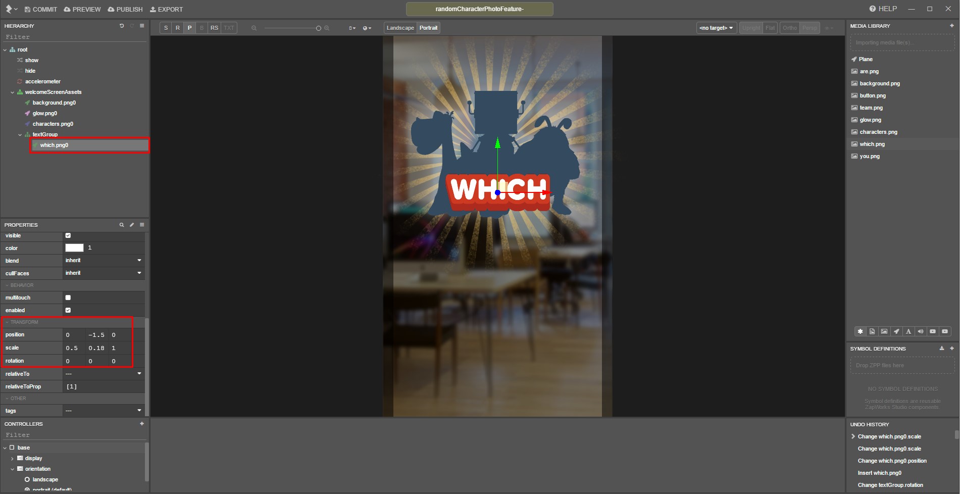

4.1) Setting the transforms for the ‘which.png0’ node
Add the ‘which.png’ media file to the group and set its:
| position | 0 | -1.5 | 0 | |
| scale | 0.5 | 0.18 | 1 | |

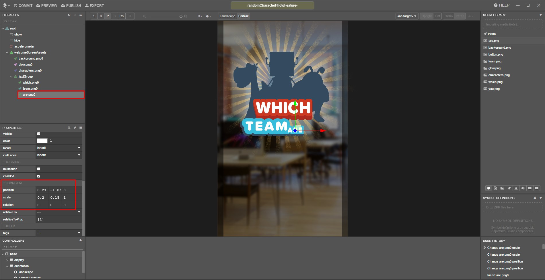

4.3) Setting the transforms for the ‘are.png0’ node
Add the ‘are.png’ media file to the group, beneath the ‘team.png0’ node and set its:
| position | 0.21 | -1.86 | 0 | |
| scale | 0.2 | 0.15 | 1 | |

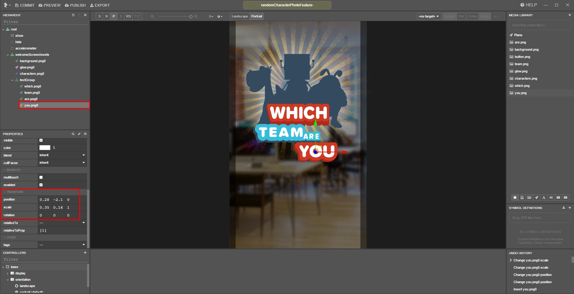

4.4) Setting the transforms for the ‘you.png0’ node
Add the ‘you.png’ media file to the group, beneath the ‘are.png0’ node and set its:
| position | 0.28 | -2.1 | 0 | |
| scale | 0.35 | 0.16 | 1 | |

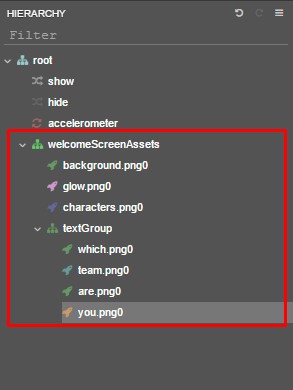

Your hierarchy should look like this:

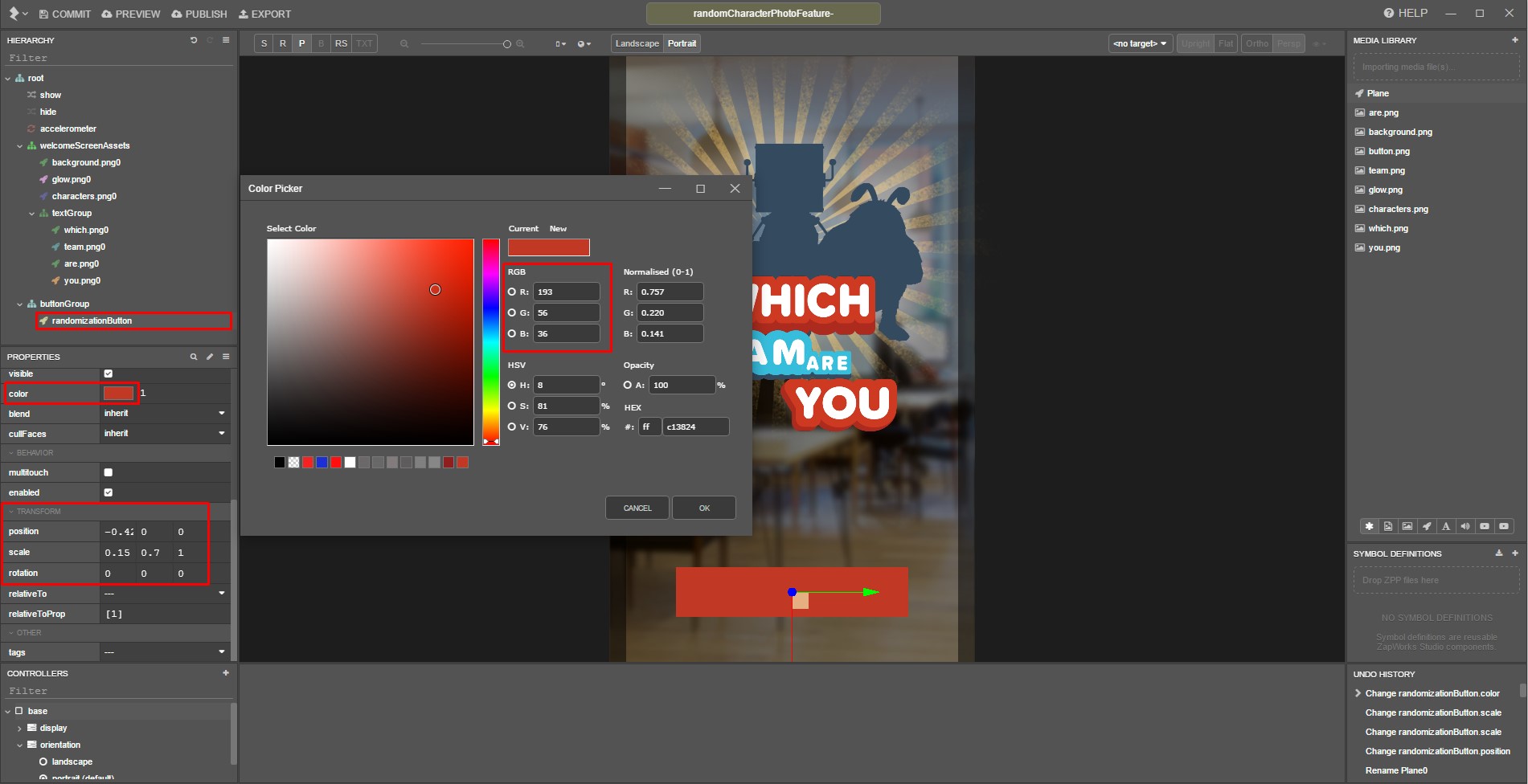

5.2) Setting the transforms for the ‘randomizationButton’ node
Right-click the plane node and select ‘Rename’, then rename it to ‘randomizationButton’.
Change its:
| position | -0.42 | 0 | 0 | |
| scale | 0.15 | 0.7 | 1 | |
Select the color box in the node’s ‘color’ property and change the RGB values to [193, 56, 36].

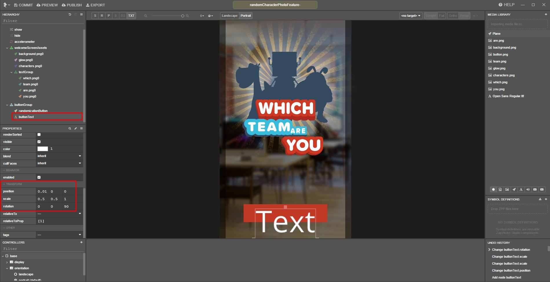

5.3) Adding text to the button

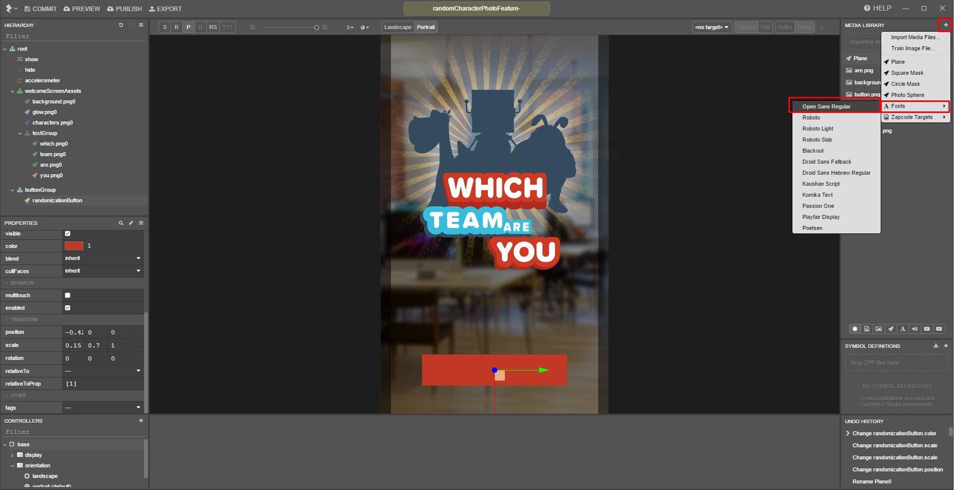

Import a font to your ‘Media Library’ by clicking on the + symbol in the panel and selecting ‘Fonts > Open Sans Regular’.
Right click the ‘buttonGroup’ node and select ‘New > Text’, and rename the new text node to ‘buttonText’.
Change its:
| position | 0.01 | 0 | 0 | |
| scale | 0.5 | 0.5 | 1 | |
Make sure the text node is beneath the ‘randomizationButton’ node in the hierarchy or it will be obscured.
Don’t worry about the size of the text for now as it will be resized once we input our text.
Change its text property to ‘LET’S FIND OUT’, and make sure its font property is set to ‘Open Sans Regular’.

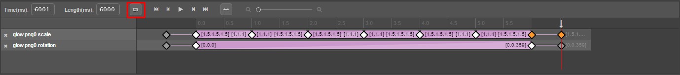

Click and drag to select the keyframes at 6000 and 6001, then right click and select ‘Make Link > with left value’.
Lastly, click on the loop option found to the right of the timeline’s ‘Length (ms)’ property, to make the timeline loop.
The glow animation is now set up, you can preview it by clicking on the play button in the timeline controls.

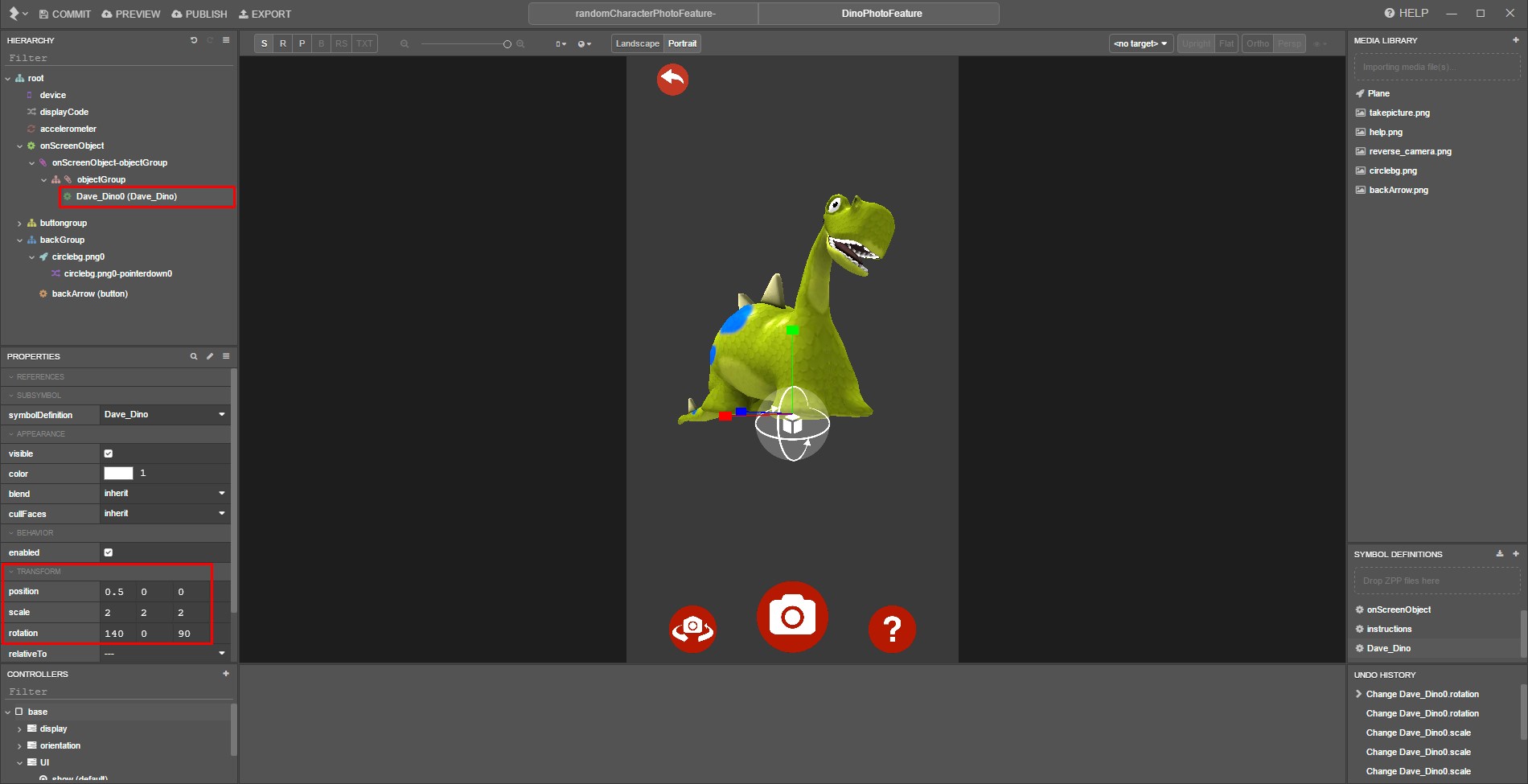

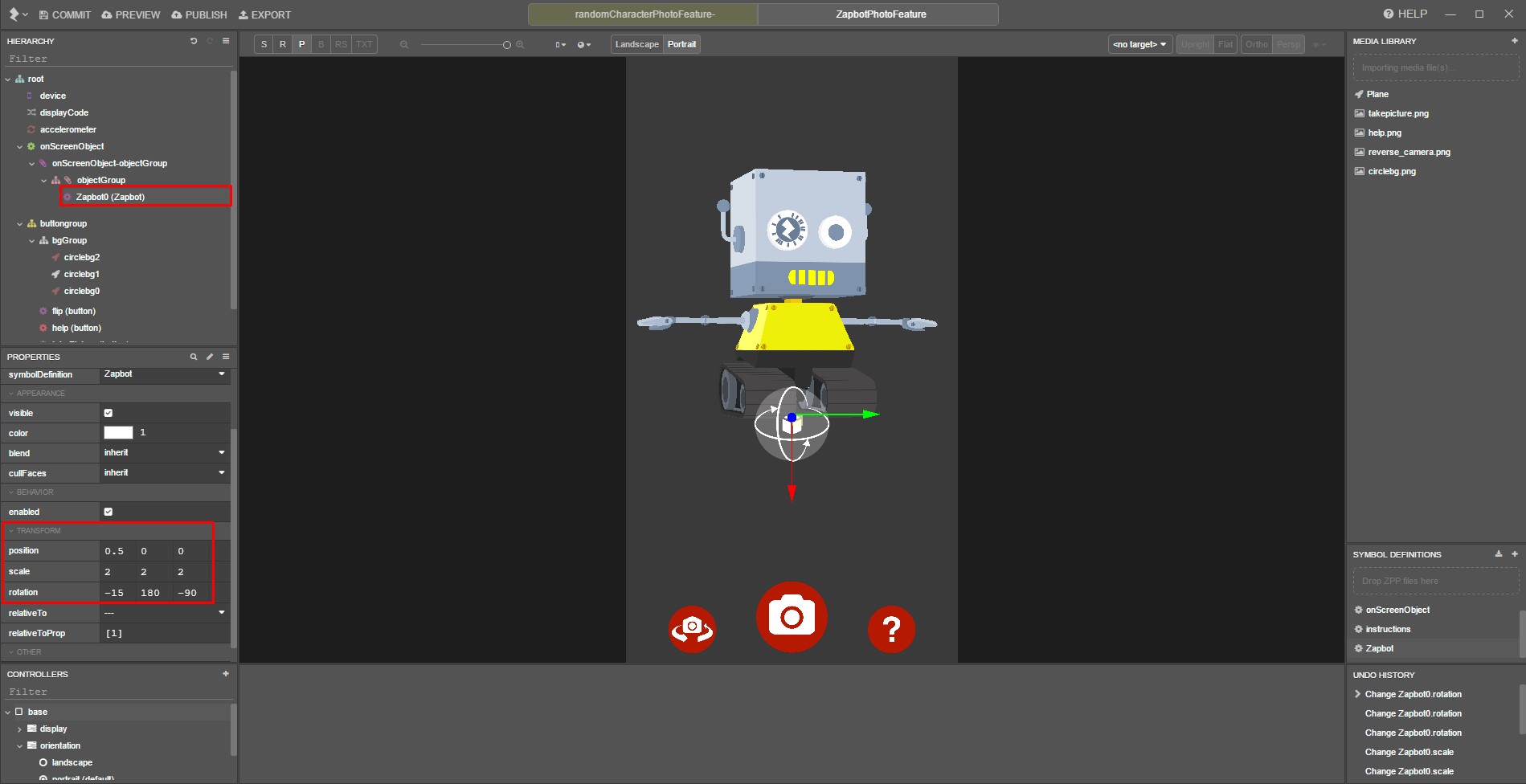

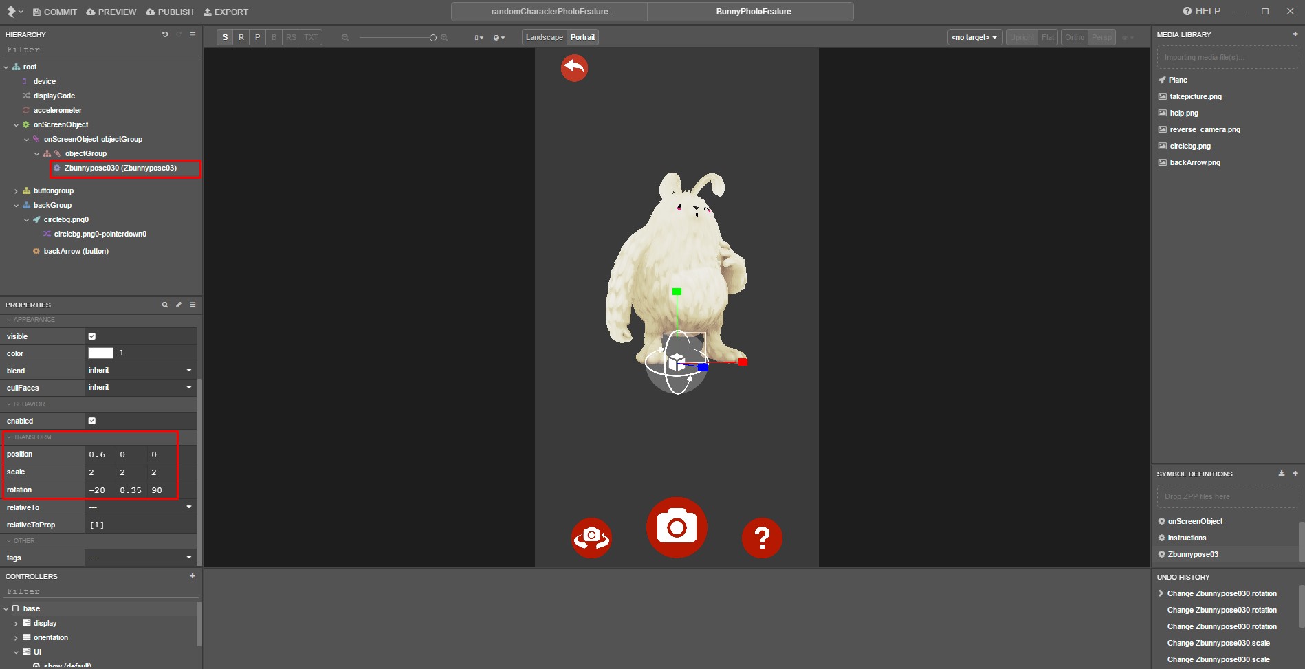

Import the ‘Zapbot.pod’ file from within the ‘3D Models > Zapbot’ inside the assets download folder by dragging the file into your ‘Media Library’.
You can click and drag the model’s textures files from the folder into the texture pop-up, to assign them automatically.
Drag the resulting model’s symbol definition into the hierarchy under ‘onScreenObject > onScreenObject-objectGroup > objectGroup’.
Set the model’s transforms to:
| position | 0.5 | 0 | 0 | |
| scale | 7 | 7 | 7 | |
| rotation | -15 | 180 | -90 |
Due to changes in the 3D import process, the scale applied to the model in the image below is now outdated, please use the values provided above.

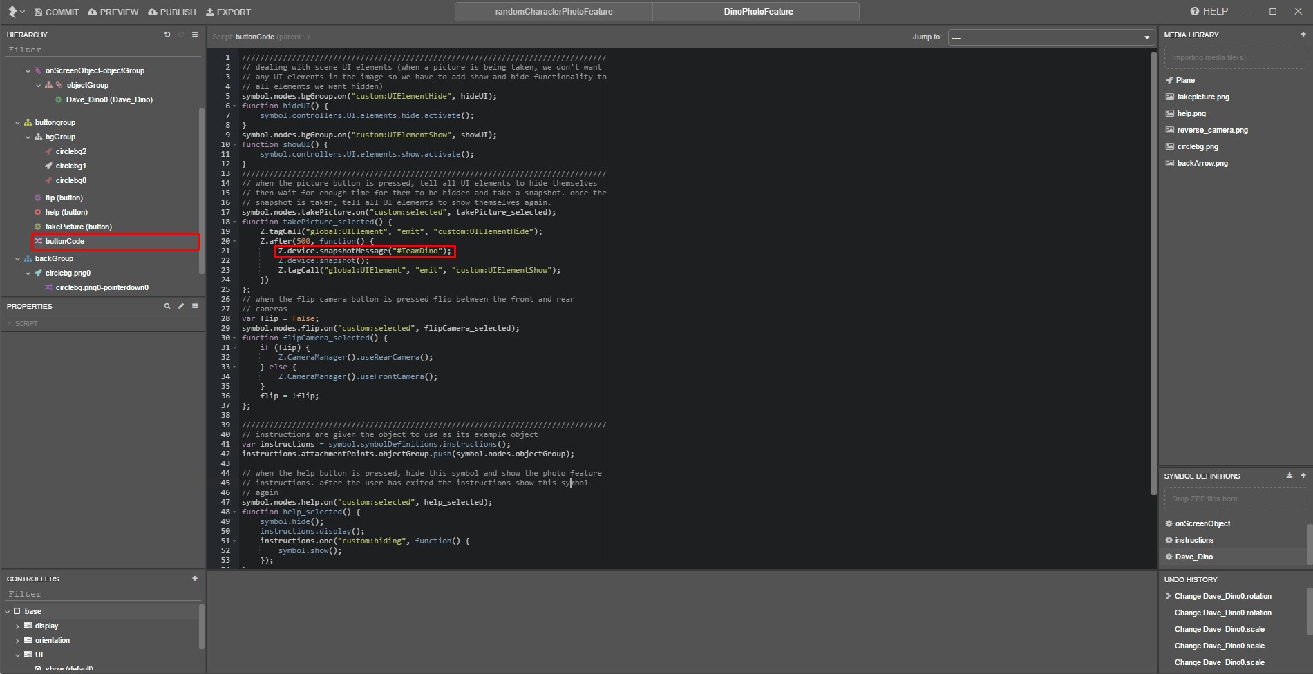

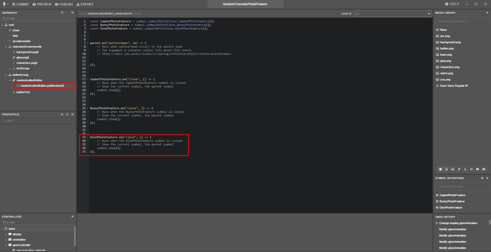

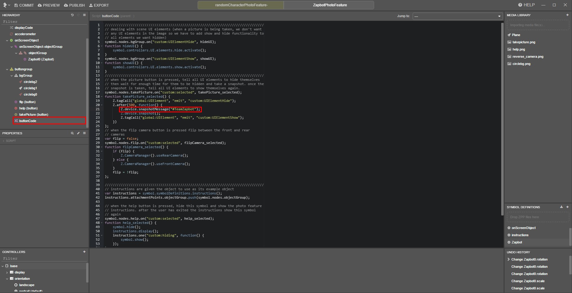

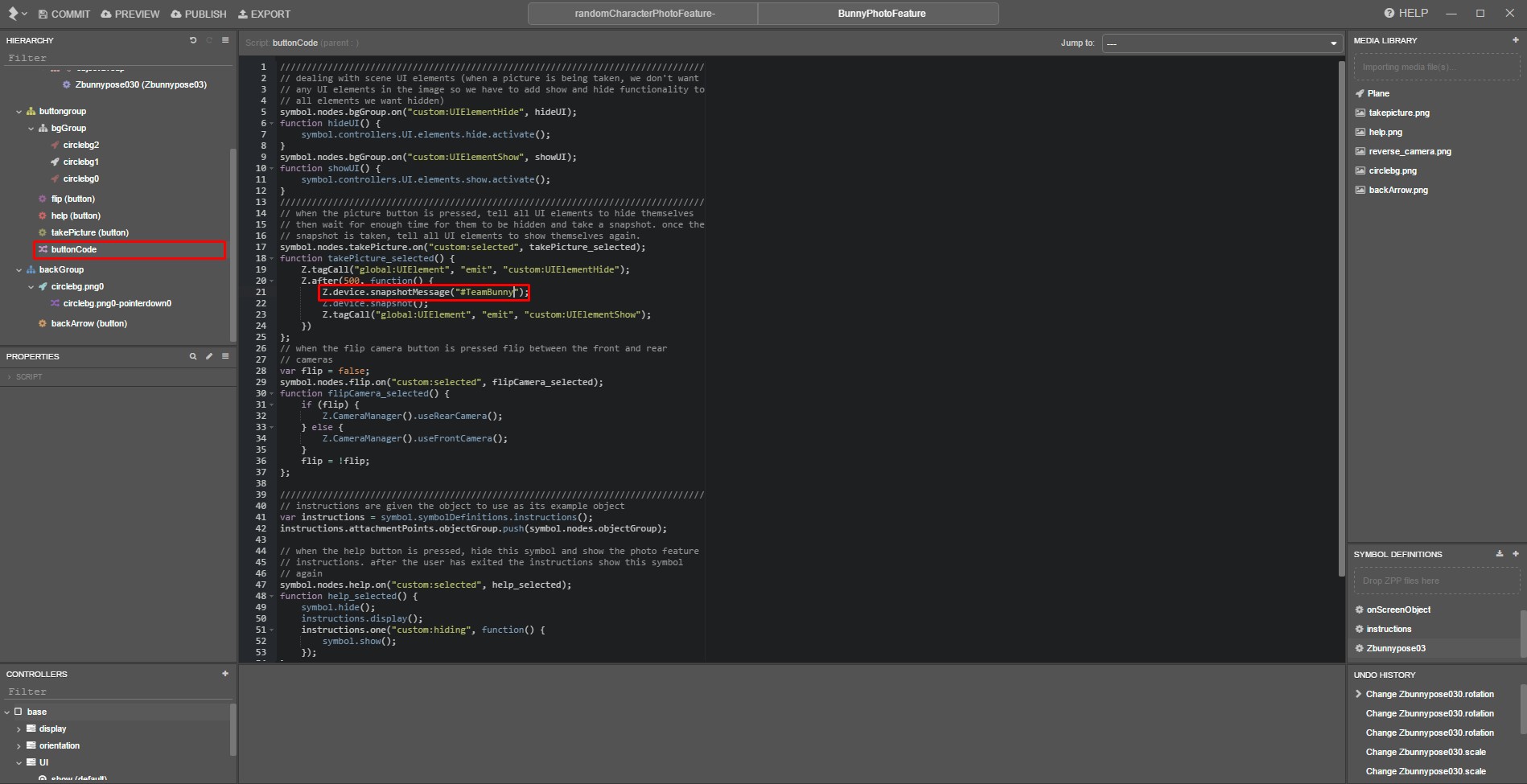

Select the ‘buttonCode’ script node within the hierarchy, and find Z.device.snapshot(); on line 21 within the script.
In a new line directly before it, add the following line of code:
Z.device.snapshotMessage("#TeamZapbot");
This will pre-fill the social media share field with our message.
Some social media platforms will ignore this pre-filled message and display a blank field.

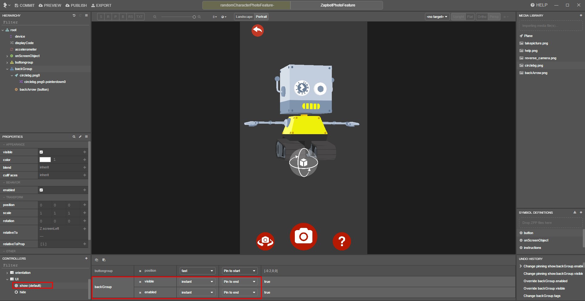

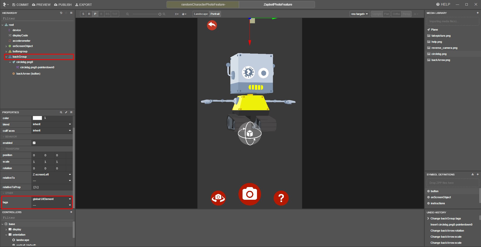

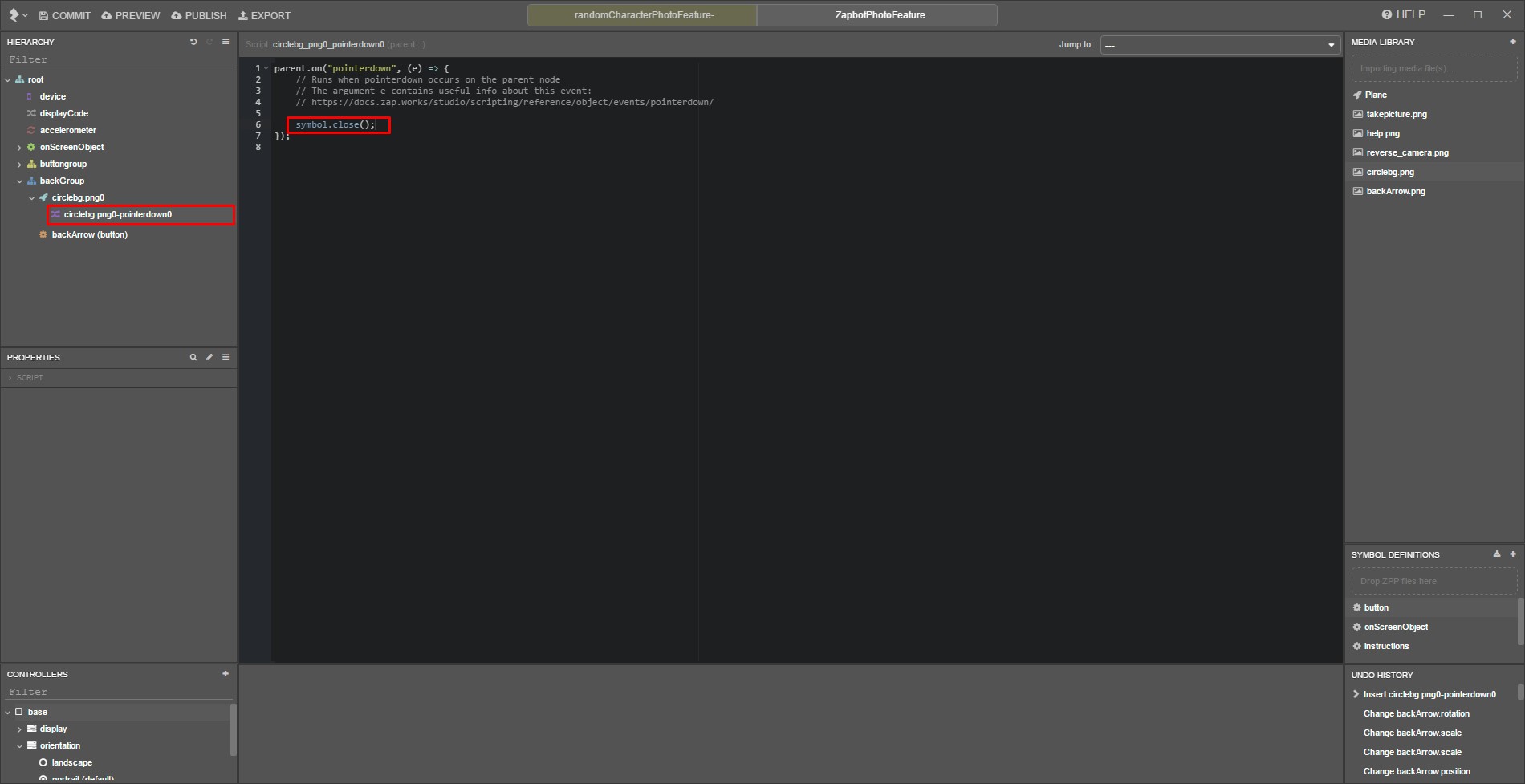

14) Adding a back button to the Zapbot photo feature

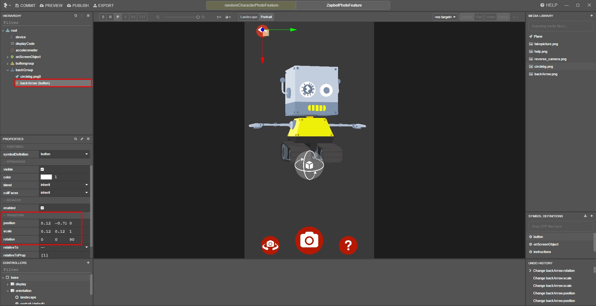

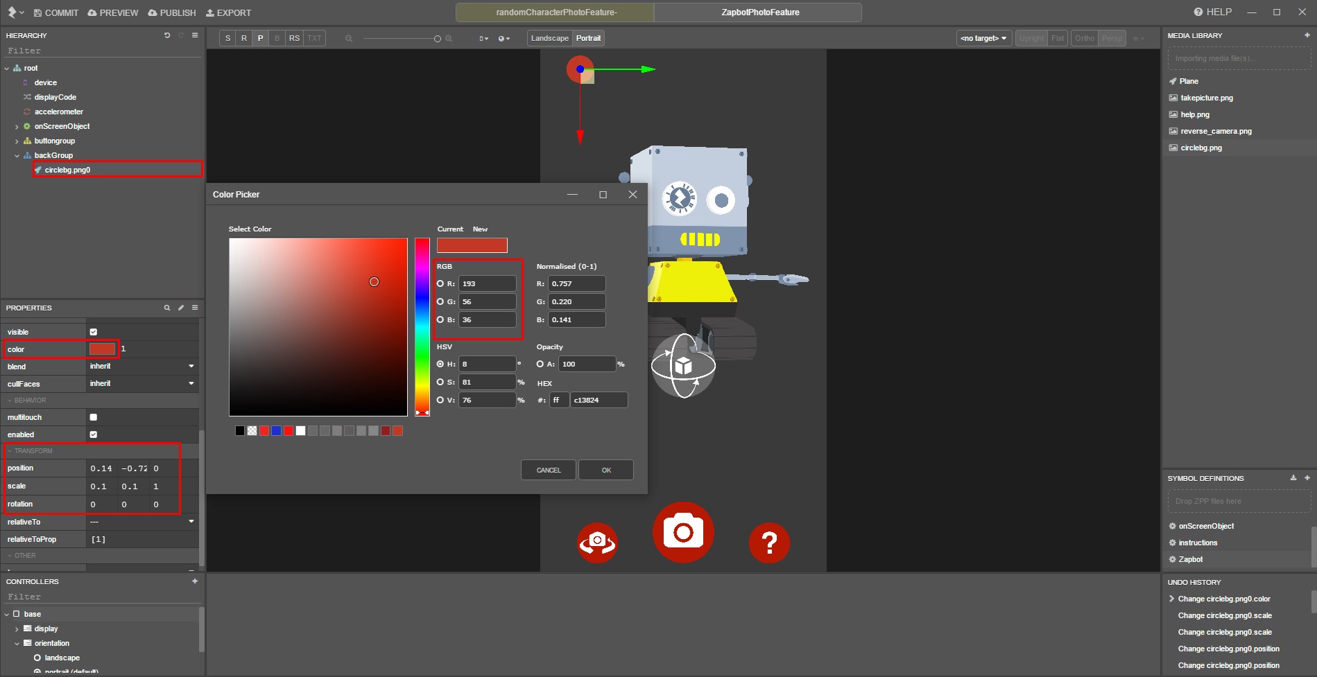

While still in the ‘ZapbotPhotoFeature’ symbol, import the ‘backArrow’ image file from your downloads folder to your media library.
Select the root node in the hierarchy, right click and select ‘New > Group’.
Rename the group to ‘backGroup’.
In the ‘Properties’ panel, change its ‘relativeTo’ property to ‘Z.screenLeft’.
The photo feature template already contains an image called ‘circlebg.png’ in the Media Library, which we’ll be reusing for our own button.
Drag this file into ‘backGroup’.
Change the node’s transfoms to:
| position | 0.14 | -0.72 | 0 | |
| scale | 0.1 | 0.1 | 1 | |
The photo feature template also contains an existing ‘button’ symbol which we can use.
Drag the ‘button’ subsymbol from your ‘Symbol Definitions’ panel into ‘backGroup’, beneath the ‘circlebg.png0’ node.
Rename this new instance of the button subsymbol to ‘backArrow’.
Change both its ‘NormalIcon’ and ‘DepressedIcon’ properties to ‘backArrow.png’.
Set the ‘backArrow’ node’s transforms to:
| position | 0.12 | -0.72 | 0 | |
| scale | 0.12 | 0.12 | 1 | |
15) Adding the script to the button
Right click the ‘circlebg.png0’ node and select ‘New > Script > pointerdown’.
We only need to add a single line of code within the pointerdown function:
symbol.close();

Tags are string identifiers that can be added to nodes to easily perform common functions on multiple nodes.
The photo feature template already contains a tag called ‘global:UIElement’.
There’s an existing function within the template that calls the .hide() function on all nodes with this tag, when a photo is taken.
Since we also want our button to disappear when the user takes a photo we’ll be adding the tag to our button.
Select the ‘backGroup’ node in the hierarchy and change its ’tag’ property from ‘- - -’ to ‘global:UIElement’.
Click on the ‘show’ state within the ‘UI’ controller in the ‘Controllers’ panel, and then select the ‘backGroup’ node in the hierarchy.
Click the ‘+’ symbol next to the group’s ‘visible’ and ‘enabled’ properties to add them to the controller.

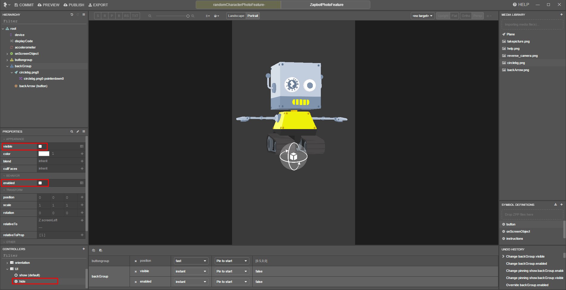

We want the button to appear towards the end of the transition between the show and hide states, so make sure both its properties are set to ‘Instant’ and ‘Pin to end’.
Select the ‘hide’ state and within the group’s properties and uncheck the ‘visible’ and ‘enabled’ properties.

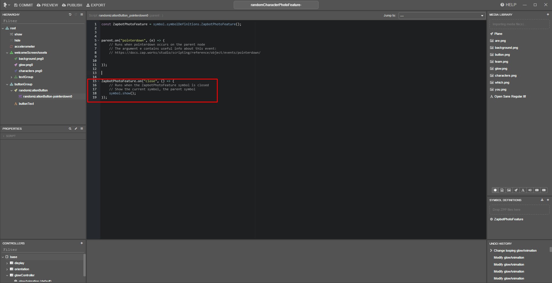

17) Adding a reference to our Zapbot photo feature in the script
Head back to the parent symbol by clicking on it in the breadcrumb bar above the 3D view.
In the hierarchy select the ‘randomizationButton_pointerdown0’ script we created in Part 1.
Hit ‘Enter’ at the top of the script a few times to make room for the symbol reference we’ll be adding.
Create a reference to our ZapBot photo feature symbol by dragging it from the ‘Symbol Definitions’ panel into the top of our script and selecting ‘Construct symbol’.
18) Displaying our parent symbol when a photo feature symbol is closed
Add the following block of code after the pointerdown function.
ZapbotPhotoFeature.on("close", () => { // Runs when the ZapbotPhotoFeature symbol is closed // Show the current symbol, the parent symbol symbol.show();});
The first line of code will listen out for when the close event is emitted by the ZapbotPhotoFeature symbol reference we created in the previous step, which happens automatically through the script we set up in step 15.
If the event is fired on the symbol, the displayParentSymbol function will run and call show() on our parent symbol.

19) Preparing the Zappar Bunny photo feature
While in the parent symbol, right click on the ‘ZapbotPhotoFeature’ symbol in the ‘Symbol Definitions’ panel, and select ‘Duplicate’.
Name the new symbol ‘BunnyPhotoFeature’, and double-click to enter it.
Right click and delete the ‘Zapbot0 (Zapbot)’ node within the ‘onScreenObject >onScreenObject-objectGroup > objectGroup’ group in the hierarchy.
Scroll down the ‘Symbol Definitions’ panel and find the ‘Zapbot’ symbol, then right-click it and select ‘Delete’.
Import the ‘Zbunnypose03.pod’ file from ‘3D Models > Zappar Bunny’ inside the assets download folder by dragging the file into your ‘Media Library’.
Drag the resulting symbol from your ‘Symbol Definitions’ into the hierarchy, within the ‘onScreenObject >onScreenObject-objectGroup > objectGroup’ group in the hierarchy.
| position | 0.6 | 0 | 0 | |
| scale | 4 | 4 | 4 | |
| rotation | -20 | 0.35 | 90 |
Find the ‘buttonCode’ script in the hierarchy, under ‘buttonGroup’.
On line 21, replace the #TeamZapbot part of the snapshot message code with #TeamBunny, so that it looks like this:
Z.device.snapshotMessage("#TeamBunny");

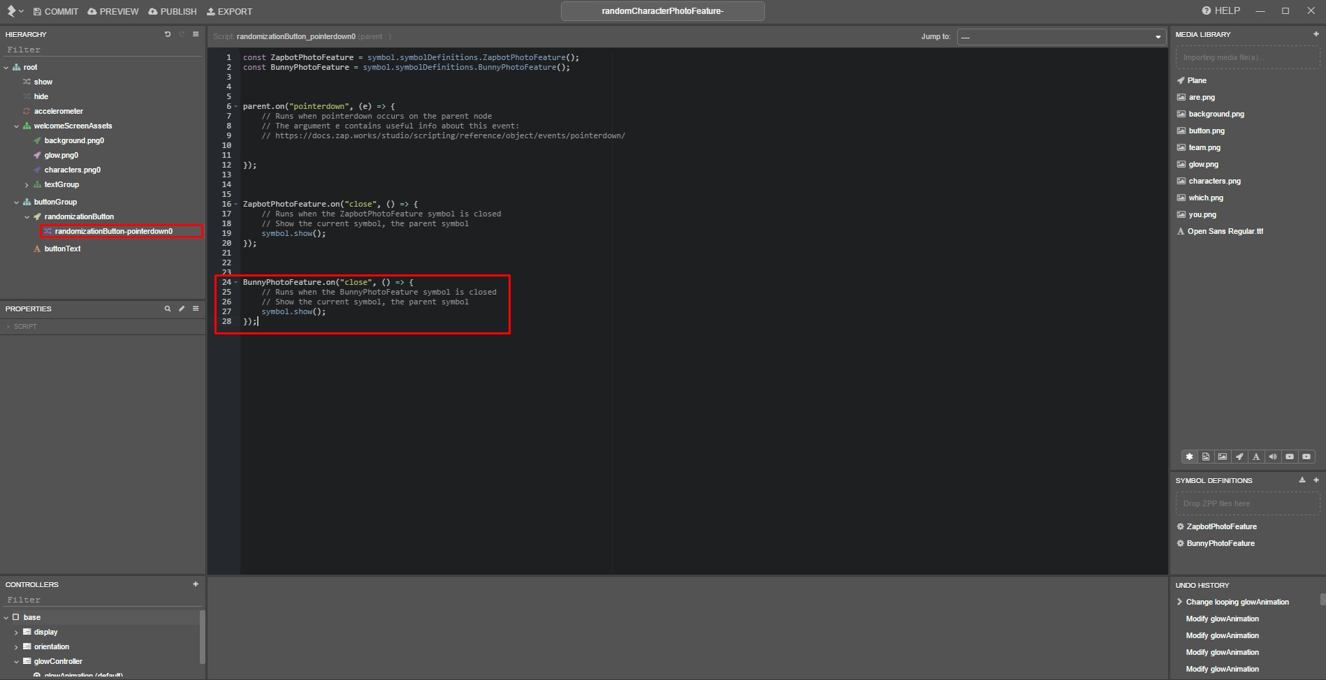

Find the ‘randomizationButton_pointerdown0’ script within the hierarchy and create a reference to the Zappar bunny photo feature by dragging the symbol from the symbol definitions into the script, underneath our ‘ZapbotPhotoFeature’ reference.
Add an .on ("close") event handler for the BunnyPhotoFeature underneath the one we created previously for Zapbot.
BunnyPhotoFeature.on("close", () => { // Runs when the BunnyPhotoFeature symbol is closed // Show the current symbol, the parent symbol symbol.show();});
Our Zappar Bunny photo feature is now set up.
20) Preparing the Dave the Dino photo feature
Name the new symbol ‘DinoPhotoFeature’, and double-click to enter it.
Import the ‘Dave_Dino.pod’ file from ‘3D Models > Dave the Dino’ inside the assets download folder by dragging the file into your ‘Media Library’.
| scale | 5 | 5 | 5 | |
| rotation | 140 | 0 | 90 |
On line 21, replace the #TeamZapbot part of the snapshot message code with #TeamDino, so that it looks like this:
Z.device.snapshotMessage("#TeamDino");

Find the ‘randomizationButton_pointerdown0’ script within the hierarchy and create a reference to the Dino photo feature by dragging the symbol from the symbol definitions into the script, underneath our ‘BunnyPhotoFeature’ reference.
Add an .on ("close") event handler for the DinoPhotoFeature underneath the one we created previously for Zappar Bunny.
DinoPhotoFeature.on("close", () => { // Runs when the DinoPhotoFeature symbol is closed // Show the current symbol, the parent symbol symbol.show();});

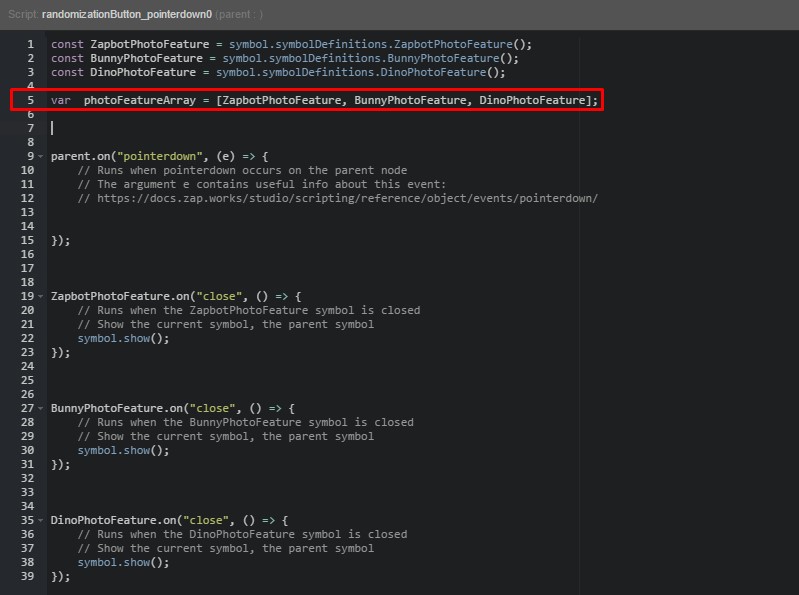

Variables must be declared before they are used, so we’ll be adding our array at the top of the script, beneath the photo feature references we’d created previously.
The array’s elements are separated by commas, and are contained within a set of square brackets i.e. ‘[ ]’.
var photoFeatureArray = [ZapbotPhotoFeature, BunnyPhotoFeature, DinoPhotoFeature];

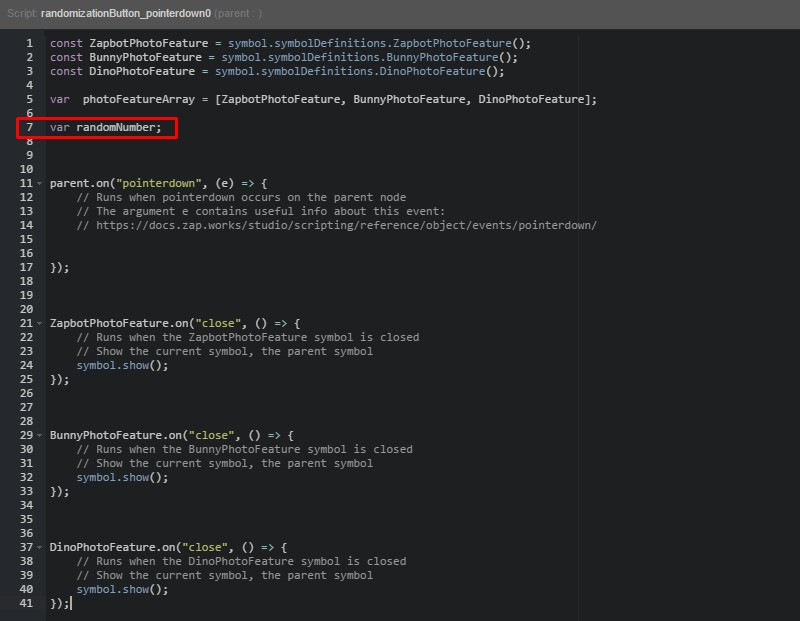

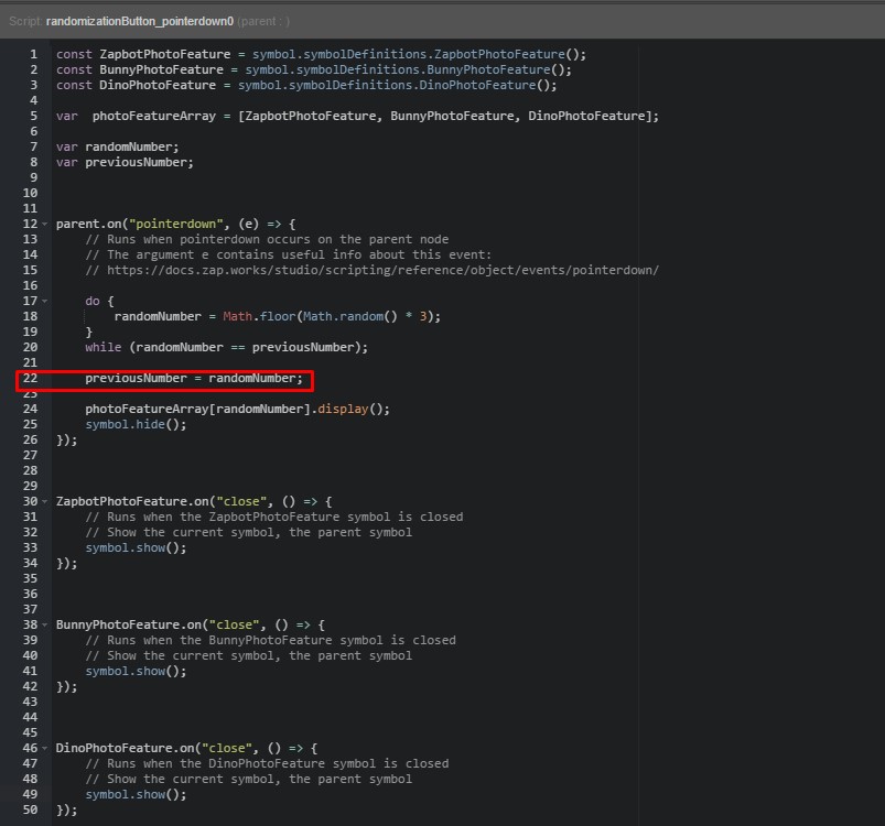

22) Adding the randomization function

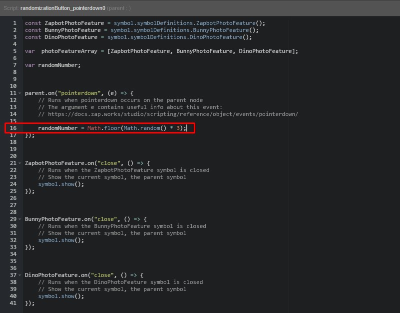

Next, we’ll create a new empty variable called randomNumber after the array but before the pointerdown function.
var randomNumber;
This variable will hold the randomized value we’ll be generating later on in the code, so it won’t be assigned a value until the ‘pointerdown’ function runs when the user taps on the button.

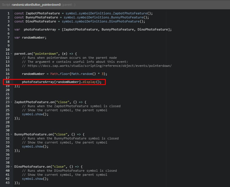

Within the pointerdown function itself, we will add the following line of code:
randomNumber = Math.floor(Math.random() * 3);
‘Math.random()’ returns a value between 0 and 1 by default, so we’re multiplying the result by 3, and then using ‘Math.floor()’ to round this down to its nearest whole value, giving a number between 0 and 2.
You’ll notice that the three possible results we’re generating with our code (0, 1 or 2) directly correlate with the index addresses of our photo feature array elements.
23) Displaying the photo feature and hiding our parent symbol
Now we just need to call .display() on the photo feature at the array index of the random number we generated.
photoFeatureArray[randomNumber].display();

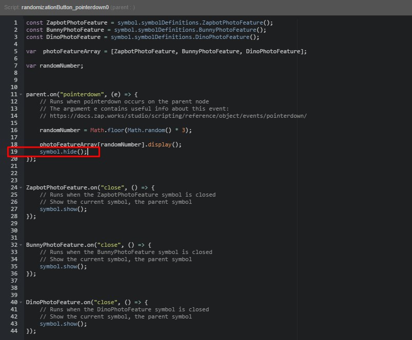

We also want to hide the parent symbol, so that it doesn’t interfere with our photo feature screen symbol.
symbol.hide();

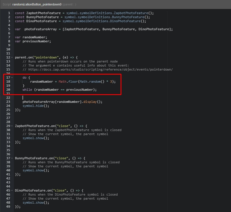

24) Adding a ‘do…while’ loop
We want to make sure that our random number generator doesn’t give the same result twice in a row, which would send the user to the same photo feature consecutively.
This could result in quite a boring user experience, but we can add some variety by using a do/while loop in our code.
This type of loop executes the block of code specified within the do part of the loop (within the { }) at least once, and then checks if the condition stated in the while part is true.
If the condition is true it will repeat the loop and will continue to do so for as long as the condition is true.
A do/while loop follows this structure:
do { execute code;}while (thisCondition);We’ll be running the randomization code within the do part of our loop, and checking that our new result is different to the previous one within the condition.

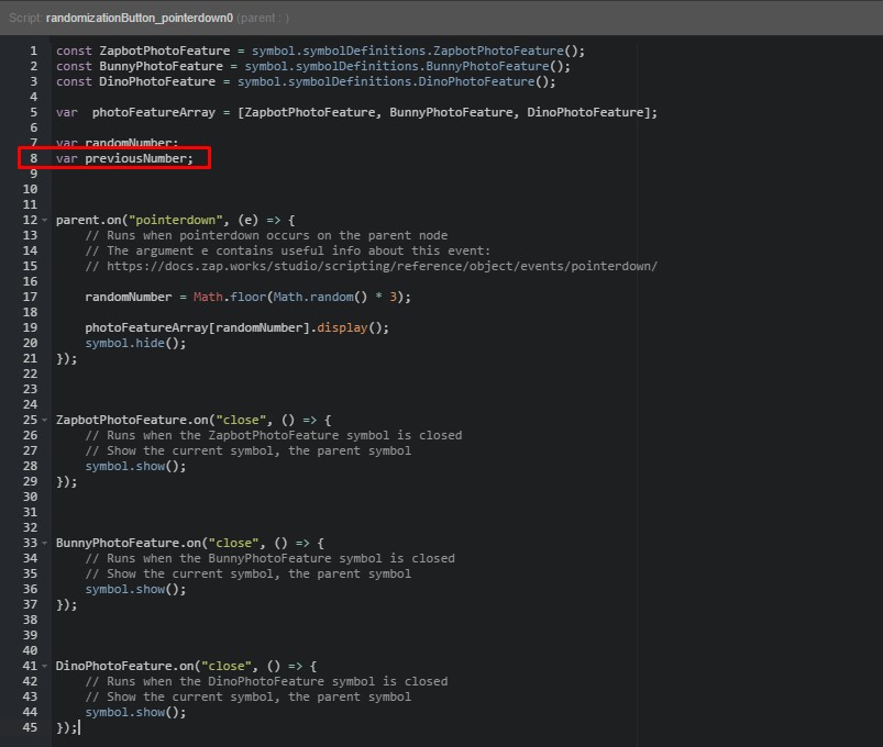

Before we add the loop we’ll first need to create a new variable, which we’ll declare at the top of our script beneath our randomNumber variable.
var previousNumber;
We’ll be using this variable later to store the last value returned by the randomization code.
We’ll be setting up our do/while loop to run the randomization code at least once, before checking whether the result is equal to the one generated in the previous iteration of the loop and if so, to keep running the randomization code until this isn’t the case.

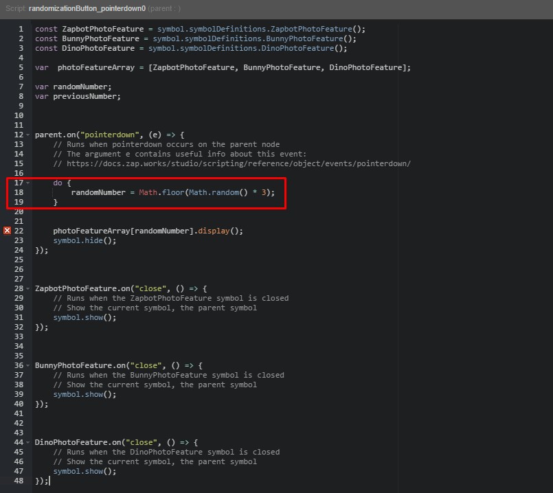

Remove the Math.random() code from its previous location in the script, as we’ll be moving it within the do part of our do/while loop.
Add the following code within the pointerdown function, before the .display() and .hide() functions.
do { randomNumber = Math.floor(Math.random() * 3);}
At this point you’ll get an error in the script (red underline). This is because the do/while loop is currently incomplete, but we’ll be adding that next so you can ignore the error for now.
Within the condition we will add a check that compares our randomNumber and previousNumber variables, which hold the new and previous values returned by the randomization code, respectively.
while (randomNumber == previousNumber);
The complete do/while loop should look like this:
do { randomNumber = Math.floor(Math.random() * 3);}while (randomNumber == previousNumber);
Now that our do/while loop is set up, we’ll tell our previousNumber variable to store the value held by the randomNumber variable, so that the next time the pointerdown code is run we’ll know what the previous result was.
We’ll place this code after the loop, but before the .display() and .hide() functions.
previousNumber = randomNumber;
