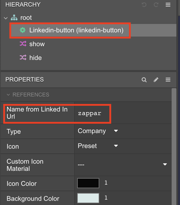

  1. Drag the LinkedIn subsymbol from Symbol Definitions, into the Hierarchy in the parent symbol.
  2. Select the LinkedIn node and set its Type property to Company or Person, depending on the type of profile you’ll be linking to. This step is important, as the formatting of LinkedIn URLs changes depending on the profile type.
  3. Add a link to a valid LinkedIn profile in the Name from LinkedIn URL property. Only add the portion of the URL after https://www.linkedin.com/in/ or https://www.linkedin.com/company/. The example shown below will launch https://www.linkedin.com/company/zappar.

To use a custom icon instead of the default graphic, change the Icon property to custom and set the Custom Icon Material property to your imported image.
