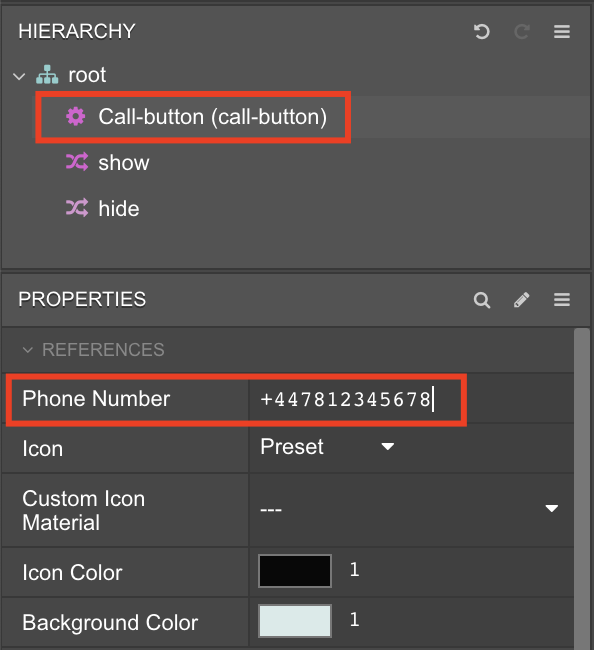

  1. Drag the Call Button subsymbol from the Symbol Definitions into the Hierarchy.
  2. Select the new node and input a phone number to its Phone Number property. The phone number must include the country code prefix, and should not contain any spaces.
