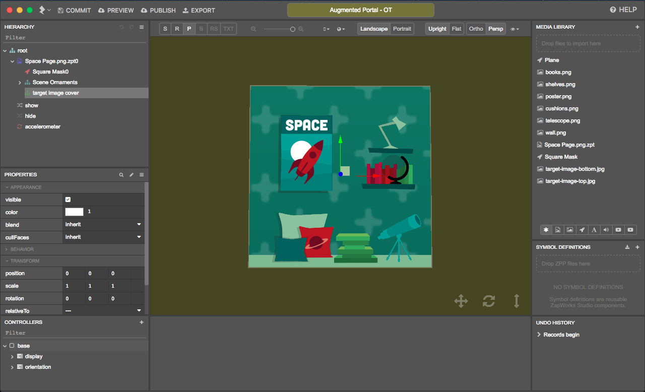

3) Create a group in the hierarchy
In the Hierarchy, within the target image node, add a new group called ‘target image cover’ and place it under the ‘Scene Ornaments’ group. To add a group inside a node, right click on the node, select ‘New > Group’ and name the new group.

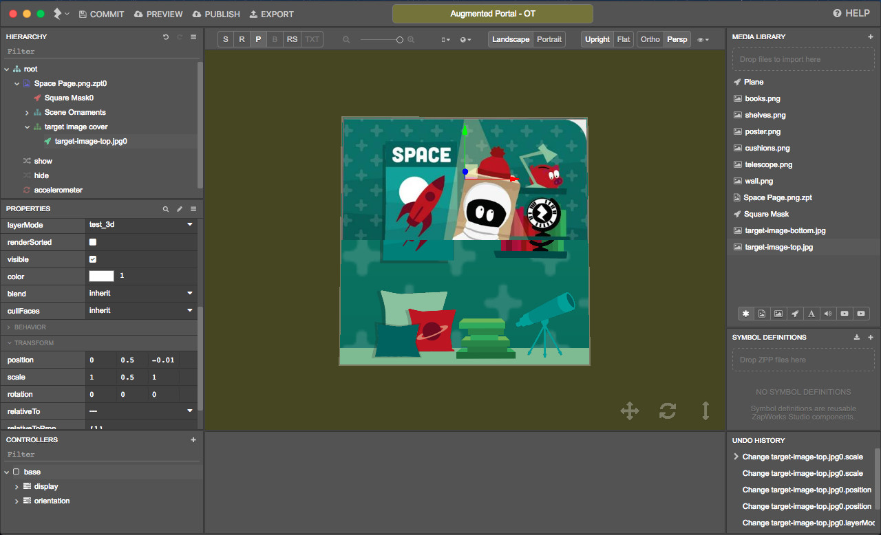

4) Add the top half of the image to your group
Drag ‘target-image-top.jpg’ from the Media Library into the Hierarchy within the ‘target image cover’ group. For the ‘target-image-top.jpg’, set:
  • The layer mode to test_3d,
  • The position to (0, 0.5, -0.01),
  • The scale to (1, 0.5, 1).
To change the value of an object’s property (scale, position, rotation, color etc.) select the object in the Hierarchy and in the Properties panel change the value of the property.

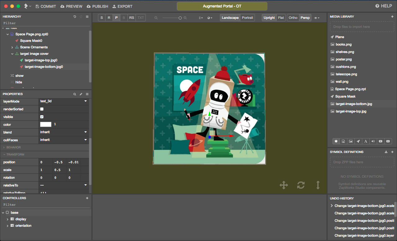

5) Adding the bottom half of the image to your group
Drag ‘target-image-bottom.jpg’ from the Media Library into the Hierarchy within the ‘target image cover’ group. For the ‘target-image-bottom.jpg’ node, set:
  • The position to (0, -0.5, -0.01),

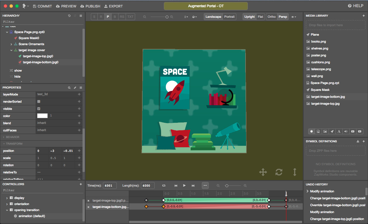

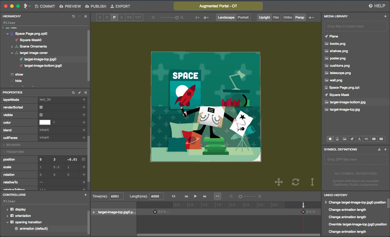

9) Adjust the top image position
In the ‘animation’ timeline, set the ‘Time’ (not Length) to 4001ms and change the value of the ‘target-image-top.jpg0’ node’s position to (0,3,-0.01).
To change the value of a node’s property in a timeline, make sure the correct timeline is selected in the Controllers panel, and that in the Hierarchy the correct node is selected as well. You can then edit the node’s property value in the Properties panel.
10) Create a transition block
In the ‘animation’ timeline, on the ‘target_image_top.position’ line, create a transition block between the first and last keyframes.
To create a transition block between two keyframes, select both keyframes, right click on the line between them and select ‘Make Transition’.
You can set the ‘Time’ to 0 and play the timeline to see how the transition looks so far.

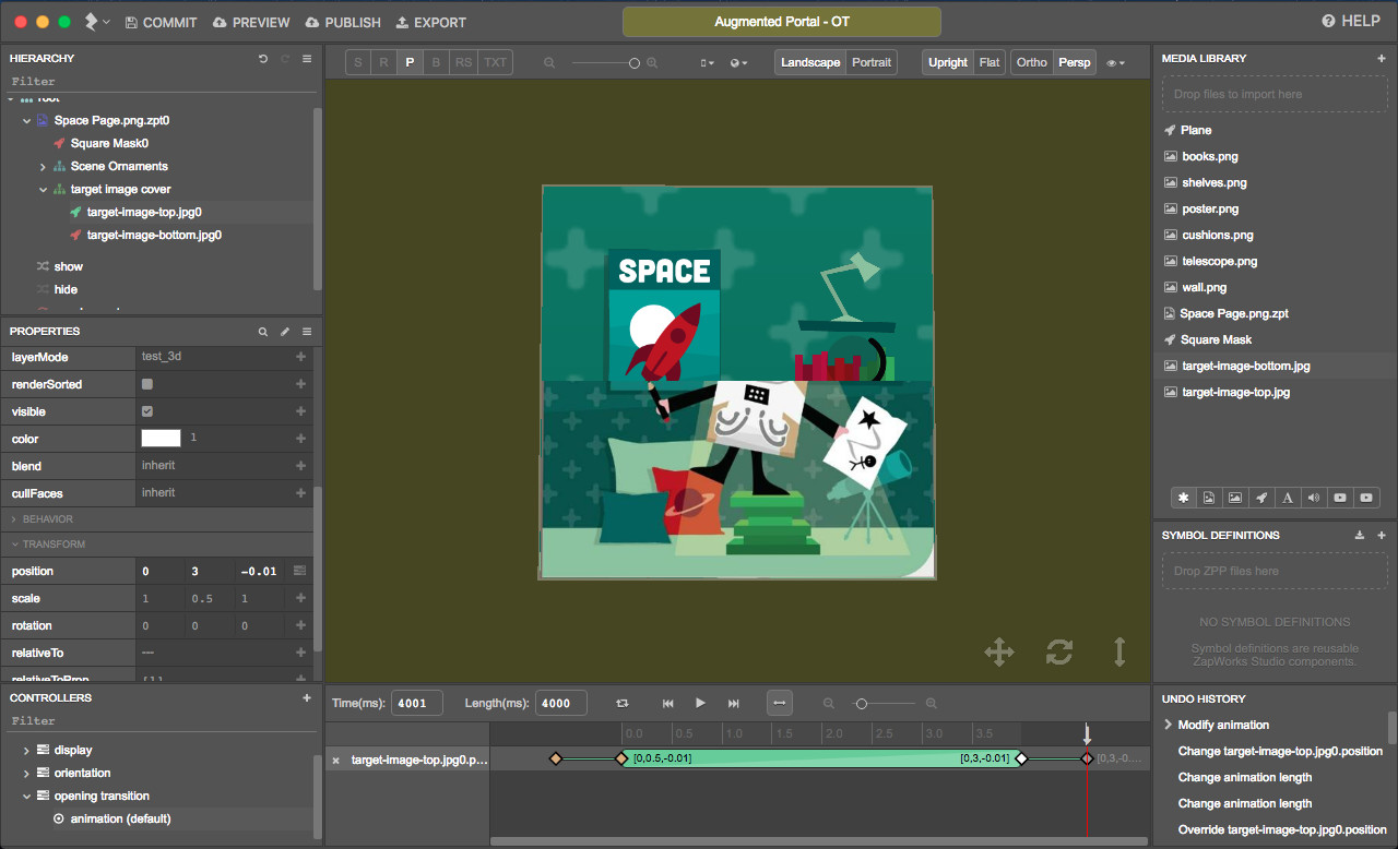

13) Create a transition block
In the ‘animation’ timeline, on the ‘target_image_bottom.position’ line, create a transition block between the first and last keyframes.
You can set the ‘Time’ to 0 and play the timeline to see how the transition looks.

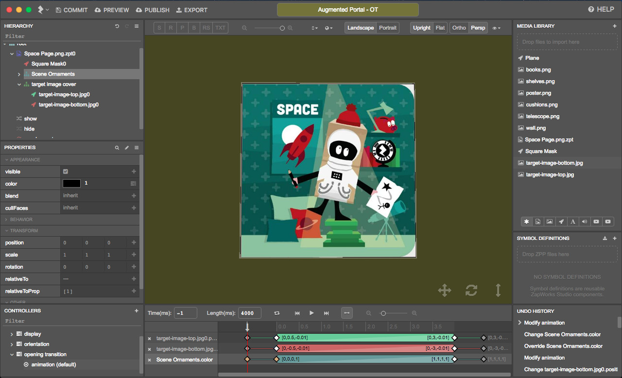

To give the illusion that, as the top and bottom parts of the tracking image slide in opposite directions light progressively enters the room and illuminates its content, we will make the color of the ornaments change from black (as if there were not light) to normal (as if a light had entered the room).
14) Adding the color property
Add to the ‘animation’ timeline the color property of the ‘Scene Ornaments’ group.
15) Adjusting the color property
In the ‘animation’ timeline, set the time to -1 and change the value of the ‘Scene Ornaments’ group’s color to black (in the Color Picker window, make sure Normalised is set to R = 0, G = 0 and B = 0).
16) Create a transition block
In the ‘animation’ timeline, on the ‘Scene Ornaments.color’ line, create a transition block between the first and last keyframes.

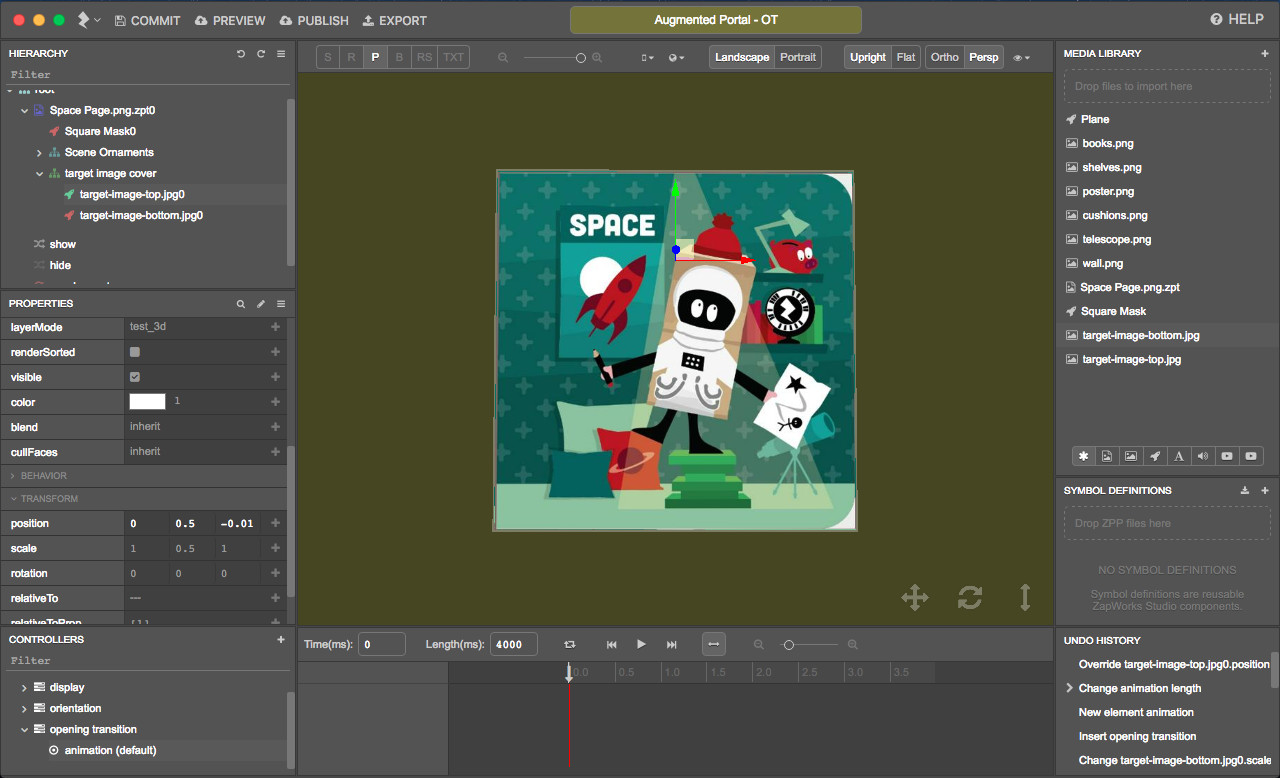

You can set the ‘Time’ to 0 and play the timeline to see how the transition looks now. It’s almost ready!

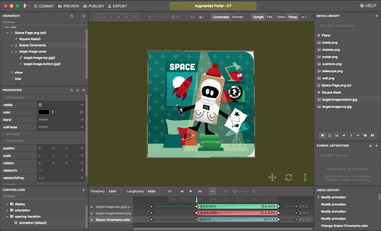

We will add a delay at the beginning of the timeline to make sure the user has time to see the tracking image on their device screen before the transition starts happening.
17) Delay the launch of the animation
In the ‘animation’ timeline, set the time to 1000ms (we’ve chosen to launch the animation after 1 second, but feel free to change this value!). For each property line, move the second keyframe from Time = 0ms to the cursor (red vertical line positioned in Time = 1000ms).
You can set the ‘Time’ to 0 and play the timeline one more time to see how it looks.

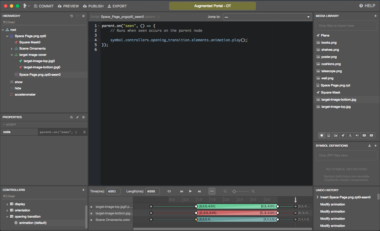

18) Add a ‘seen’ script
Add a ‘seen’ script to the target image node.
To add a ‘seen’ script to a target image node, right click on the target image node in the Hierarchy and select ‘New > Script > seen’.
19) Set the animation to play on seen
Set the ‘animation’ timeline to play within the ‘seen’ script.
To set a timeline to play within a script, drag the timeline from the Controllers panel into the script, inside the function and when releasing select ‘play’.
