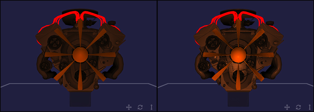

Light Priority
A Light can act as either a pixel or vertex light depending on the priority you set it at, the priority of other lights in the scene, and potentially the brightness or distance from the object being lit.
Pixel lights are calculated per pixel, resulting in a more accurate color outcome, but more expensive to calculate.
Vertex lights are calculated per vertex, and the final color is interpolated per pixel. They are faster but not as accurate.
The Z.LightPriority, set by the priority property of a light node, determines if the light is treated as a pixel or vertex light.
If a light’s priority is set to important and the number of existing important lights in a scene is less than the numPixelLights value of a lit object’s material, that light will act as a pixel light for that object; otherwise, it will act as a vertex light.
If a light’s priority is set to unimportant that light will act as a vertex light.
If a light’s priority is set to auto and the number of existing important lights in a scene is less than the numPixelLights value of a lit object’s material and the light is either the brightest Z.DirectionalLight (based on the intensity of the light) or the nearest Z.PointLight or Z.SpotLight (compared by the node distance) that light will act as a pixel light for that object; otherwise, it will act as a vertex light.
The default priority for a light is auto.
