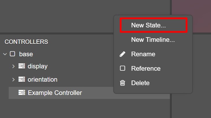

To add a state to a controller, right-click on a controller and select New State.

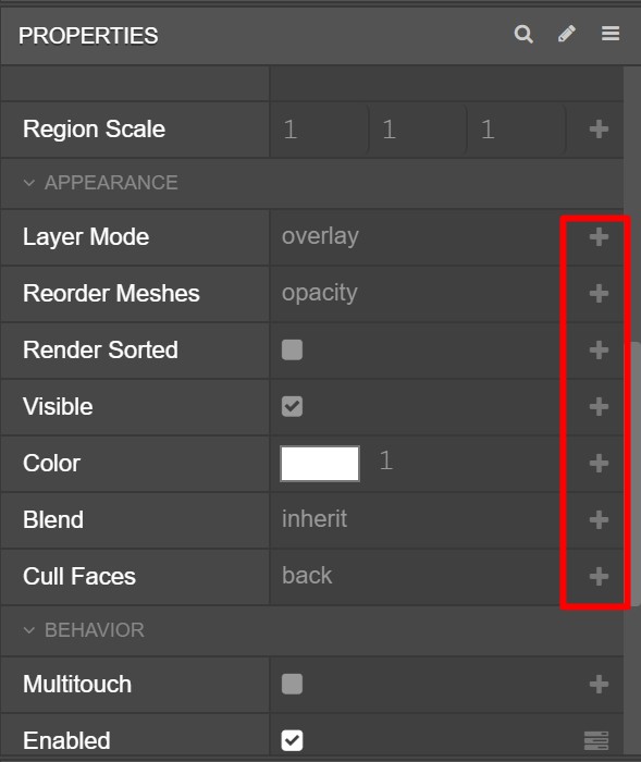

To assign a property to a new controller, select the controller first, then a node in the Hierarchy. Clicking the plus (+) icon to the right of a property in the Properties panel will add it to the controller.
The value of the property will then be editable from any states within the controller.

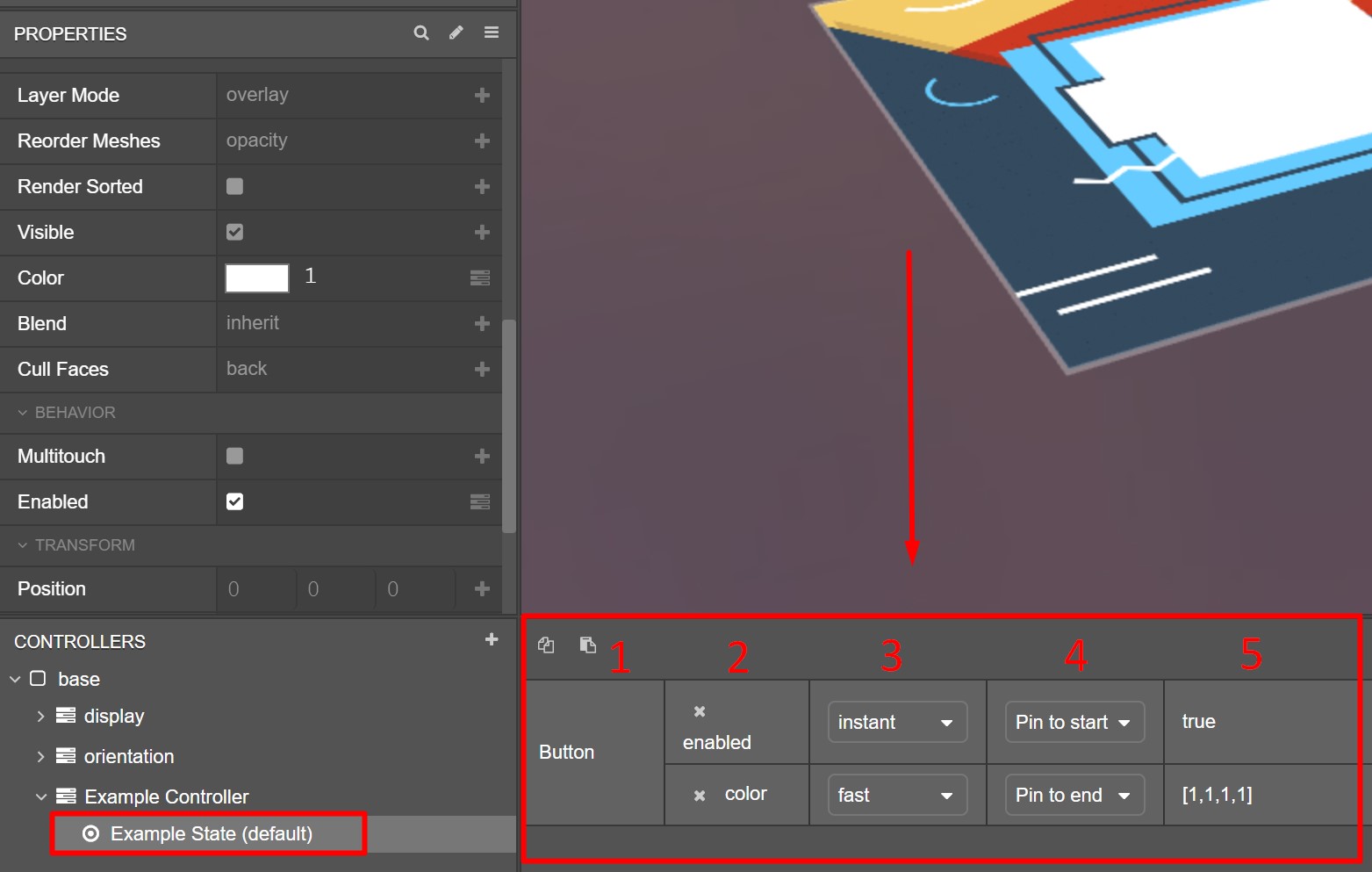

While a state is selected, and if it has properties assigned, the state view panel is shown.
This panel has five columns:
Diagram ID Description
1 The node(s) from the Hierarchy which has properties assigned to this controller.
2 The specific properties of the node managed by this controller. Clicking the (x) will remove a property from the controller.
3 Sets the speed at which a transition between states in the controller will occur.
4 Sets whether a property will transition to the value in the selected state at the beginning or end of its activation. This is only applicable to properties that transition over time, such as position or color.
5 The current value of the properties stored in the selected state.

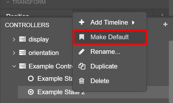

The first state added to a controller will be marked as its default state, meaning it’s the initial state that will be active when the experience is scanned.
To set a different state in a controller as the default one, right-click it and select Make Default.
