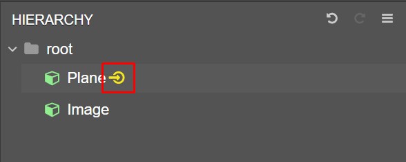

Nodes with actions can be identified in the Hierarchy by the icon after their name.

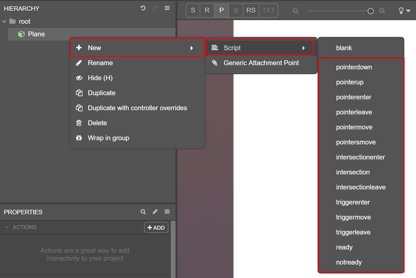

Although actions are a quick and easy way of adding interactivity, setting up event handlers within a script allows for full control and customization of content behavior using Studio’s TypeScript environment.
Although familiarity with TypeScript (or a similar language) is useful, ZapWorks Studio simplifies the process of adding event handlers to make this method more accessible.
If you have little to no experience with the language, our TypeScript Primer is a great resource to get started with.
To add an event handler, right-click a node in the Hierarchy and select New > Script >. A menu will be displayed, listing the events that are emitted by that node.
Just as with actions, the events listed will be contextual to the node’s type.
Selecting an event creates a new script node with the event handler automatically set up, or an empty script if the Blank option was selected.
States and timelines can be dragged directly into the event handler to activate/play them when the event is fired. Custom logic can also be coded within the event handler.
For a closer look at using a pointerdown event to set up a button, check out our Creating Buttons scripting example.
