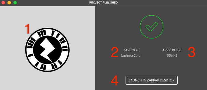

Once an experience has been previewed or published, a modal will pop up, displaying a zapcode that can be scanned with the Zappar app, or WebAR portal, to launch the experience. The approximate download size of the experience is also displayed on this modal. We recommend keeping experiences under 5mb. For more information on reducing an experience’s size, refer to the optimization article.

Diagram ID Description
1 The scannable trigger.
2 The name of the project the experience was published to.
3 The approximate download size of the experience.
4 Launches the desktop version of the Zappar app, used for debugging purposes.
