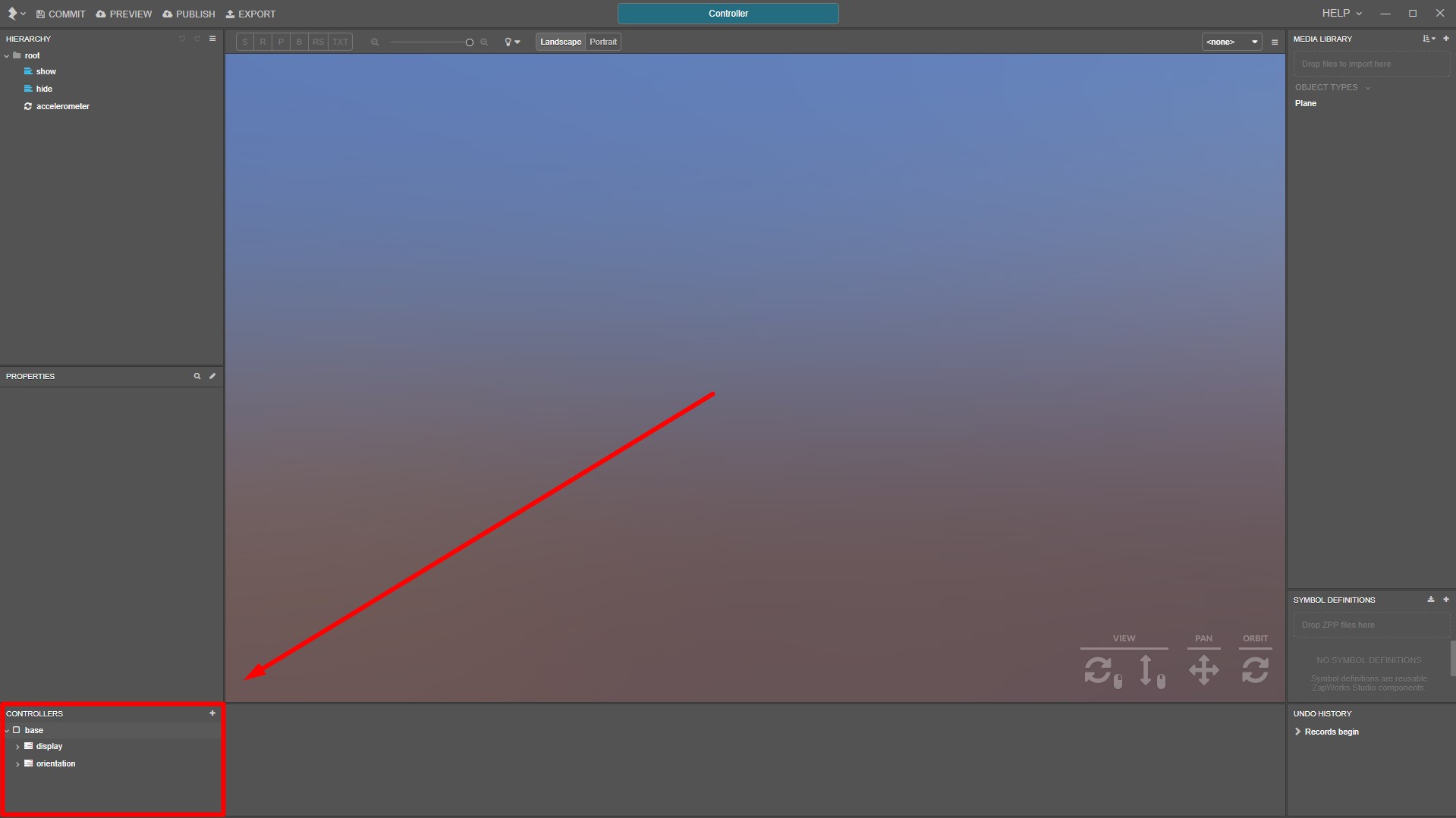

Timelines are created and managed in the Controllers Panel, located in the bottom left of Studio’s UI.

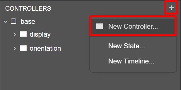

As they are managed by them, a controller must be created before a timeline can be added. To add a controller, click on the plus (+) icon in the Controllers Panel and select New Controller.

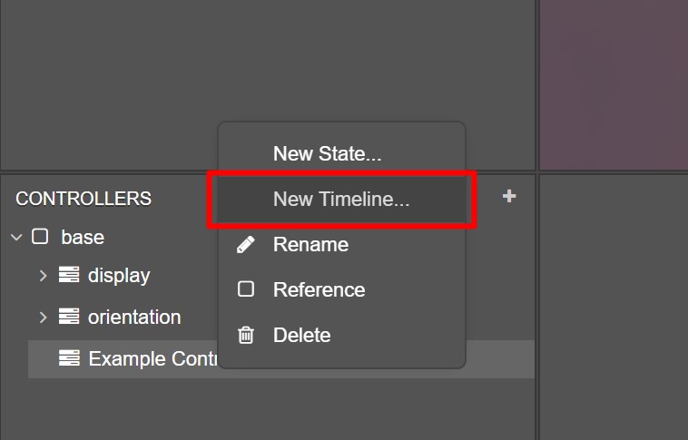

To add a timeline to a controller, right-click on a controller and select New Timeline.

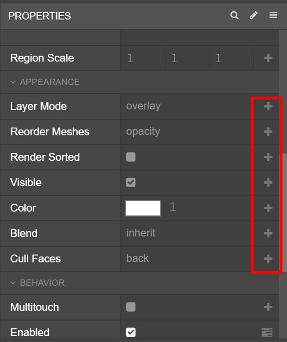

Before a node’s properties can be animated along a timeline, the properties must first be assigned to the timeline’s controller.
To assign a property to a controller, select the controller first, then a node in the Hierarchy. Clicking the plus (+) icon to the right of a property in the Properties panel will add it to the controller.
Once assigned, a property can be animated along the timeline to create custom animations.

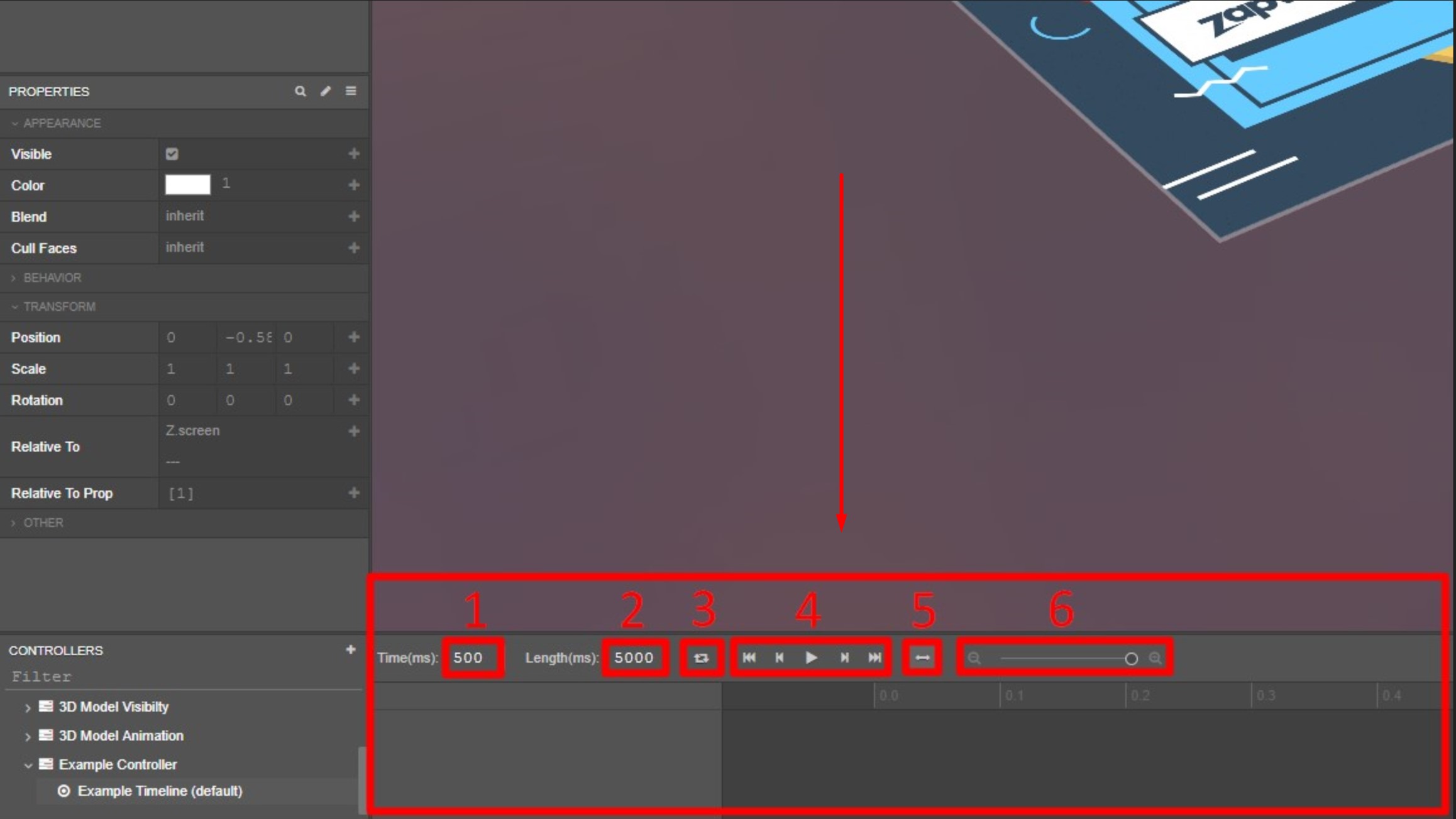

While a timeline is selected, the timeline panel is shown along the bottom of Studio’s UI. Animated node property transitions are displayed in this view.
This panel contains helpful timeline tools, listed below:
Diagram ID Description
1 The time at which the seek bar is positioned along the timeline, in milliseconds (ms).
2 The total length of the timeline, in milliseconds (ms).
3 Sets whether the timeline should loop playback continuously.
4 The timeline controls allow you to play or pause playback, jump to the start or end of the timeline, and jump to the previous or next keyframe.
5 Sets whether the seek bar should snap to the nearest keyframe.
6 Sets the zoom level of the timeline.

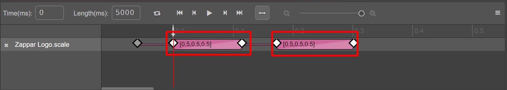

When additional keyframes are added to a timeline, a transition block is created between the new keyframe and the keyframe at its left-most position.

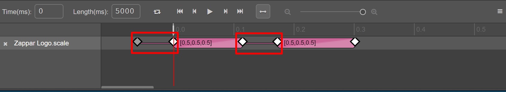

Properties with binary values e.g. enabled/disabled, visible/not visible, cannot be transitioned over time and will not display a transition block. Instead, a link is added between them.
Links
Links are represented by thin lines connecting keyframes. Modifying the value of a property in a linked keyframe will also change the value in any other keyframes linked to it.
Splitting Keyframes
If a keyframe has a transition block on either side it can be split into two separate keyframes, containing the same values. A link between split keyframes will be automatically created.

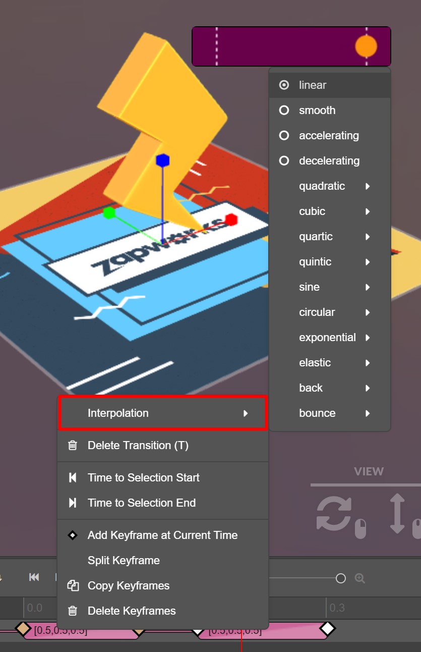

Interpolation
The transition style between two keyframes can be changed by right-clicking the transition block and setting a new interpolation type e.g. elastic or bounce.
