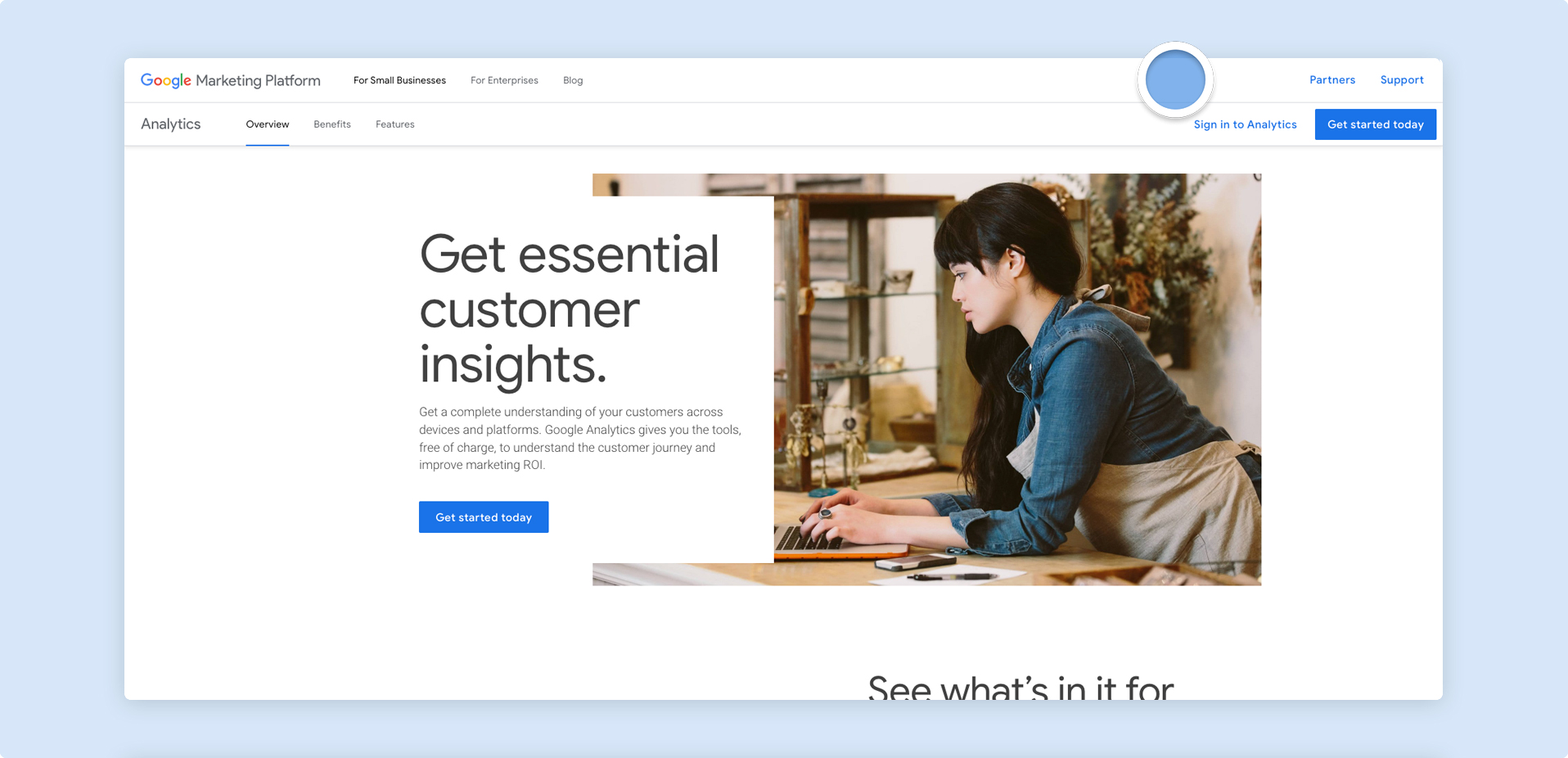

  1. Go to Google Analytics and sign in.

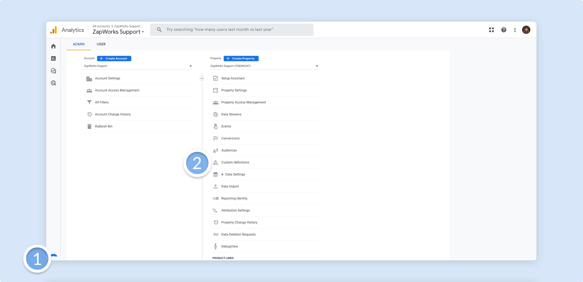

  1. Create a new account if you do not have one prepared. To create a new account, click on the cog icon in the bottom left of the screen to open the Admin panel and then click on Create account. Follow the instructions provided by Google to create your new analytics account.
Creating a new Google Analytics account
  1. If you are not already in the Admin panel, be sure to do so by clicking on the cog icon to the bottom left of the screen. Then, click on Create property and follow the instructions provided by Google.
Creating a new Google Analytics property
  1. When you have created your new property, make sure that it is selected and then click on Data Streams. Create a new Web platform data stream.
Creating a new Google Analytics data streamy

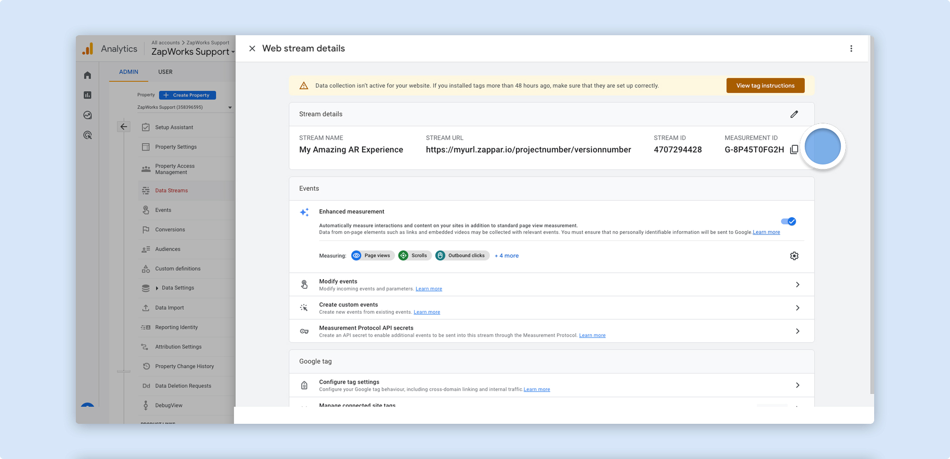

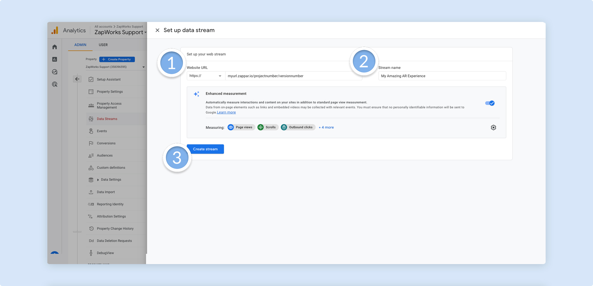

  1. Add the Website URL of your project and give it a Stream name. When you are done, click on Create stream.
  1. Find your data stream’s Measurement ID. This is the tracking ID intended for use in Zapworks Designer.

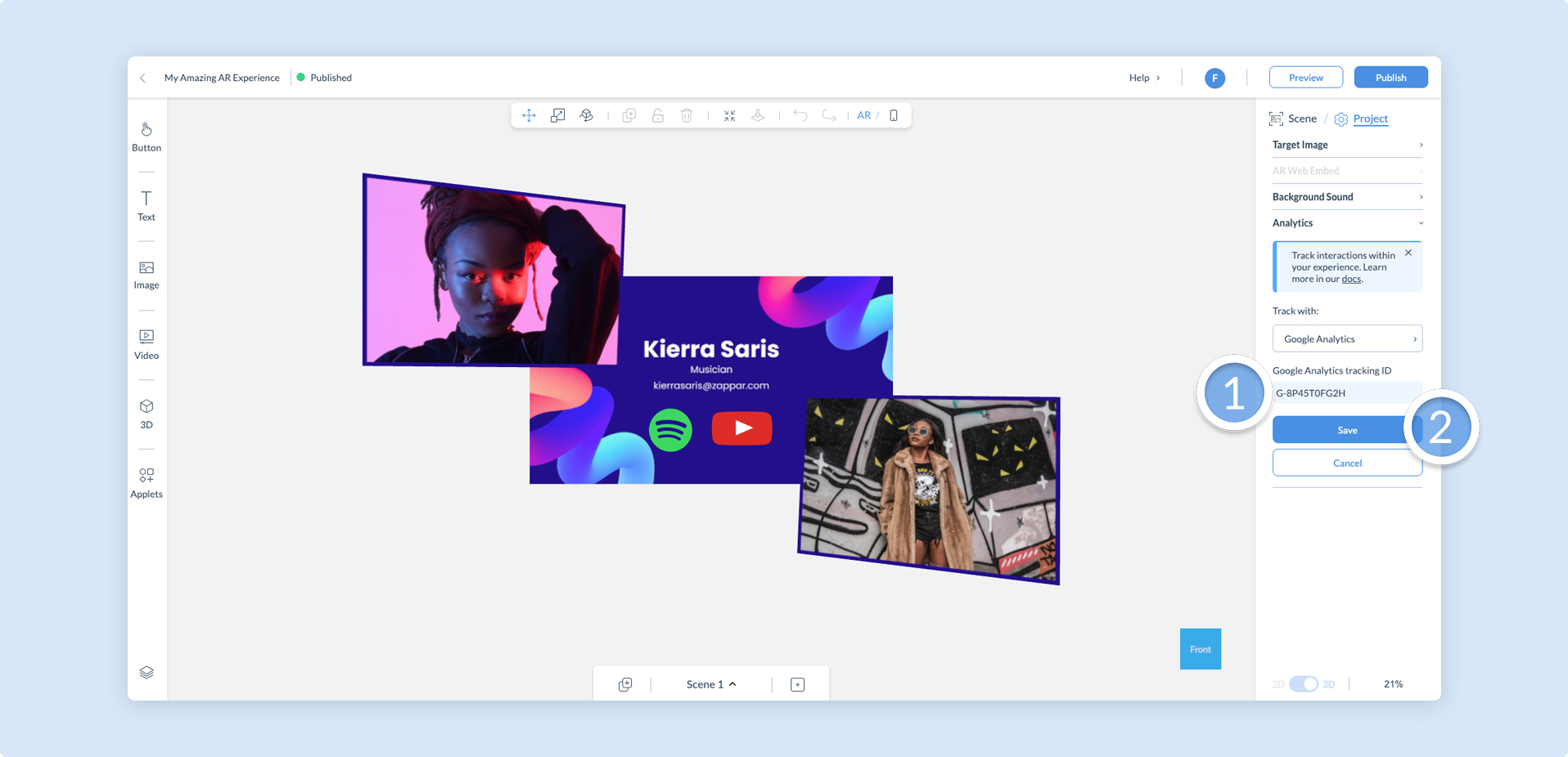

  1. Once you have copied your Measurement ID, go to https://my.zap.works and open up your project in Zapworks Designer. Find the Project Properties panel, to the right of the canvas.

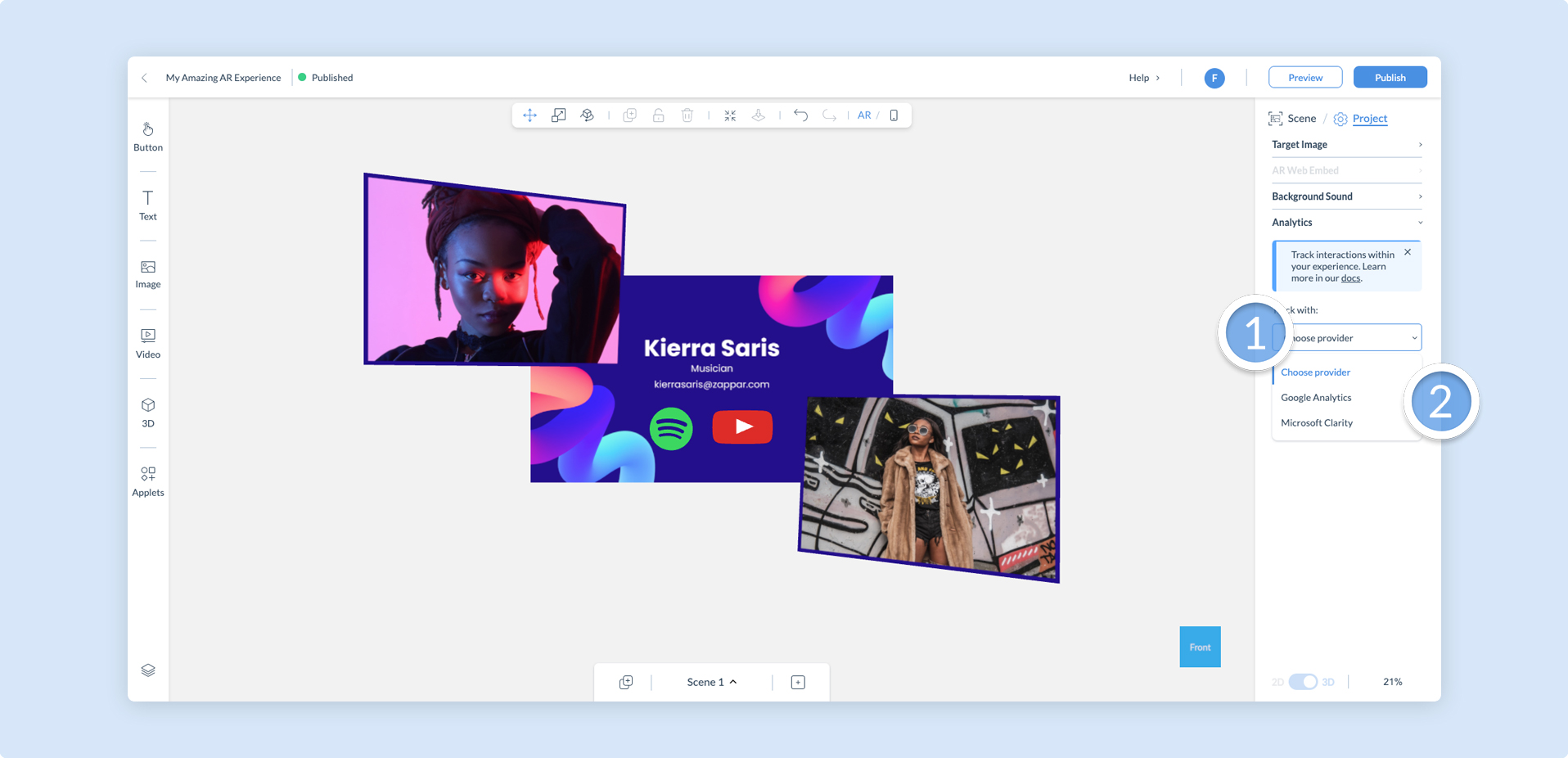

  1. Click on the Analytics menu option.
  1. Click on the Choose provider drop-down and select Google Analytics.
  1. Enter your data stream’s Measurement ID into the tracking ID input box, and click Save.
You may add more than one analytics provider to your project.

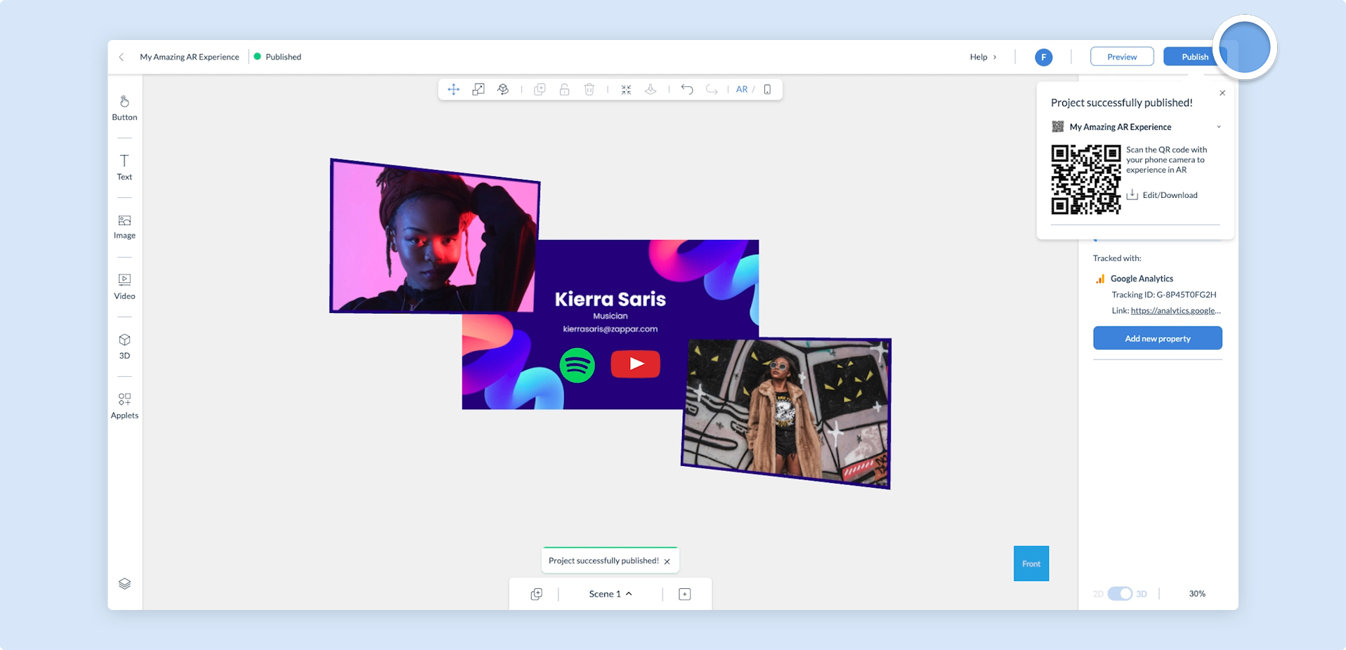

  1. Click on Publish in the top right of the navigation to publish your project and start sending analytics to your Google Analytics dashboard.
Analytics will not be logged when you preview your experience. To start logging data, your project must first be published.

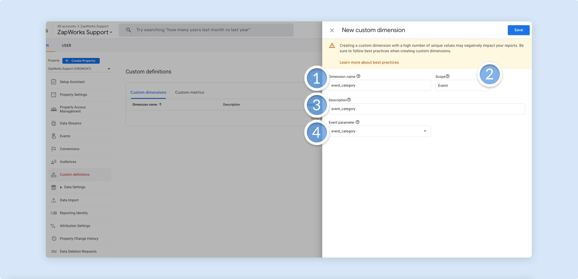

  1. Click on the cog icon in the bottom left of the screen to open the Admin panel and find the Custom definitions panel on your chosen property.
  1. Click on Create custom dimensions. Enter the following information:
  • In the Dimension name input field, type event_category.
  • The Scope should be left as Event by default.
  • In the Description input field, type event_category.
  • In the Event parameter input field, type event_category.
When you are done, click on Save.
  1. When you have saved your first custom dimension, click on Create custom dimensions again. Enter the following information:
  • In the Dimension name input field, type event_label.
  • In the Description input field, type event_label.
  • In the Event parameter input field, type event_label.

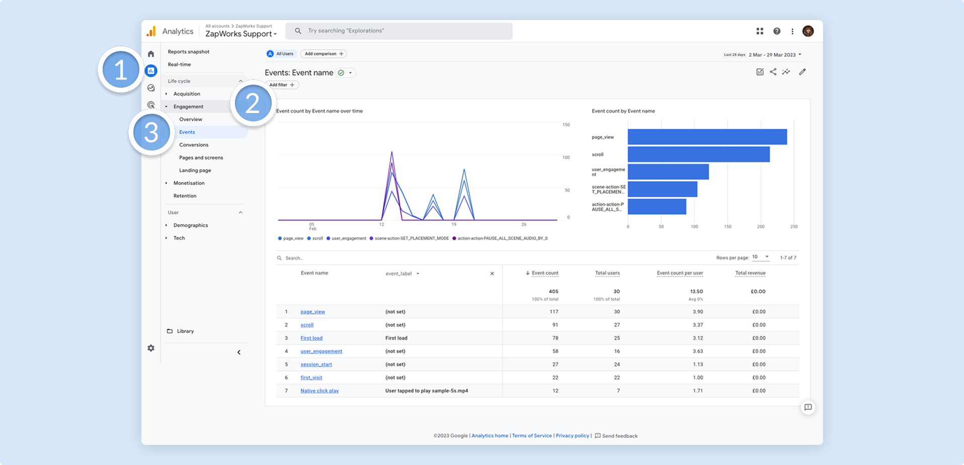

  1. Once your custom definitions have been saved, you may view them by first clicking on Reports in the left navigation menu, then selecting Engagements. You can then select the Events tab to monitor your custom events.
