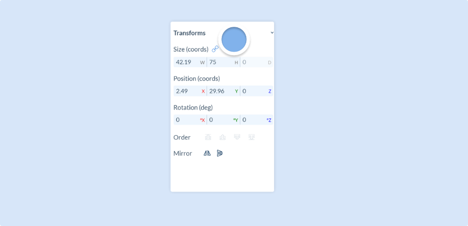

Transforms Edit the Size (Width, Height and Depth), Position (X/Y/Z coordinates), and Rotation (degrees on the X/Y/Z axes) of the 3D model. You can also Mirror the 3D component and change the 3D model’s layer Order (forwards or backwards) relative to other scene components.

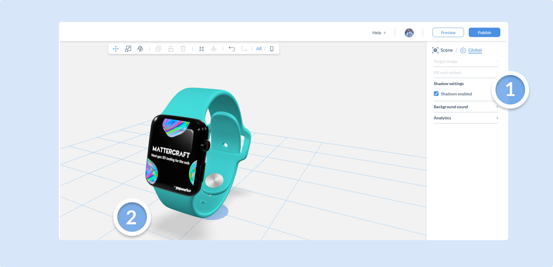

You can also use the Global Properties panel to enable shadows on all 3D components in your project.
By default, your model will scale in with a locked aspect ratio when adjusting scale. To edit each axis individually, select the unlock button in the ‘Transforms’ tab.

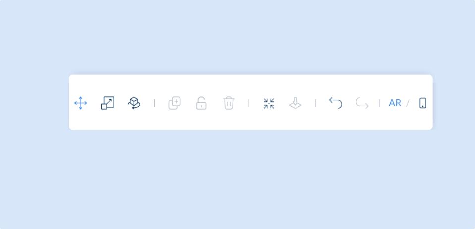

You can update the transforms of a selected model using the Context Bar on your canvas (shown below).
The Context Bar allows you to control the following:
Section Description
Move Move the selected component in the X, Y, or Z axis.
Scale Scale the selected component in the X, Y, or Z axis.
Rotate Rotate the selected component in the X, Y, or Z axis.
Duplicate Duplicate the selected component.
Lock/Unlock Lock or unlock the selected component from transform functions.
Delete Delete selected component.
Recenter Recenter your view on the canvas to default.
Snap to surface Recenter and snap your component to the surface of the tracking type.
Undo/Redo Undo or redo any changes you have made to your component.
