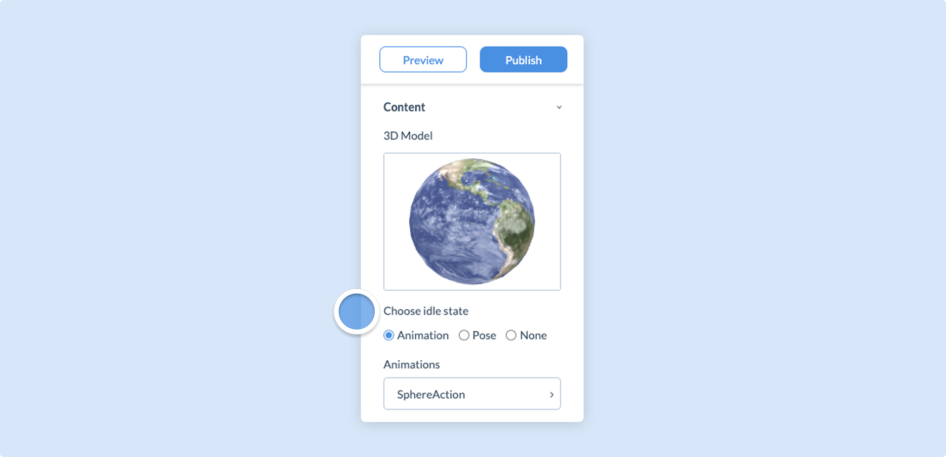

To set an idle pose or animation, first click on your 3D component in the scene if it is not already selected. Then, find the Project Properties panel to the right of the canvas and make sure that the Content drop-down option is selected. From here, you are able to choose your 3D model’s idle state:
Idle State Description
Animation Automatically plays and loops the chosen animation.
Pose Sets the initial pose of the 3D model with your animation frame of choice. This pose will always be static.
None No animation selected.
Customising a 3D model's idle state
