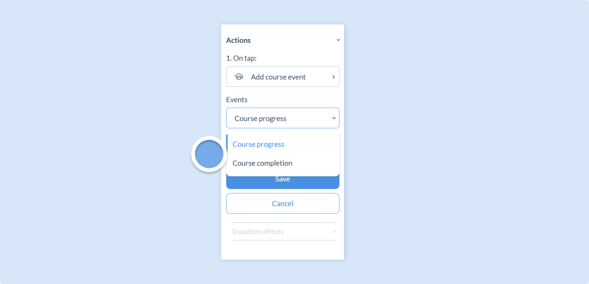

To add course events to your experience, select a Component within the appropriate scene and use the Actions property to add a course event then select one of the two events, Course progress or Course completion.
Designer has two action types, On Tap Actions and On Finish Actions, and both can be used to trigger either of the course events.

  3. Under the Actions property, select Add course event and choose Course progress in the events drop-down.
  4. Use the Progress slider or Input to set how much progress that scene is worth.

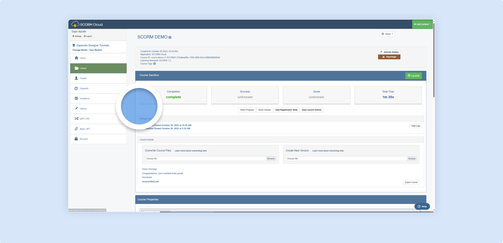

Once exported, the SCORM package can be imported into any LMS for tracking. SCORM Cloud provides a free LMS for testing and if it works there, it should work in your LMS.
