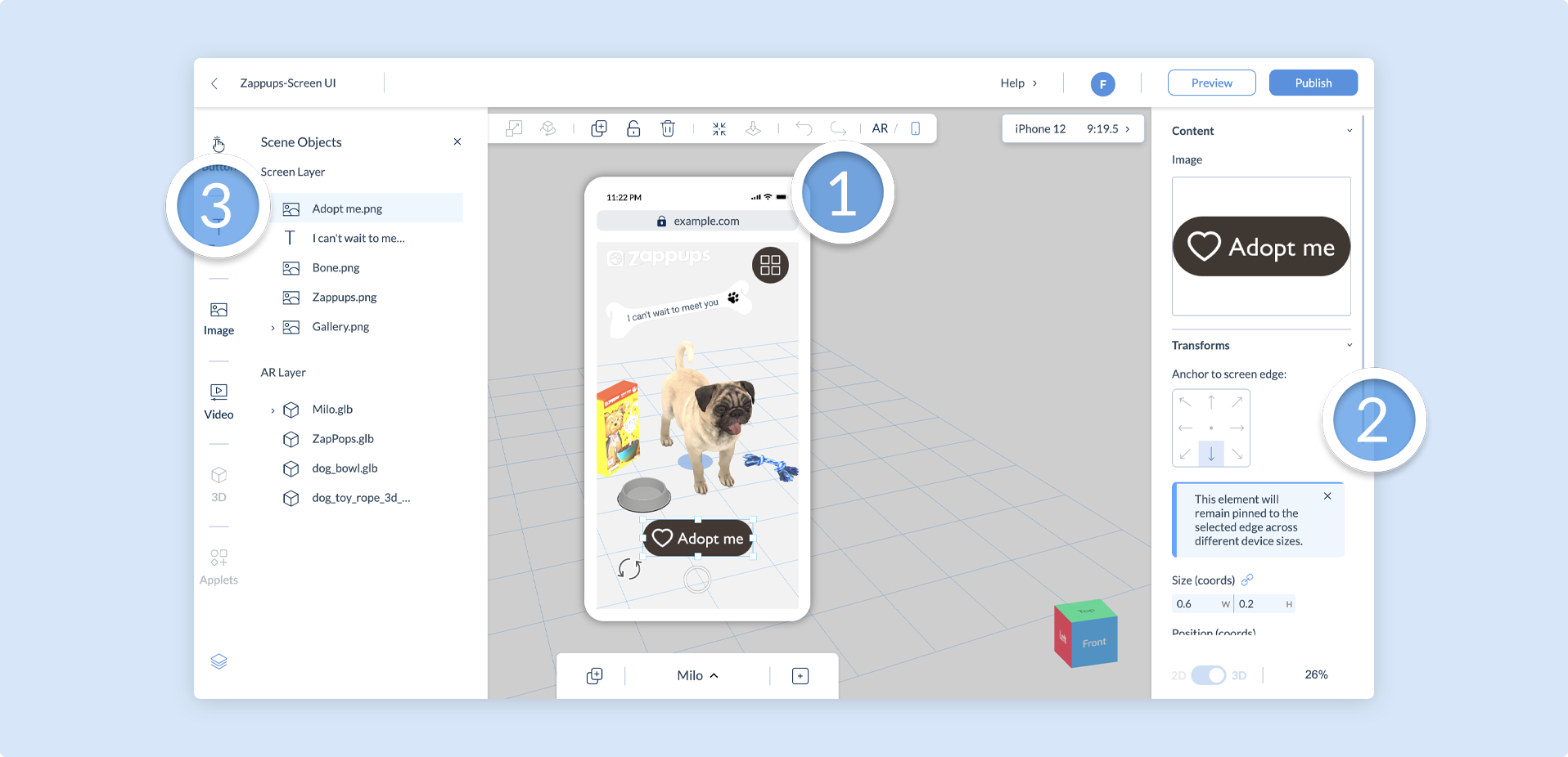

The image and table below showcase the main Screen UI elements which become visible when you enter this mode.
Scene UI Elements Description
(1) Screen Layer Canvas The overall area where you can add your 2D components.
(2) Anchor Pins Allows you to pin your assets to a selected edge across different device sizes.
(3) Scene Objects: Screen Layer Enables you to select your 2D components and re-arrange their order.
3D components are disabled in Screen UI mode.
