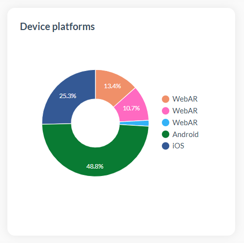

  • Device platform type (iOS, Android, WebAR) used to launch an AR experience;

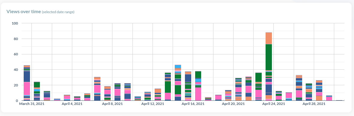

  • Number of views per day or per month over a certain period of time;

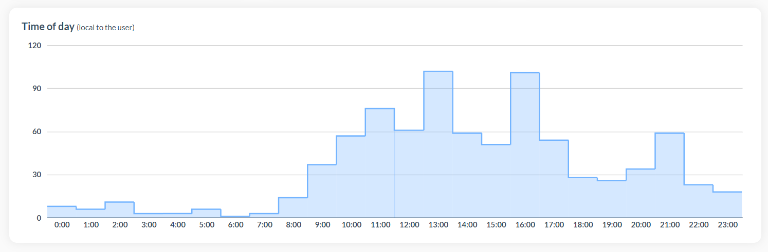

  • Number of views at a certain time of the day;

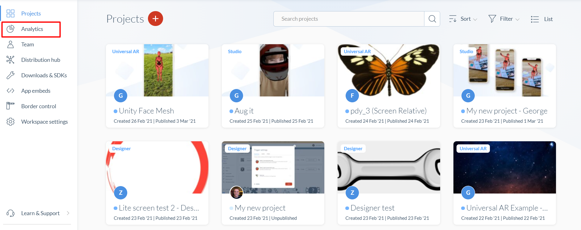

Analytics can be accessed from your workspace by clicking the Analytics tab in the left hand navigation.

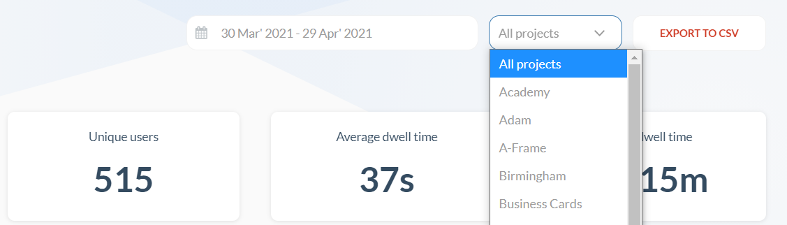

By default, you’ll see the data for all the projects in your workspace.
To see the analytics for a specific group of projects, use the drop down button next to ‘All projects’ and select a group:

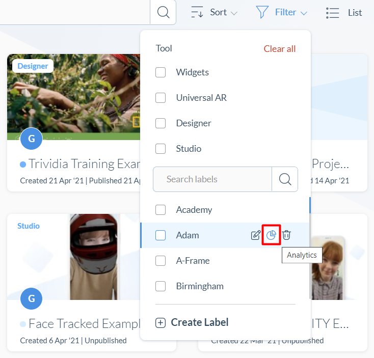

Alternatively, you can access a group’s analytics from the projects overview page by first clicking on the ‘Filter’ drop down button, click on the analytics icon next to the group in question.

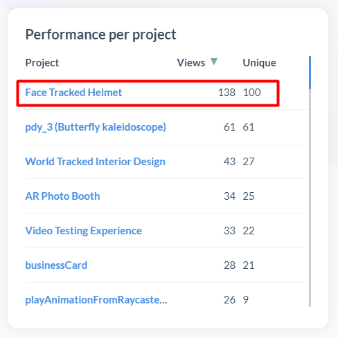

To see the analytics for an individual project, click on the name of the project in the box with all the projects, on the right of the screen:

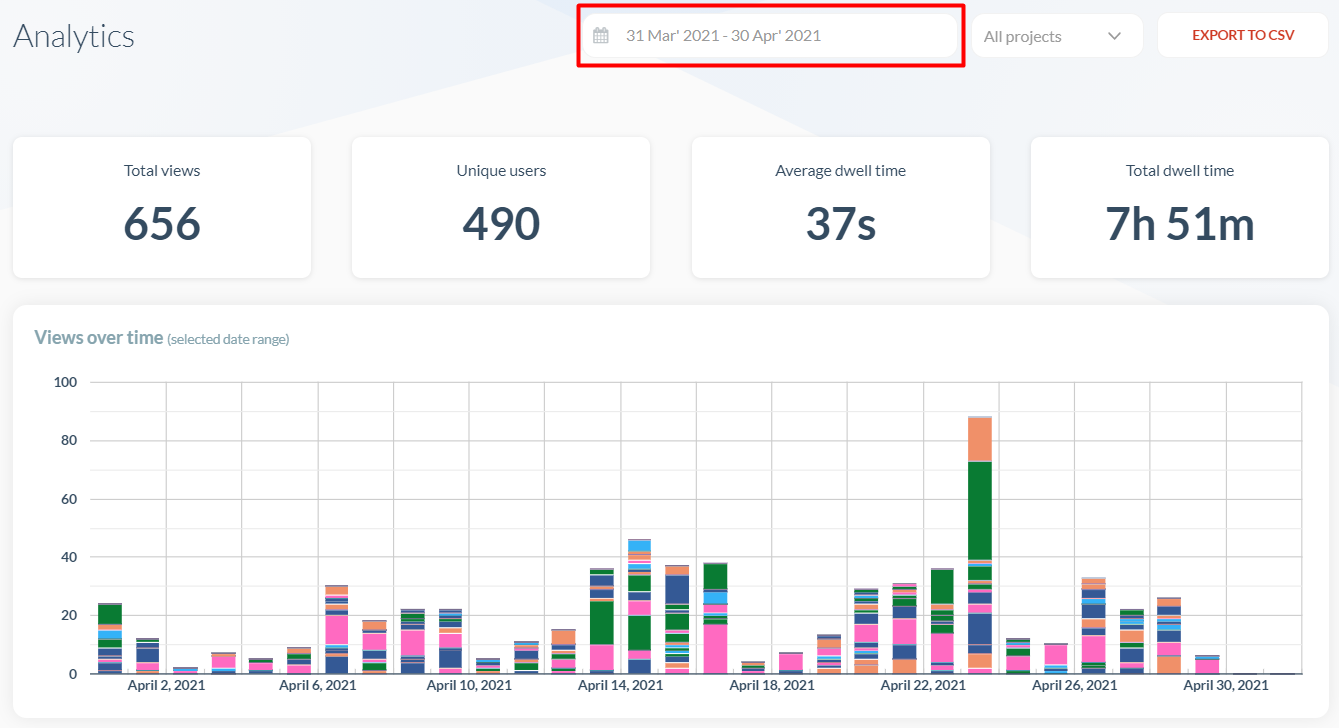

Each bar in the graph represents a single day within the date range selected.
What does ‘Total Views’ mean?
This is the total number of views for the project or group of projects that have been selected.
What are ‘Unique Users’?
This is the number of unique devices that have launched a project.

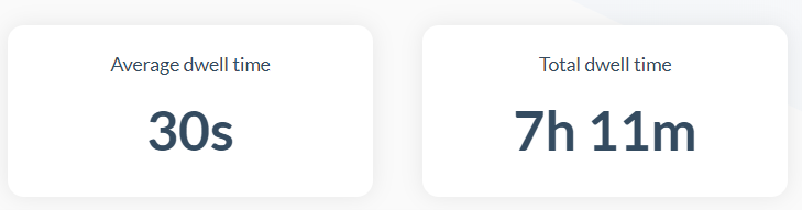

What are ‘Average Dwell Time’ and ‘Total Dwell Time’? What’s the difference and how are the numbers calculated?
Average dwell time is the average length of time users spend in the experience from when it has loaded. The total dwell time is the cumulative time spent by all users interacting with your AR content. Note that dwell time is not recorded for WebAR views.
What is included in the ‘Others’ group within my Analytics data?
The data within the Analytics dashboard lists the top fifty projects by the number of scans. All other projects are aggregated into a single group, ‘Others’. For a complete breakdown of the analytics data please use the ‘Export to CSV’ option in your Analytics dashboard.
