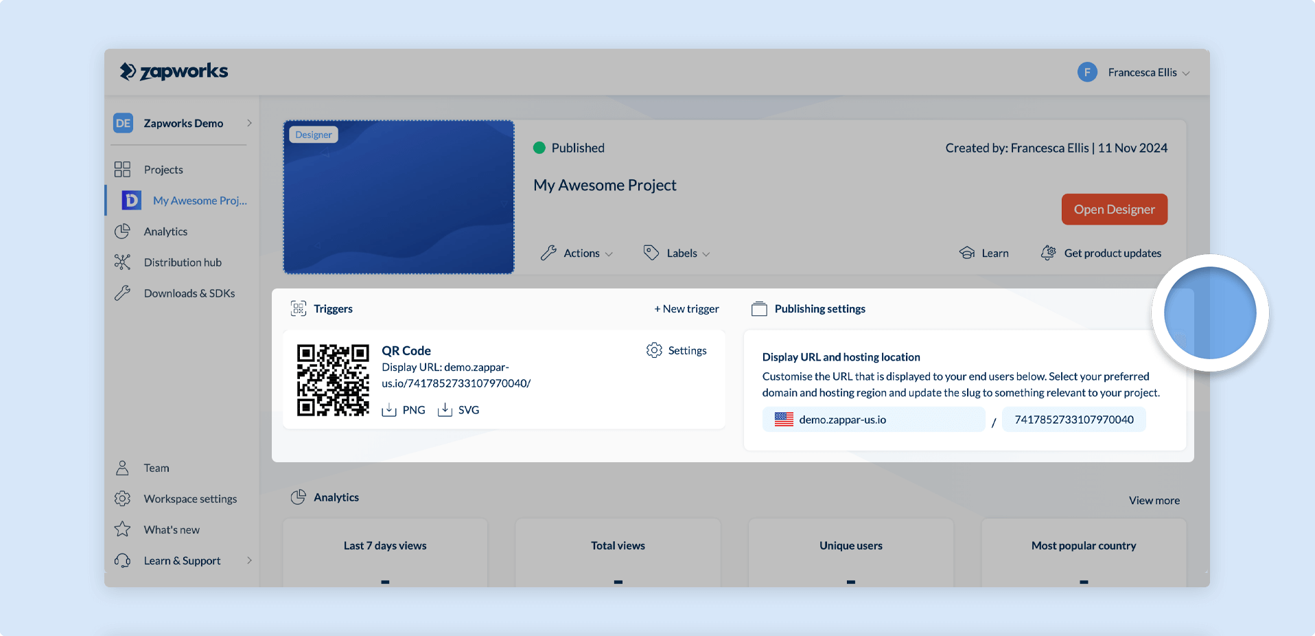

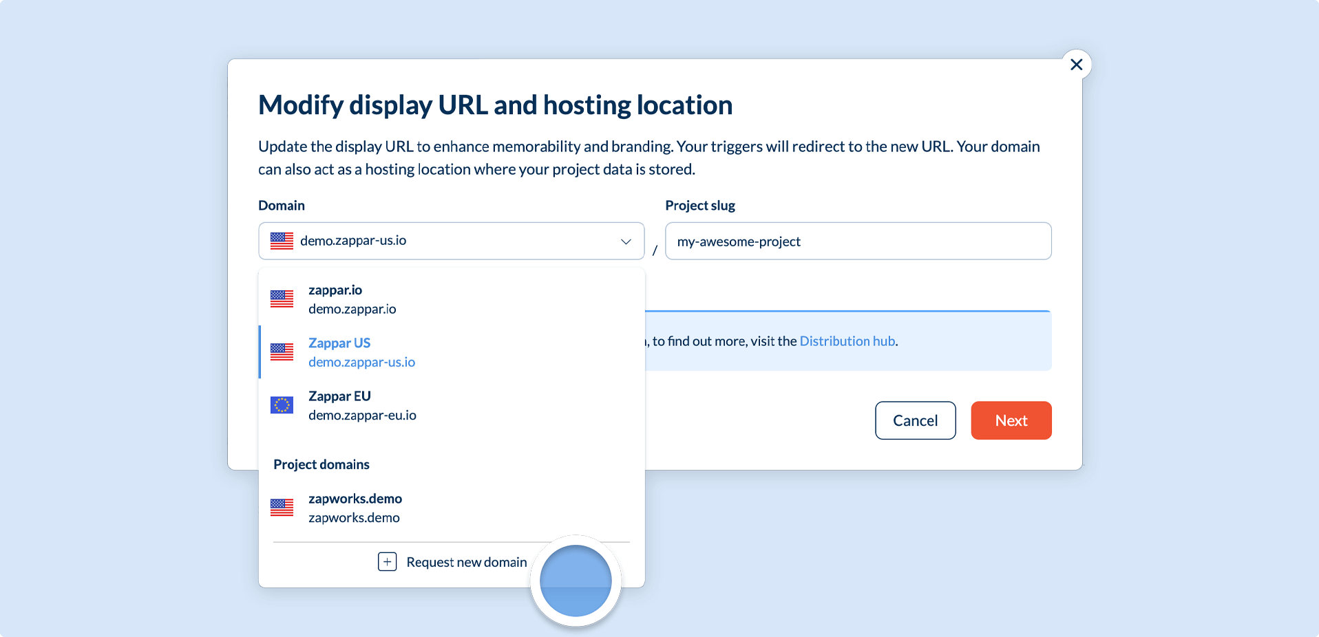

To set a new project default display URL, first click on your project from your Workspace Dashboard to enter the Project Page.
From here, you can go to the Publishing settings panel to the right of the screen and click on the project’s current display URL.

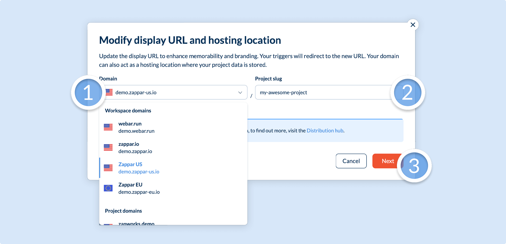

You will then see the Modify display URL and hosting location modal which will allow you to update the current display URL.
Some domains such as ‘http://zappar-us.io/’ will allow you to customize the project’s slug in the URL, while others such as http://zappar.io/ will use the project ID and the version name to compose the display URL.

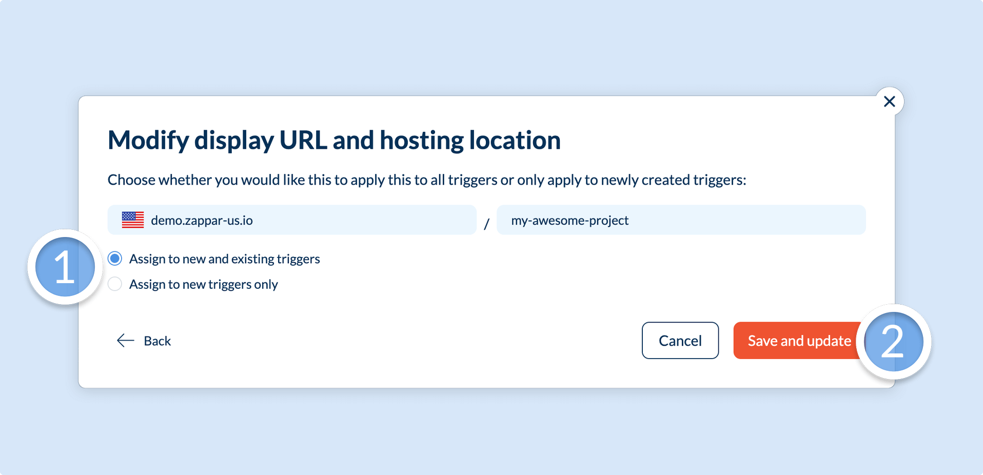

When you have selected the new default display URL that you would like to show to your users, click on the Next button in the modal to confirm whether you would like this change to affect both new and existing triggers, or, new triggers only.
When you click on Save and update, your triggers will begin to redirect to the new default display URL after a few seconds.

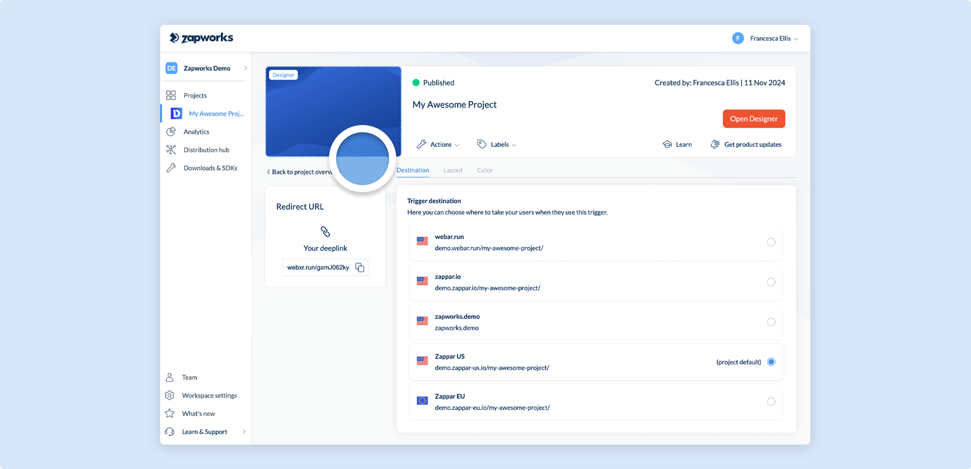

From time to time you may wish for individual triggers to be redirected to different display URLs; for example, to host your experience on servers which are in multiple target countries, or for legal and compliance reasons.

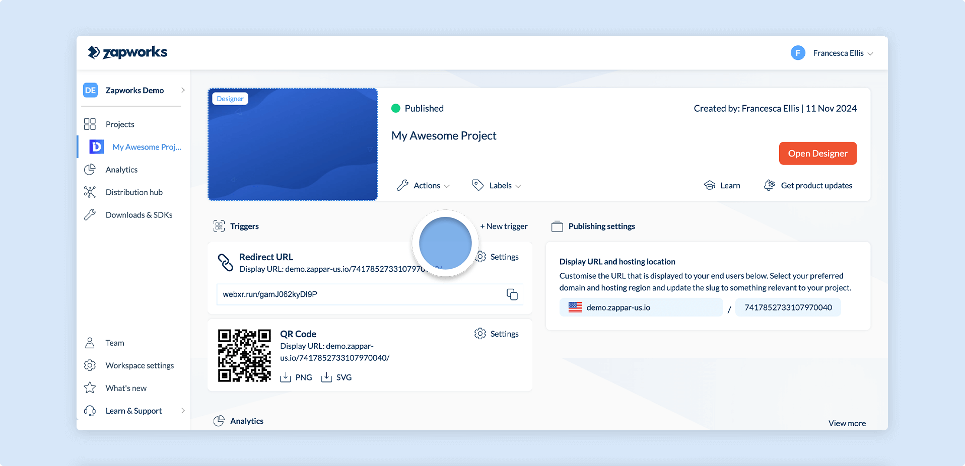

To set an individual trigger’s display URL, first click on the project you wish to customize from your Workspace Dashboard to enter the Project Page.
From here, you can go to the Triggers panel to the left of the page and find the trigger you wish to update the display URL for. Then, click on that trigger’s Settings, where you will be redirected to the Trigger Settings page.
Making sure that you are selected on the Destination tab, click on the display URL which you would like this trigger to redirect to.
When you click on a Trigger destination, your trigger will begin to redirect to the new default display URL after a few seconds.

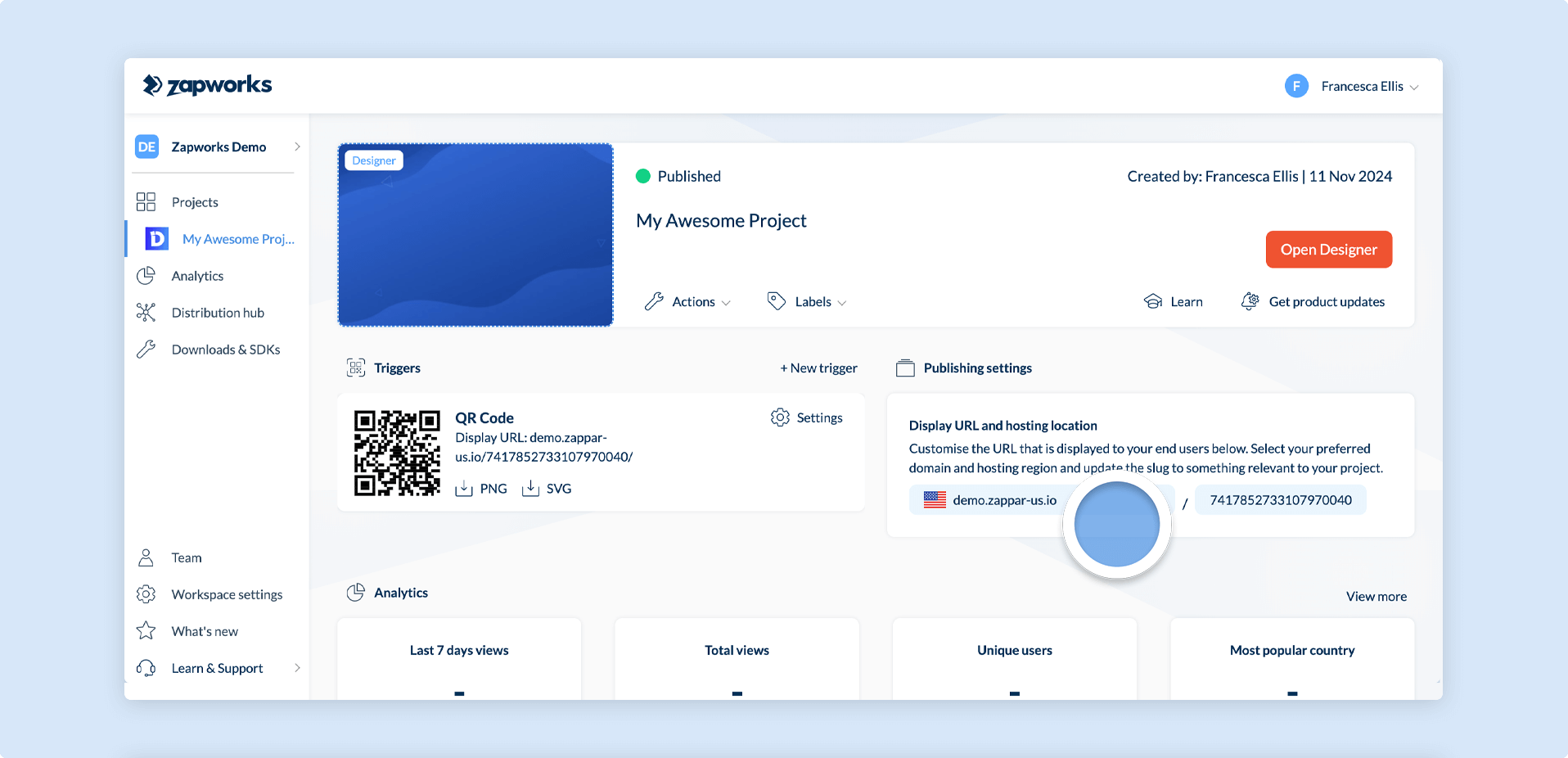

To create a new Zappar hosted custom WebAR domain, first click on your project from your Workspace Dashboard to enter the Project Page.
You will then see the Modify display URL and hosting location modal which will allow you to update the current display URL and request a new domain.

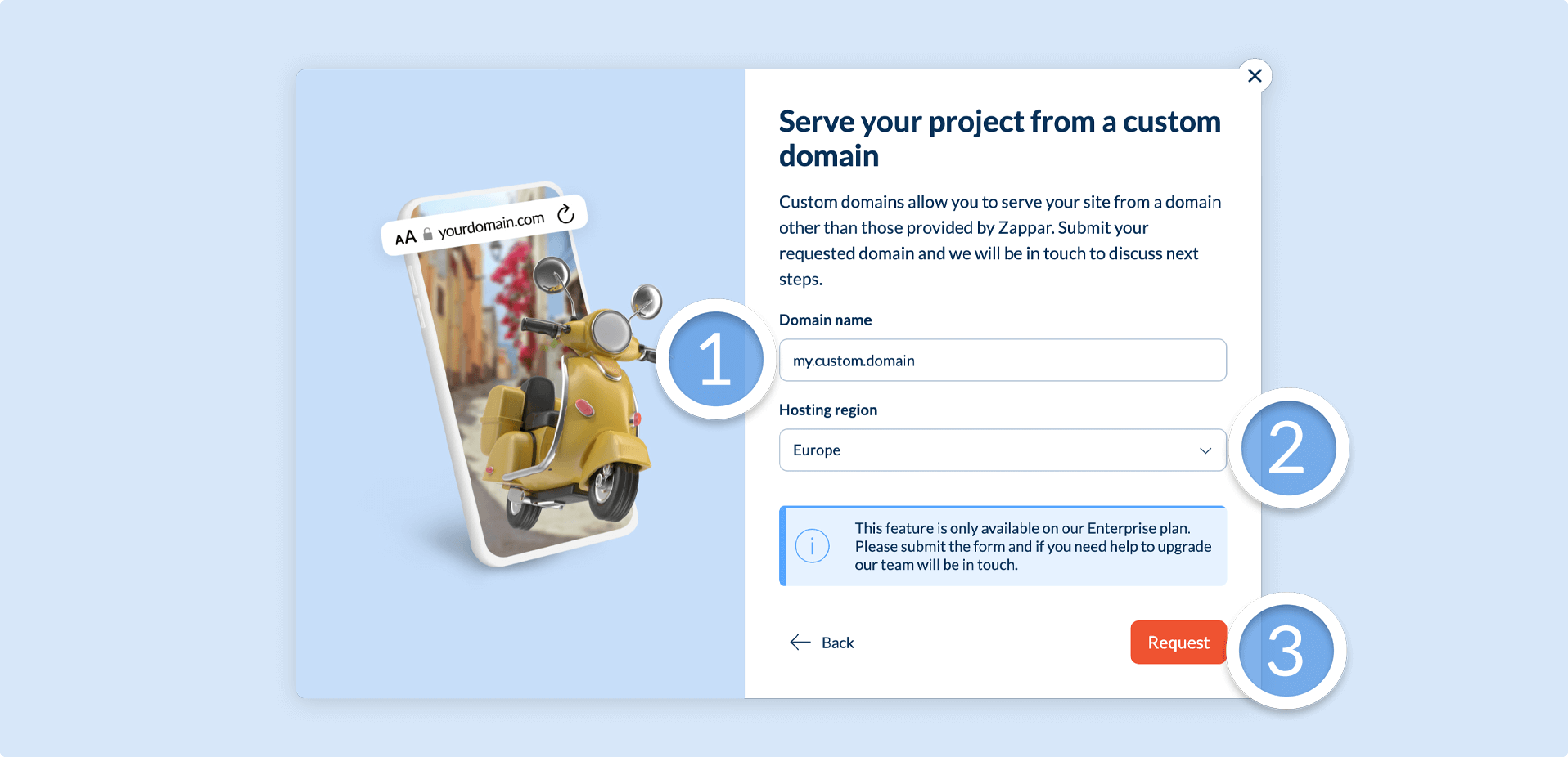

To request a new Zappar hosted custom WebAR domain, click on the Request a new domain option in the dropdown to open the domain request modal and follow the instructions to request a host name and hosting region.
When you have completed the form, click on the Request button to submit your requested domain and the Zappar team will be in touch to discuss the next steps with you.
