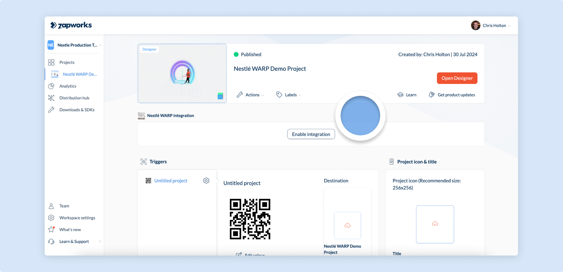

The Zapworks integration to Nestlé WARP is enabled per-workspace. In order to confirm whether the WARP integration has been enabled on your workspace, create a project and if it is available, you will see this clearly labelled UI component on the project overview page.
If the integration does not appear to be available, please contact support@zappar.com who will be able to investigate.

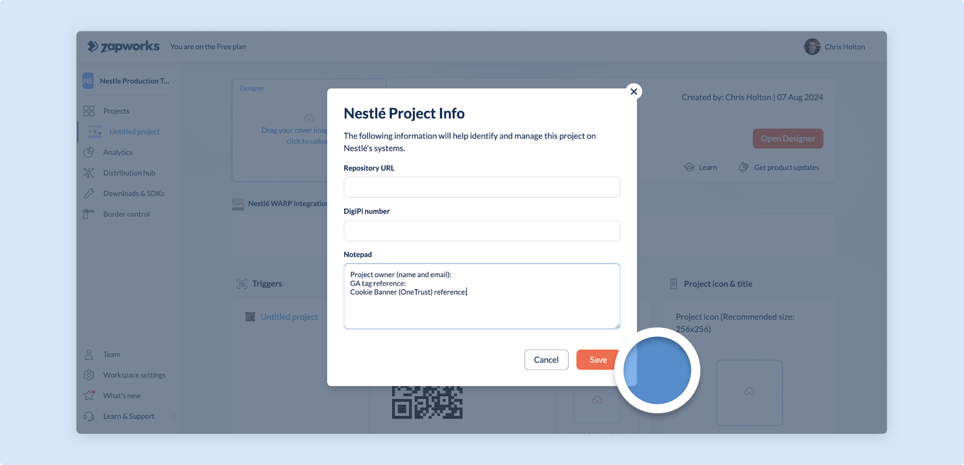

On enabling the Nestlé integration, you will be prompted with a modal that allows you to store (for easy access) the following important information relevant to the Nestle WARP publishing process:
Field Description
Repository URL Project repository location
DigiPi number Project identification number
Notepad Free text field with pre-populated entries:
Project owner (name and email),
GA tag reference,
Cookie Banner (OneTrust) reference

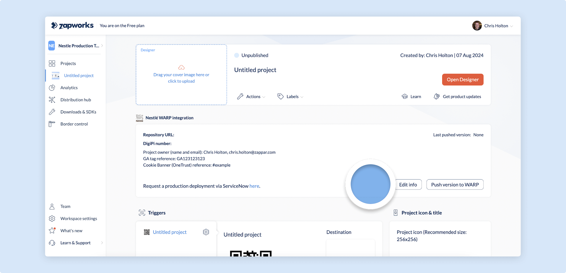

This data is then saved on the project overview page. Note that you can use the markdown format bold (**bold**) if desired to distinguish between titles and fields.
If you do not have all the information at the start of the project, these fields can be updated at any time by clicking on the Edit info button (shown in the graphic below).

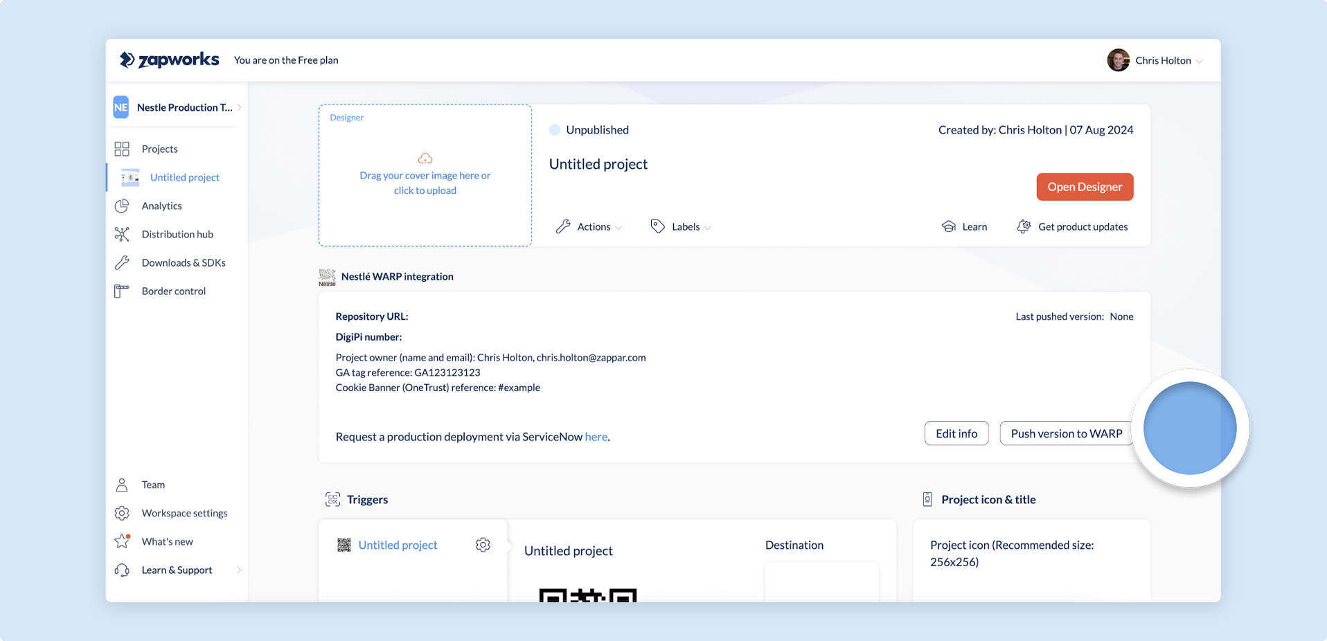

Once you have published the project in the Zapworks platform at least once, you will be able to push those published files, a project version, to Nestlé WARP.

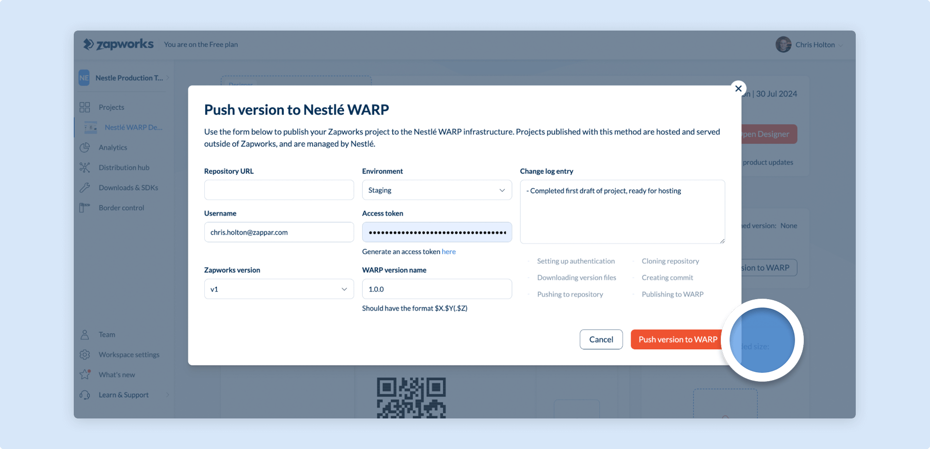

Your published version is now ready to push to Nestlé WARP. Click the button on the project overview page to prompt the modal.
The following fields are required:
Field Notes
Repository URL This is pre-filled if inputted earlier.
Environment Either Staging or Production.
Username Discoverable from WARP.
Access token Discoverable from WARP.
Zapworks version Dropdown of all published versions.
WARP version name Written in the$X.$Y(.$Z) format, for example 1.0.0.
Change log entry A description of changes made since the last publish.
Once completed, click Push version to WARP. If successful, you should see the project files in the WARP repository, along with the changelog. You will receive an email from MSEToolchainService@es.nestle.com with the build status once complete.
Your access token from WARP can only be viewed once, will not be stored in Zapworks and is required each push to Nestlé WARP. We strongly recommend saving this in your preferred password manager.
