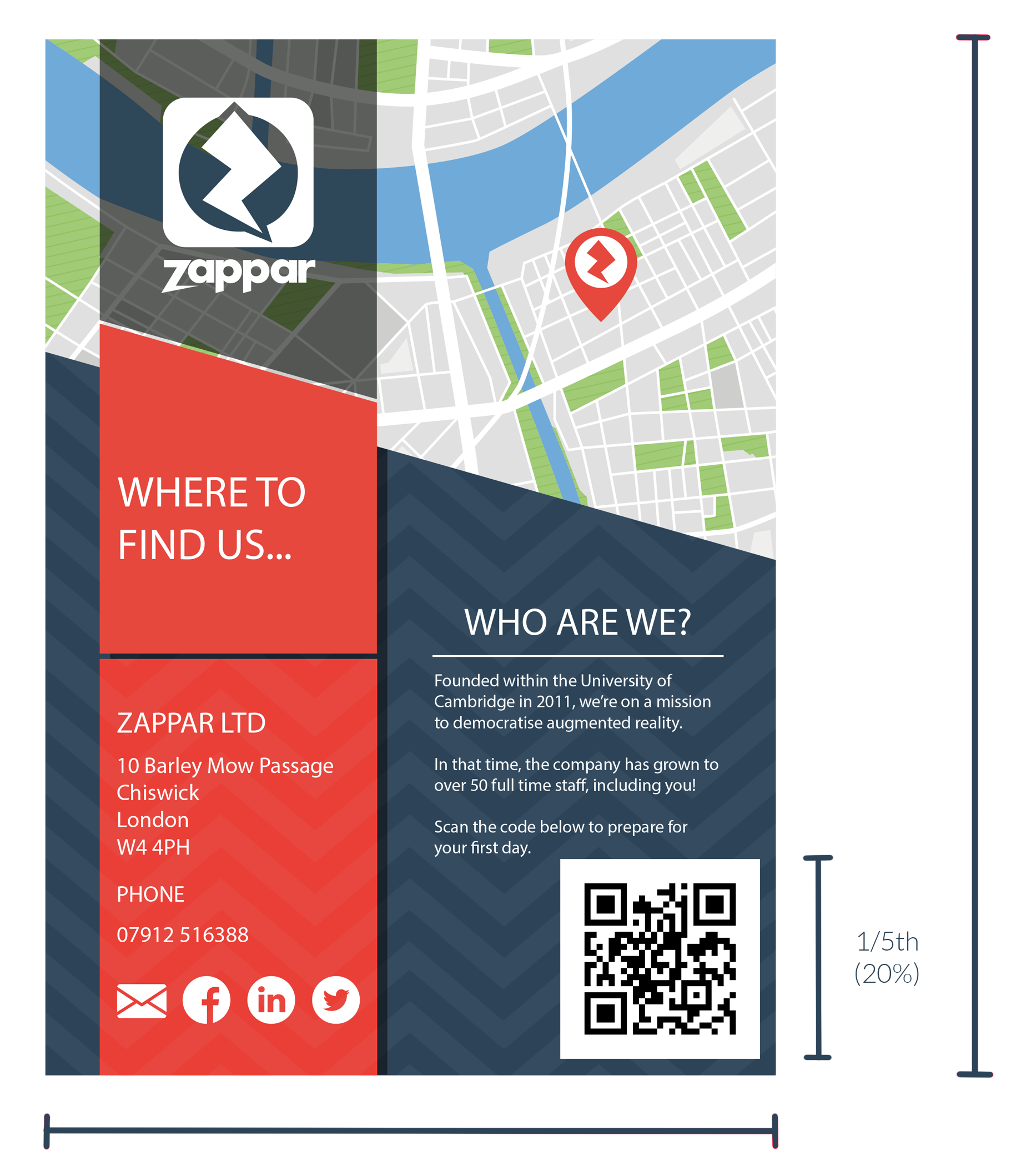

  • At a minimum, QR codes must be 10mm wide.
  • We recommend your code is at least 12mm to increase the likelihood of successful recognition by a wide range of devices and QR code scanners.
  • We recommend that a QR code be 20% of the largest value of its target image’s dimensions eg. considering a 200mm by 300mm image, the QR code should be 20% of the 30cm value, therefore 60mm wide.
  • The scanning distance to code size ratio is 10:1 eg. if a user is scanning a QR code from a distance of 10 meters, the QR code would need to be 1 meter wide.

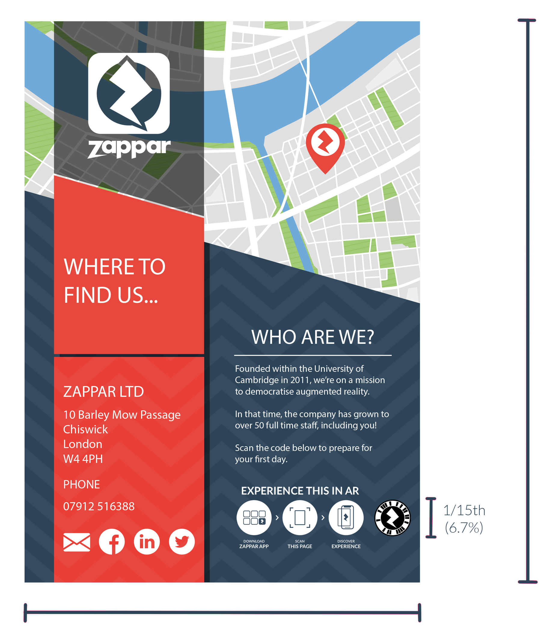

  • We recommend that a zapcode’s diameter be 7% of the largest value of its target image’s dimensions eg. considering a 200mm by 300mm image, the QR code should be ~7% of the 30cm value, therefore 21mm wide.
  • The scanning distance to code size ratio is 30:1 eg. if a user is scanning a zapcode from a distance of 10 meters, the zapcode would need to be 0.33 meters wide.
