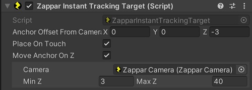

Instant Tracking Target Properties
Section titled “Instant Tracking Target Properties”![]()
| Property | Description |
AnchorOffsetFromCamera |
The Zappar Instant Tracking Target GameObject will keep the content in front of the camera using the AnchorOffsetFromCamera value until the user set the flag for UserHasPlace. AnchorOffsetFromCamera will offset the anchor position from the camera position based on the values set. |
PlaceOnTouch |
By default, the Zappar Instant Tracking Target behaviour is mapped to user tap event (PlaceOnTouch) and this property set to true. This is optional, you can instead set the value to false call ZapparInstantTracker.PlaceTrackerAnchor to override and customize this behaviour. |
MoveAnchorOnZ |
Move the anchor along the z-direction before it’s placement, which allows to move the target along the forward facing direction of camera. The min/max Z defines how near/far away the anchor can move from camera. Note: it’s only pre-placement option. |
