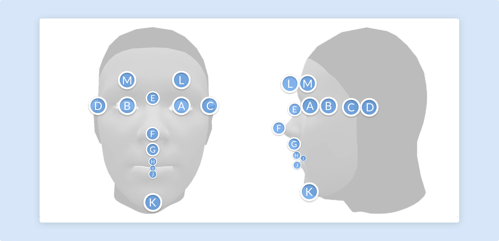

Section titled “Face Landmarks”In addition to tracking the center of the head, you can use a FaceLandmark to track content from various points on the user’s face. These landmarks will remain accurate, even as the user’s expression changes.
To track a landmark, construct a new FaceLandmark component, passing the name of the landmark you’d like to track as props:
export default function App() { return ( <ZapparCanvas> <ZapparCamera /> <FaceTracker /> <FaceLandmark target="nose-bridge" > {/*PLACE CONTENT TO APPEAR ON THE NOSE BRIDGE HERE*/} </FaceLandmark> <directionalLight position={[2.5, 8, 5]} intensity={1.5} /> </ZapparCanvas> );}The following landmarks are available:
| Face Landmark | Diagram ID |
| eye-left | A |
| eye-right | B |
| ear-left | C |
| ear-right | D |
| nose-bridge | E |
| nose-tip | F |
| nose-base | G |
| lip-top | H |
| mouth-center | I |
| lip-bottom | J |
| chin | K |
| eyebrow-left | L |
| eyebrow-right | M |
Note that ‘left’ and ‘right’ here are from the user’s perspective.
