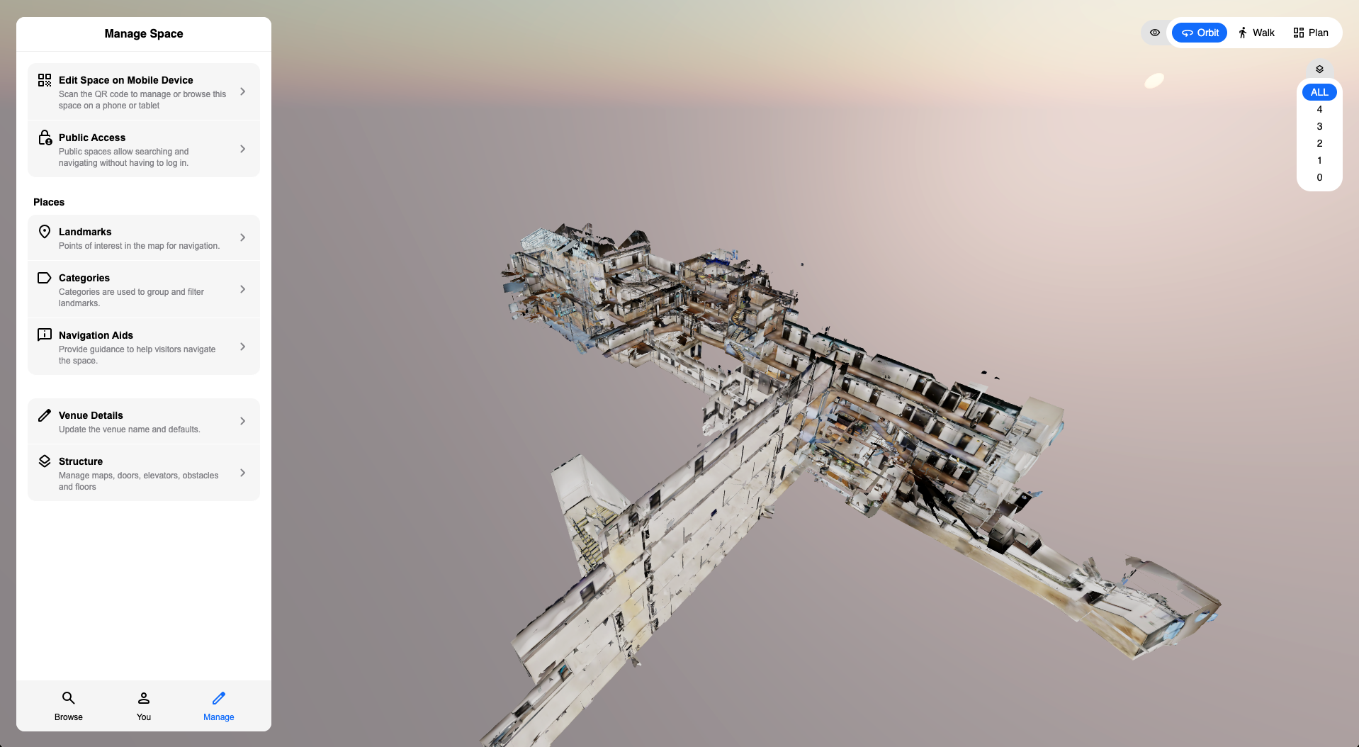

  4. Once the details are confirmed, your 3D map will load in the centre of the editor. The main navigation and editing tools are available in the panel on the left.
After setup, you will see your 3D map mesh in the editor viewport.
From here you can:
  • Add and manage landmarks - the destinations users can navigate to.
  • Configure structure - define walkable areas, place doors, and mark obstacles.
  • Add navigation aids - set up crossings to provide contextual announcements along routes.
  • Publish your Space and manage access.

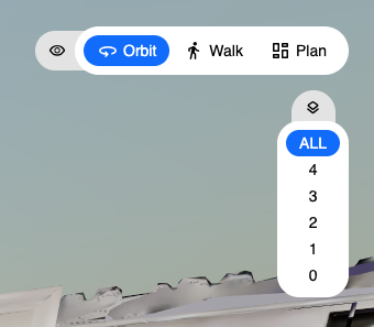

The editor has three viewport modes, selectable from the top-right corner.
Mode Description
Orbit Freely move around the 3D map. Right-click to pan, left-click to rotate, and scroll to zoom.
Walk Enter the map at ground level, as if physically present in the space. Click the foot indicators on the floor to move to that position. This is the easiest way to get a feel for the space and place landmarks accurately.
Plan A top-down bird’s-eye view of the map.
Clicking directly on the floor of the map will switch you into Walk mode automatically.
Below the viewport mode controls, a floor selector lets you navigate multi-floor environments. Click a floor number to jump to that level, or select All to see every floor at once.
