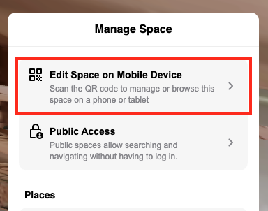

  1. Open your Space in the desktop editor at my.zap.works.
  2. Select Edit Space on Mobile Device from the left-hand panel.
  3. A QR code will be displayed - scan it with your mobile device.
