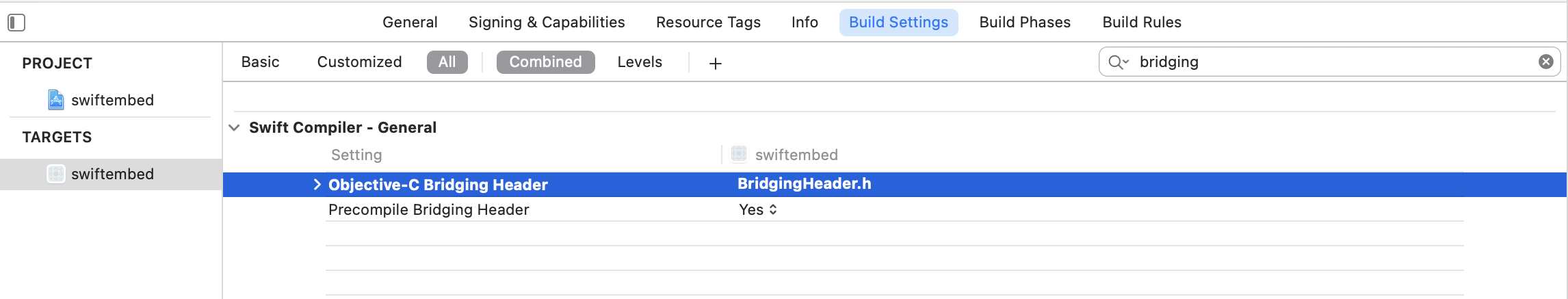

Because the Zappar framework uses Objective-C functions, you need to specify a bridging header; this header links your Swift project to the rest of the Zappar project as follows (for example, we’ve used BridgingHeader.h for the “SwiftEmbed” project).
#import <ZapparEmbed/ZapparEmbed.h>
#import "TargetConditionals.h"
You need to specify this bridging header in the project settings as follows:
Project -> Build Settings -> Swift Compiler -General -> Objective-C Bridging Header
