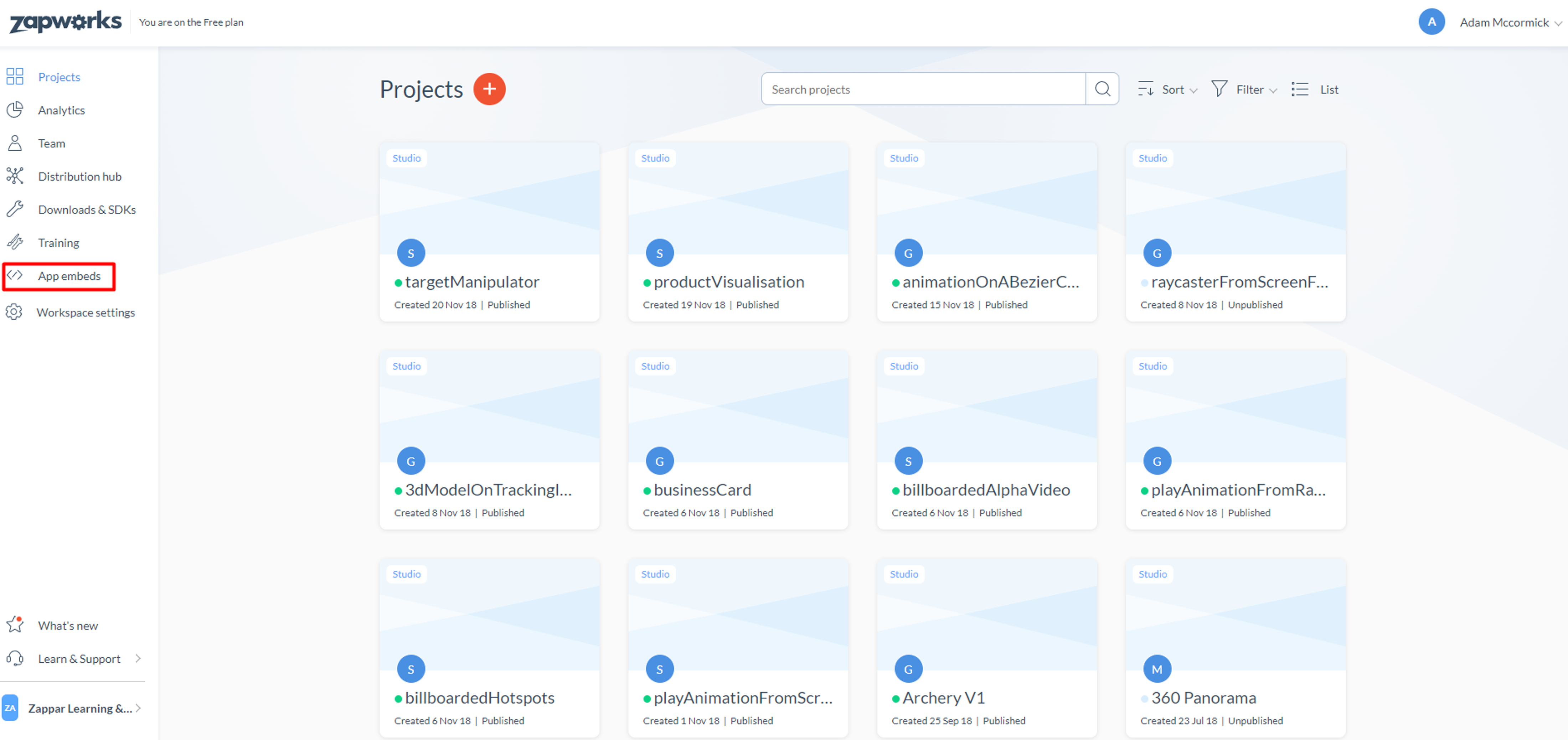

From your ZapWorks page, open the settings dropdown and select App Embed. On the next page, select New app, give it a name, and click Next.
The App Embed option is only displayed if you’ve been given access to our SDK. Please contact support@zappar.com if you’d like to request access.

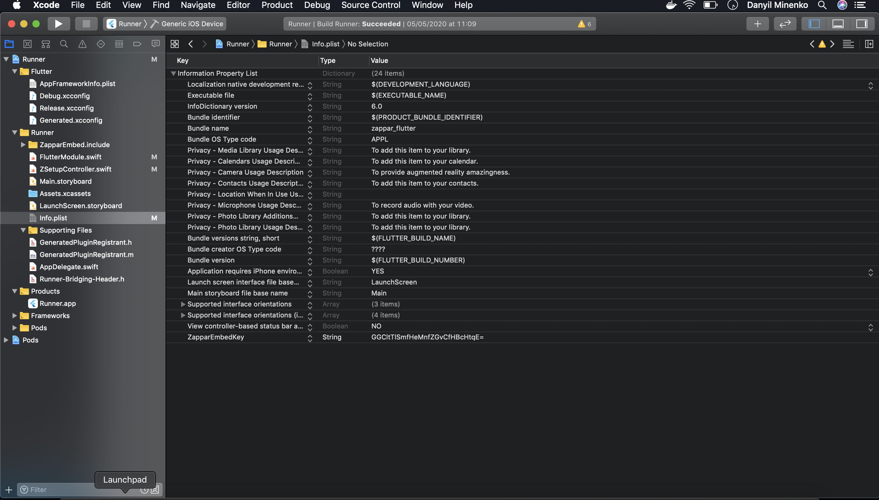

  1. Add the following entries to your Info.plist file:
Permission Description
Privacy - Camera Usage A string of your choice e.g. Allow camera access for augmented reality amazingness.
Privacy - Calendar Usage A string of your choice e.g. Allow calendar entries to be saved.
Privacy - Contacts Usage A string of your choice e.g. Allow contact entries to be saved.
Privacy - Microphone Usage A string of your choice e.g. Allow sound to be recorded when using the video record feature.
Privacy - Photo Library Usage A string of your choice e.g. Allow snapshots to be saved to your camera roll.
Privacy - Photo Library Additions A string of your choice e.g. Allow snapshots to be saved to your camera roll.
The above entries are essential to ensure the correct behavior of the embed component at runtime; if they are not set the app may crash due to missing permissions.

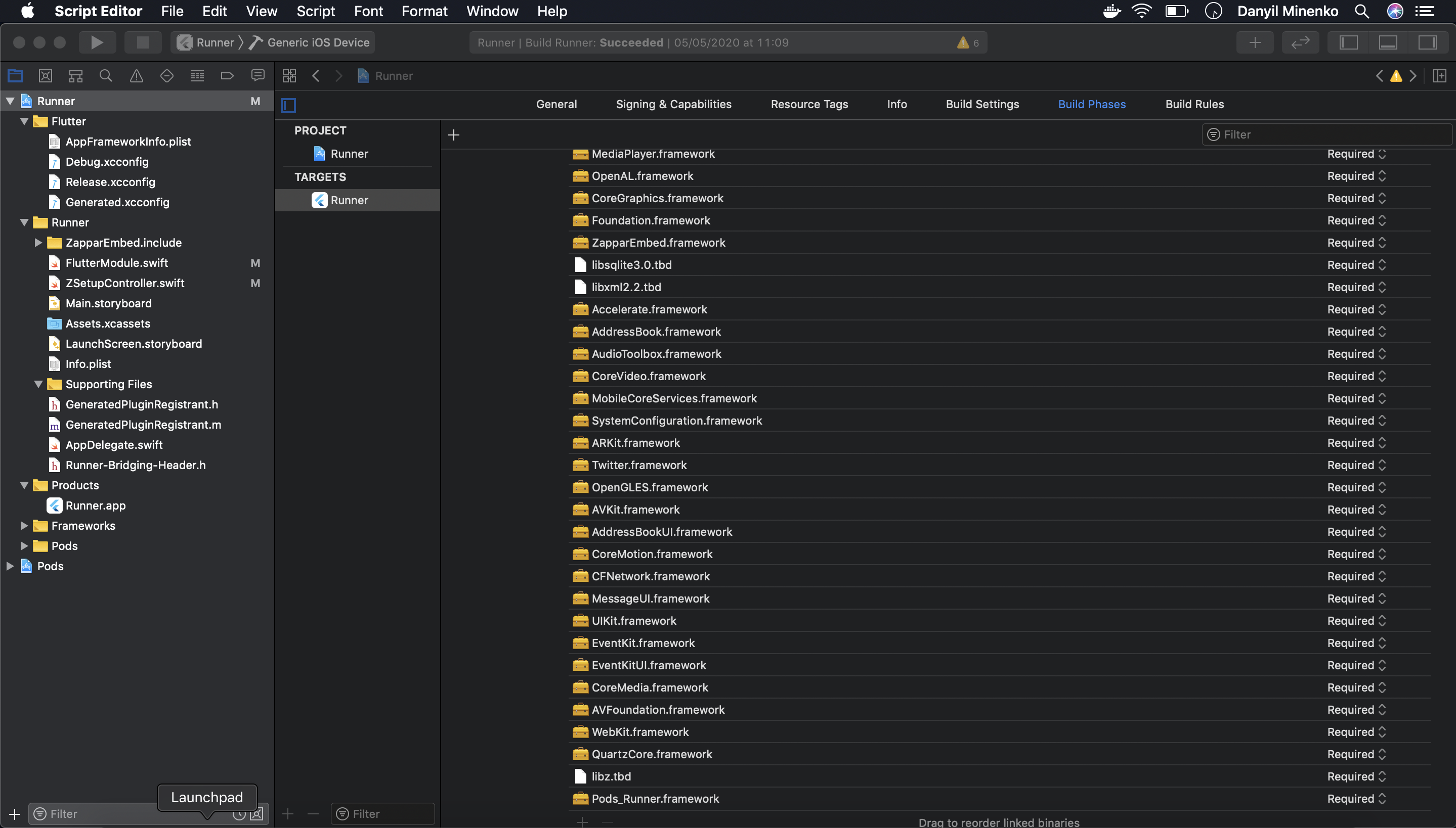

  1. Add dependent frameworks to the project. Select the Target, then navigate to Build Phases > Link Binary With Libraries and add the following:
If the project build fails to automatically link to Zappar’s required standard system frameworks please refer to the Troubleshooting Guide.

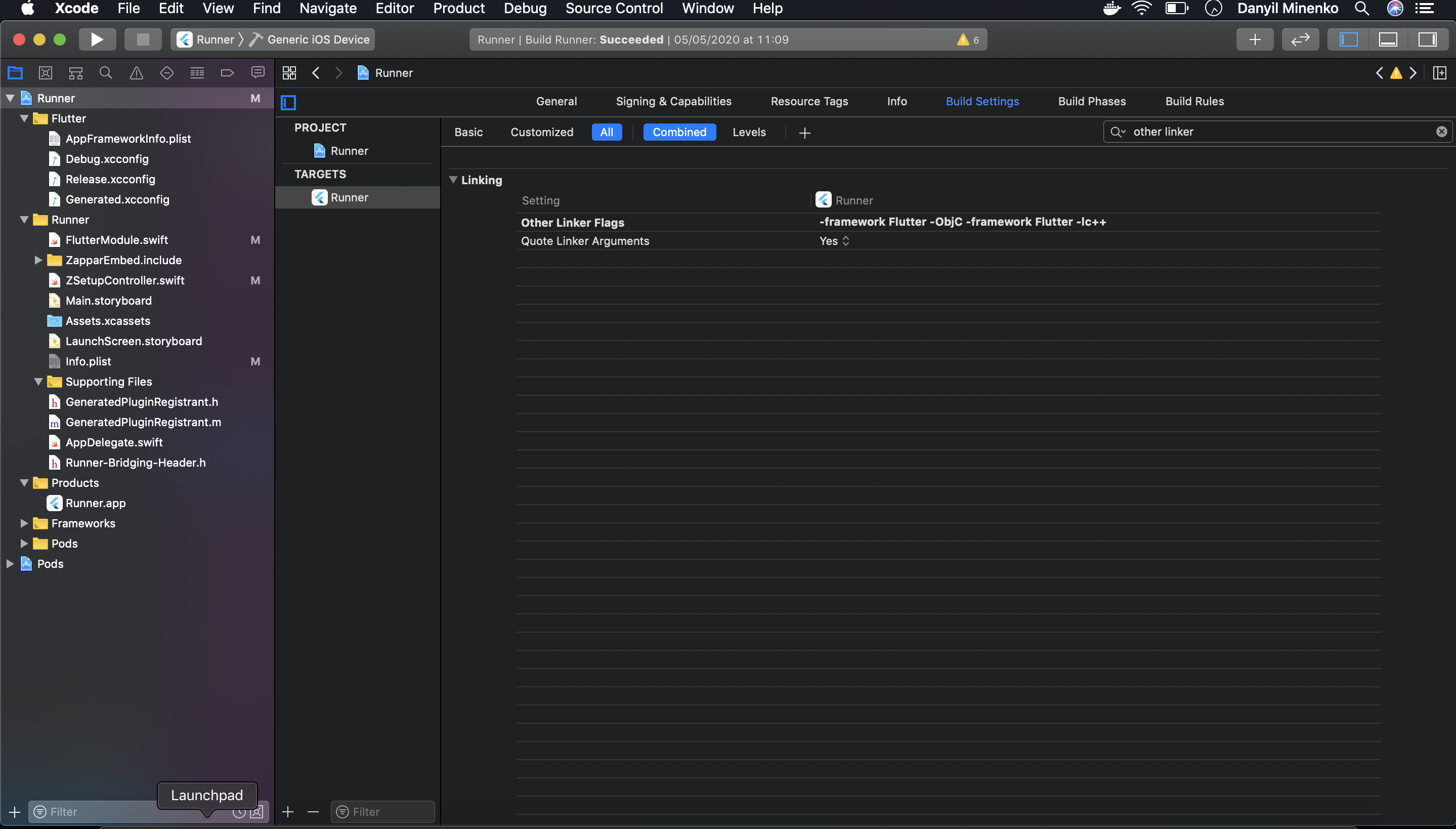

  1. Set the ObjC flag. Within the Other Linker Flags settings, add -ObjC to ensure the app accesses the framework library functions safely, and add -lc++ below the flag.
